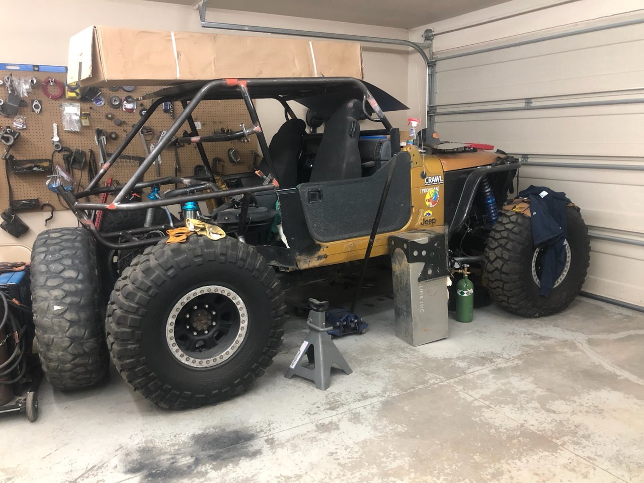

    My front axle is a custom Solid Industries with a 10 ton truss (went way overboard). Rear is a GM AAM axles out of a 2005 GM 2500 gasoline truck.
    If I were to build another off-road rig again:
    LS
    atlas 3.8 (have 4.3)
    fabricated 9/10
    Then again, my stuff just sits anymore. Probably should sell it and get a CTS-V (or maybe a Z06) and have fun track days again. Then look for an imported LC70.
    I just need to paint and toss on the skins, test out my revalve on the kings. Just haven’t had time.

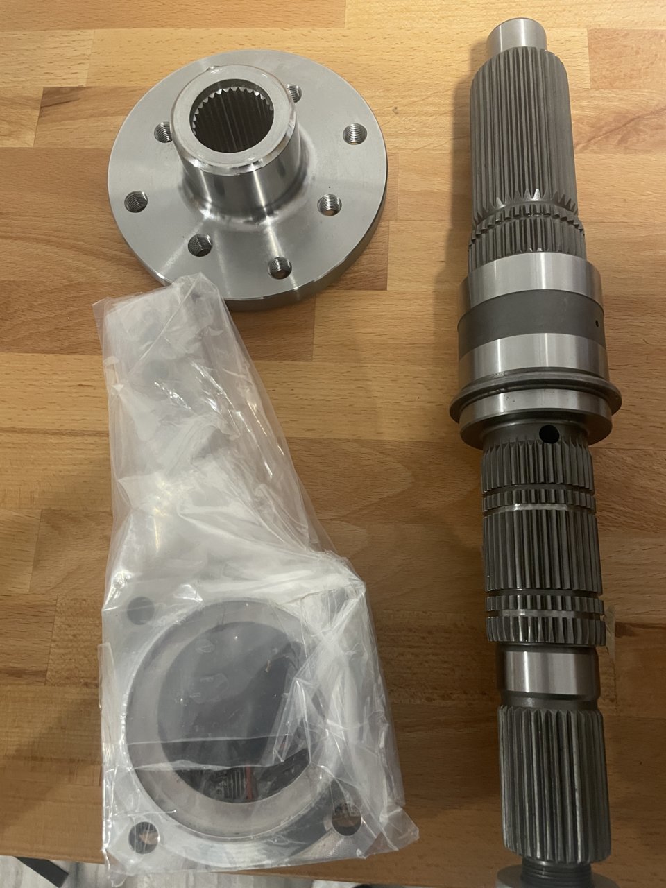

    Offroad Designs SYE arrived today. I wasn’t expecting it to be heavy as it is.

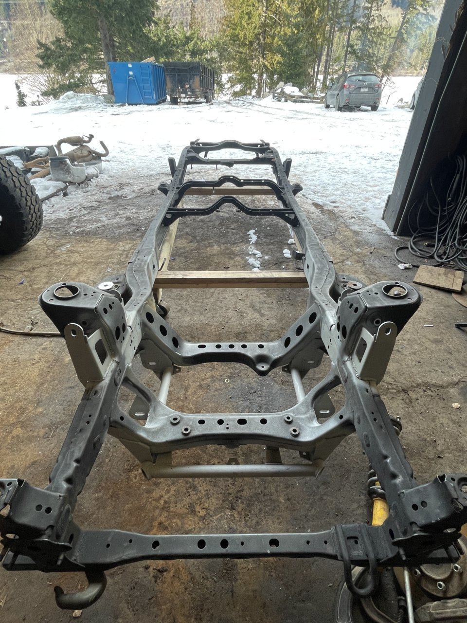

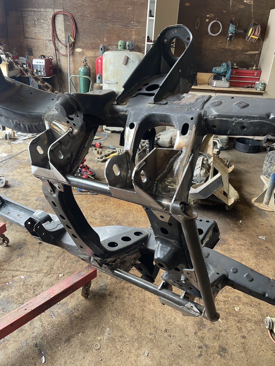

    After a bit of a hiatus, I'm back working on the build. The first item to be ticked off was the pivot kit install which was my first time welding which turned out alright.
    Then cut all the non-essential mounts - engine/ transmission/ rear leaf mounts off. I ran out of gas so all that's left now is to tack the SUA perches on and then I'm ready for the cab to go back on.
