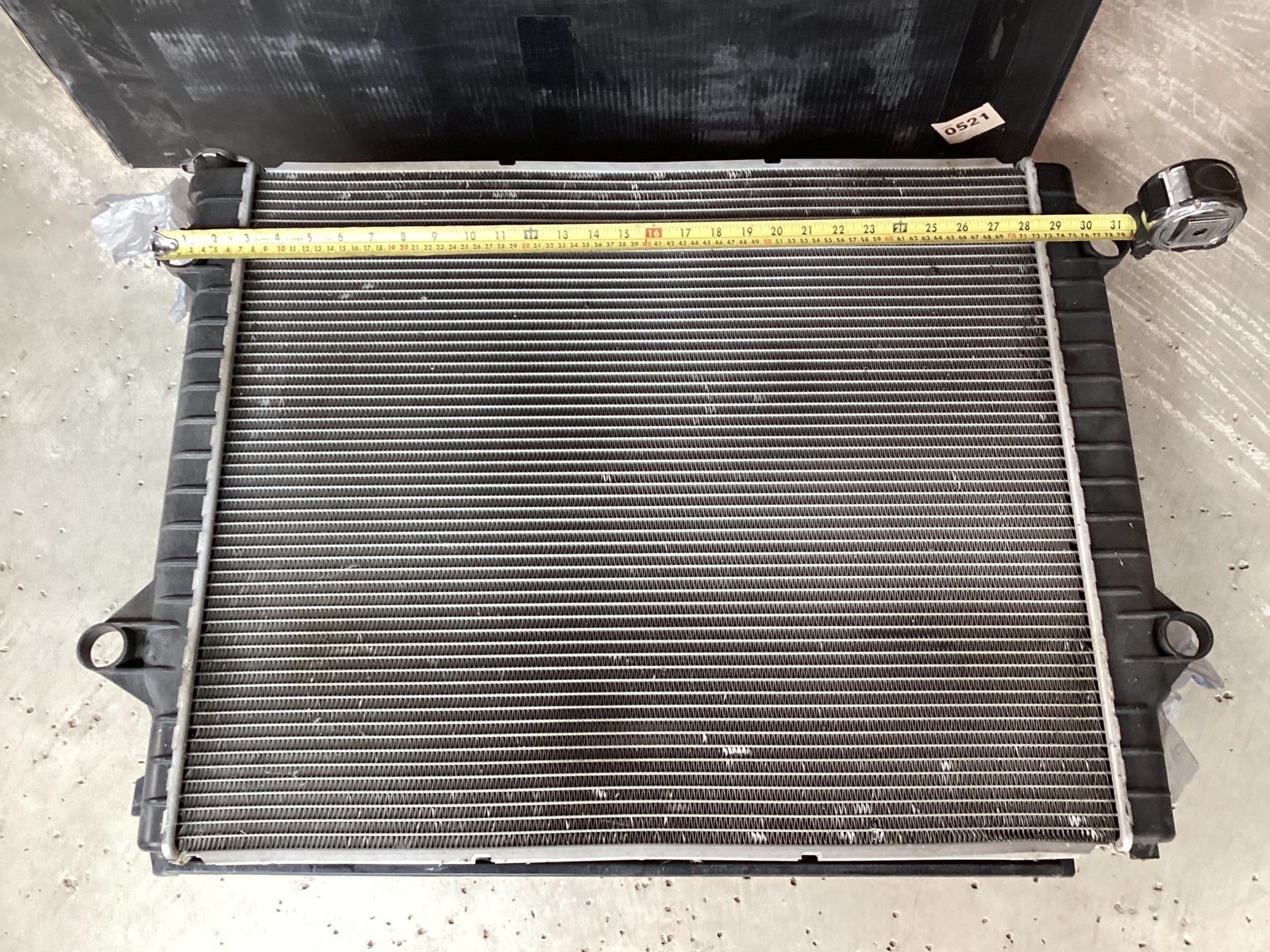

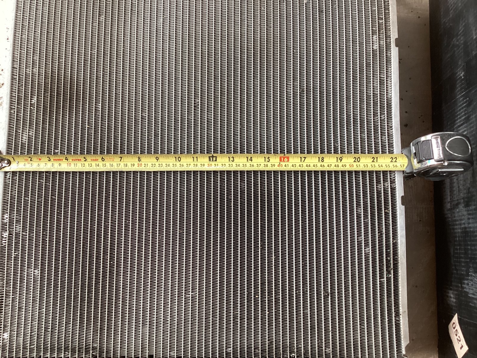

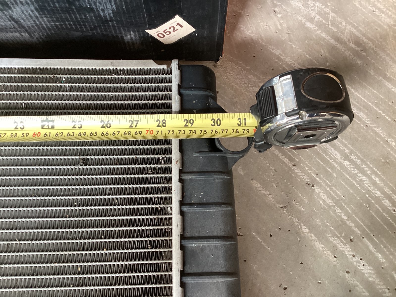

  13. Feb 26, 2024 at 9:00 AM
    #153
    hayrider2.0
    hayrider2.0 Over the hill and going down fast!
    Jun 30, 2023
    #427944
    400
    Hey You
    2 Centimeters from Hell 200 Miles from Water
    05 & 07 White Reg. Cabs w/ sticks
    05 Magnuson 07 LS Swapped
    Yeah those cute furry things can take up a lot of time!

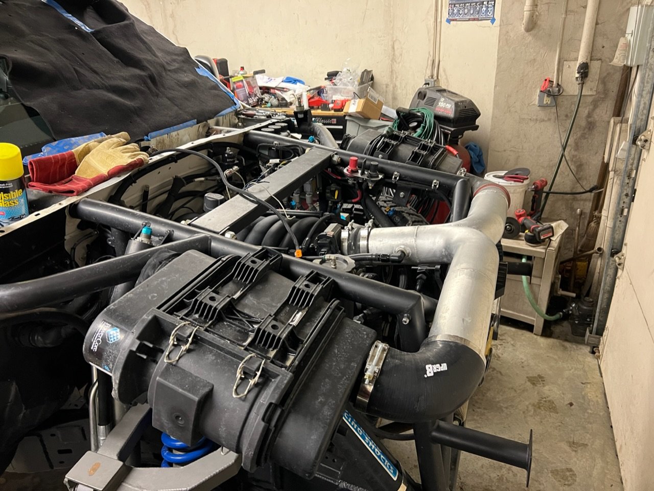

    Ok Chris, fess up about the air cleaner/s
    I don’t have the truck here now but here’s the OEM radiator.
    I see the radiator is a dual flow radiator too. Nice‼️

    Dual Donaldson pcd filters, they didn’t fit until I went to a one piece front end.

    @hayrider2.0 thanks for those dimensions!

    @Camazon as long as it fits between the headlights and doesn't hang too low, we can make it fit since you're building your own core support anyway

    unless its to tall than its gotta fit inside the frame rails.

    This was my concern that it would either be right up against the headlights or hanging out down below.
