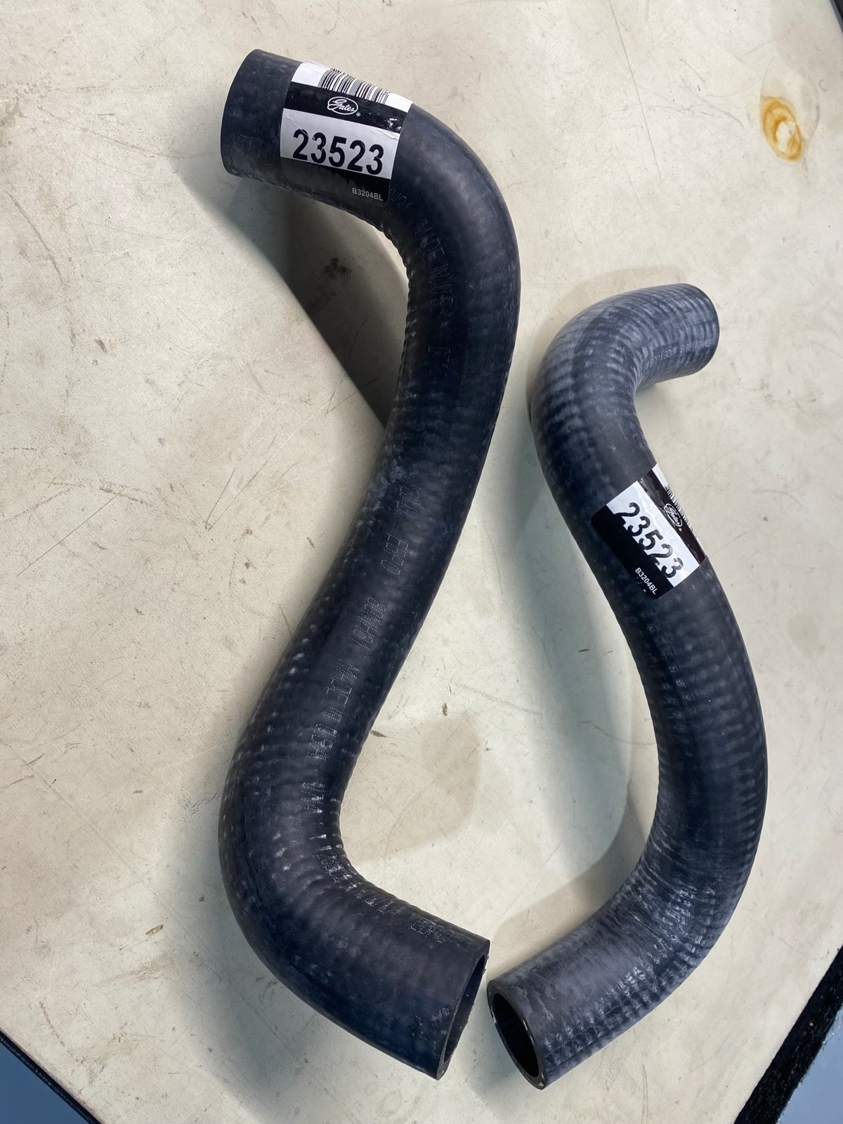

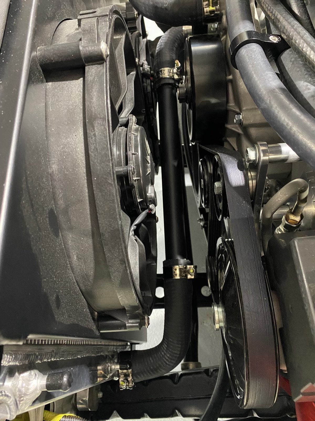

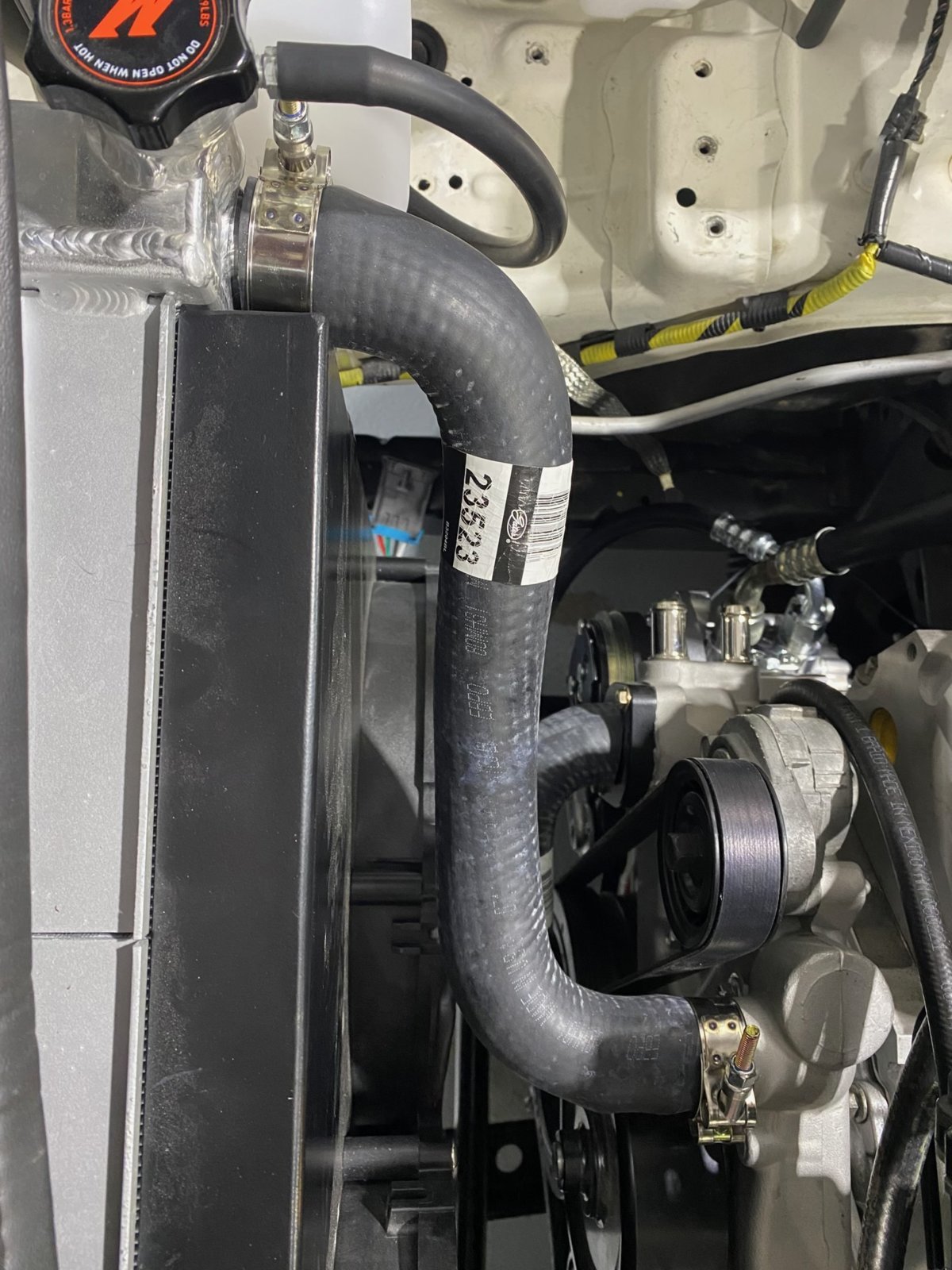

    I used the drop in Mishimoto radiator. Used two Gates hoses for LS7 if my memory serves me correctly. The radiator hose/s the top mounted right up the bottom was cut in half and added about 16” of pipe.

    Are you worried about the pipe pitting or getting oxidation?

    No the guy who installed the LS wanted everything to match in color (Black) so I paid about 4 times what it would have cost me here in the Phoenix area for powder coating plus I like the “Brushed Aluminum” look better, every part I purchase I looked for it in silver he would return it to get it in black. F**k it’s my truck!!

    Very similar routing to what I did. Except the lower rad hose I had to drop down to clear the fan where as it looks like you could go straight across the engine.

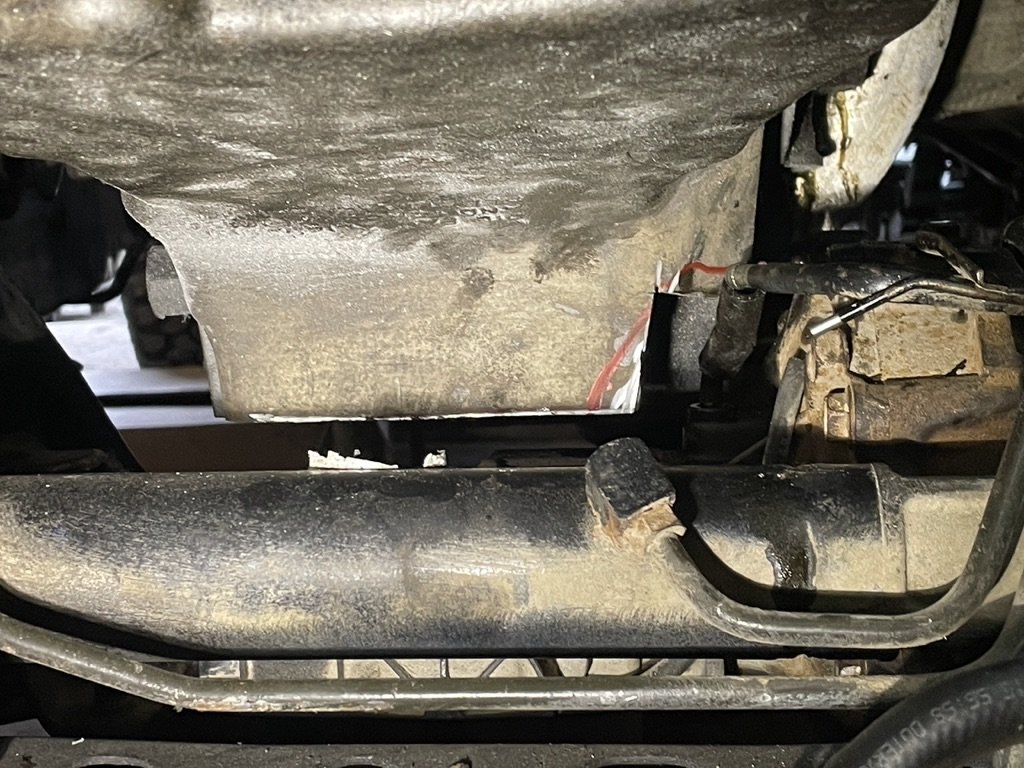

    What did you end up doing for the oil pan? Have any pictures of it in the truck with relation to the diff?

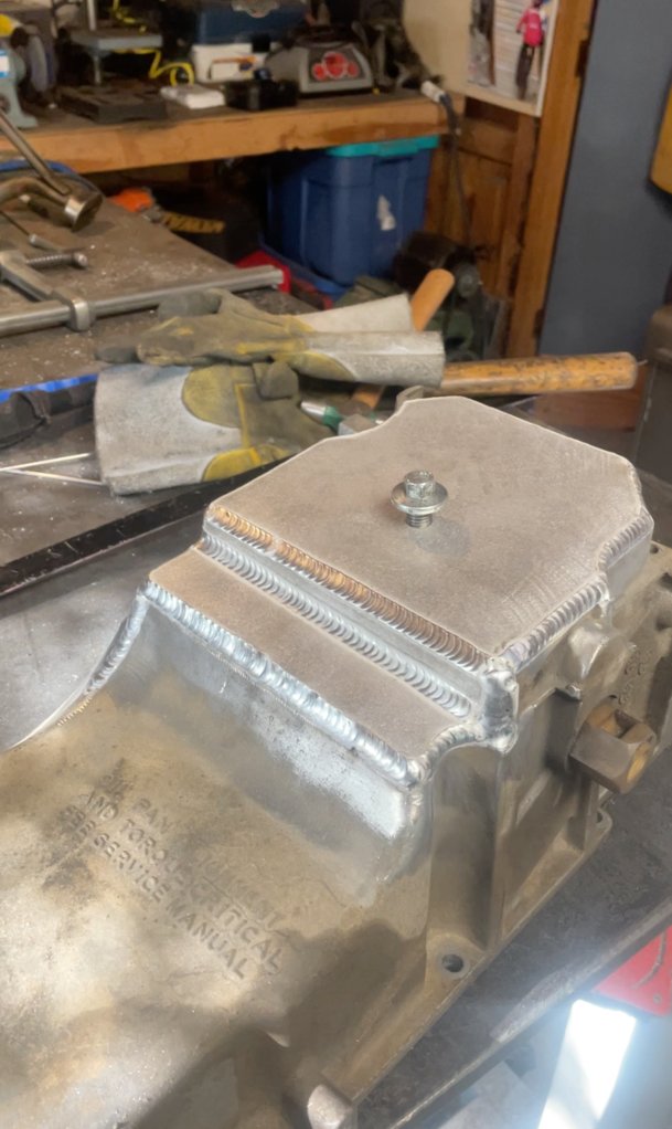

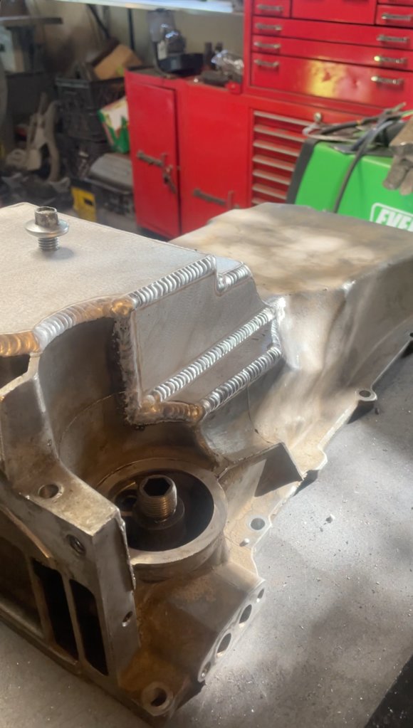

    So I cut quite a bit out of the stock truck oil pan, mostly because I had dropped the engine so low into the engine bay. The bottom of the pan sits about 1/2" off the factory cross member. 05C8F35E-66A9-4A55-B981-0624C1C59A9D_1_105_c.jpg DFE3F2F7-BEDE-4B05-A7E4-BA651CA46DA3_1_105_c.jpg 5F204607-2D26-4E53-ADA4-1A04396CFF8E_1_105_c.jpg Screenshot 2024-11-24 at 10.37.29 PM.png Screenshot 2024-11-24 at 10.38.37 PM.png

    I dropped it low for centre of gravity, to best fit the bell housing on the 4l80E into the trans tunnel and to not have the drivetrain at some wonky angle. Had I not dropped it that low it would have minimized the cutting to the oil pan but would have caused other issues I'm sure. The oil pan x front diff is one of the big hurdles with this swap. I see it as unavoidable and it's part of the cost of putting a V8 into a Tacoma.

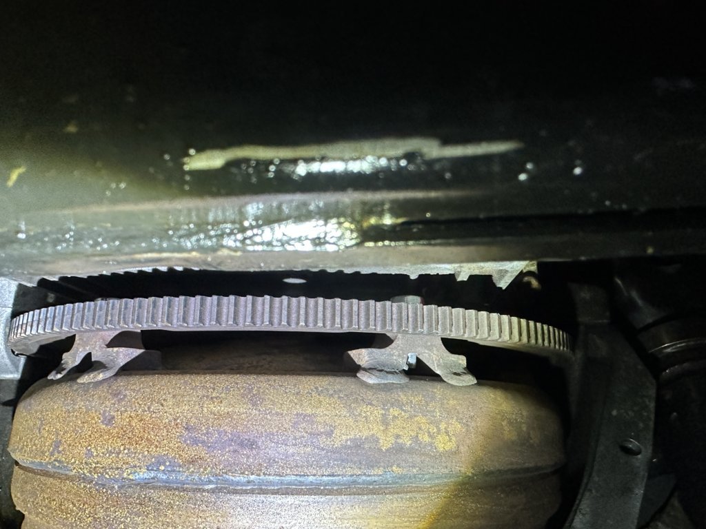

    I am using the 4l60e right now on a stock 5.3 lm7 but when I turbo in the future I will do a 4l80e swap to handle the power so I also need to make sure I have space for that too. When you measure, can you see how far forward your flex plate is from the rear of the support so I can get an idea of the placement of the engine forward and back?

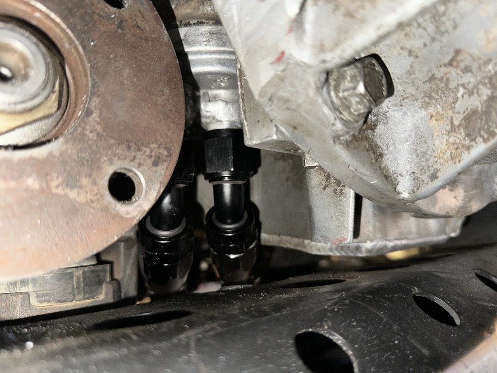

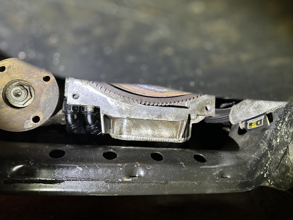

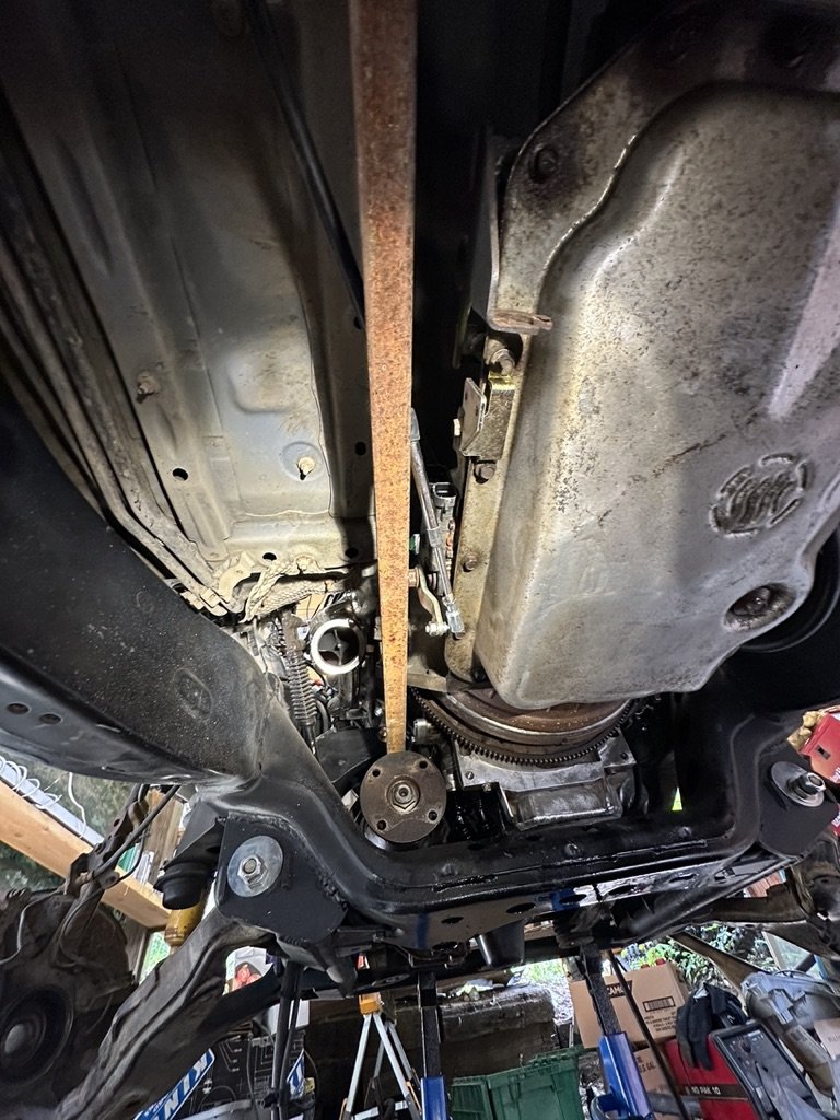

    In regards to the flexplate location. It sits approximately 2 1/2" above that rear cross-member at the moment ( this will go up as I lift the engine to clearance for a front driveshaft ). And if you were to plum a line up from the rear of that same rearward cross-member it sits 1/4" approximately forward of that line.
    Ignore the oil as that would appear to be the rear main just having a blast.
