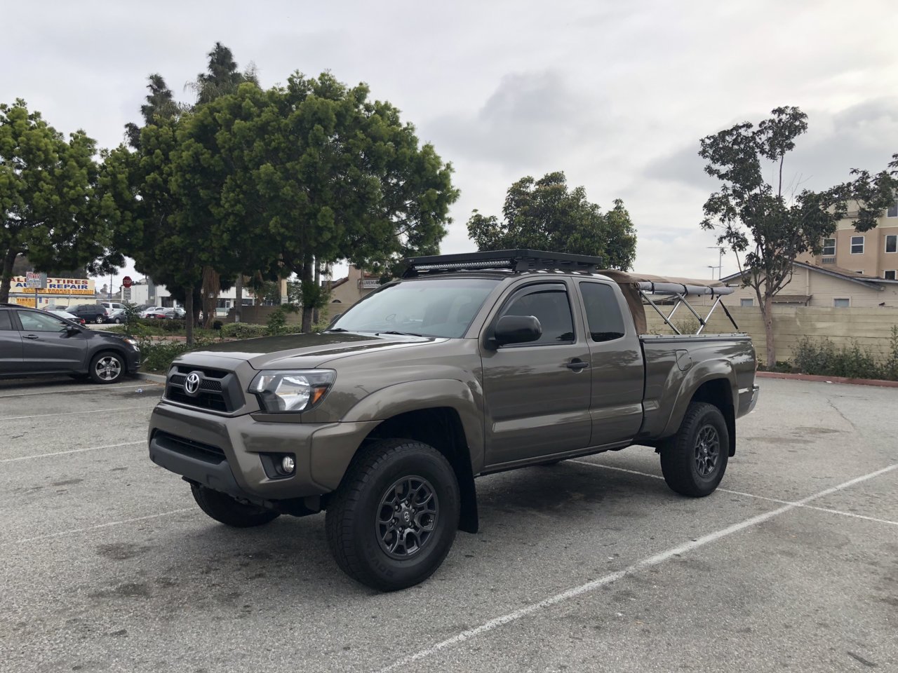

    Put 3rd gen TRD OR 16s on mine , I think they look great , and got them for cheaper than a new set of rubber would have been on those God awful 17" trd sport factorys , bought this truck and those wheels were gone in the first week

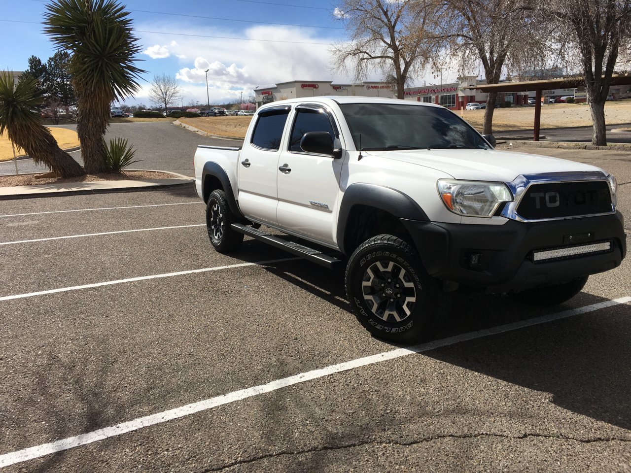

    2015 tacoma with 3rd gen wheels on mine love the look, going bigger tires later on

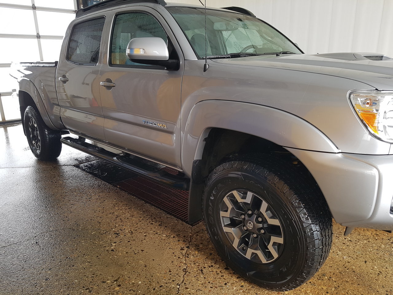

    I have 16" SR wheels with 265/75/16. Works well
