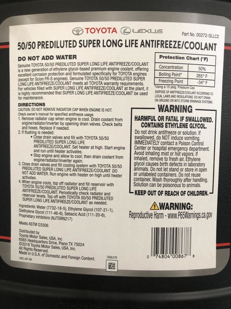

    I guess it’s worth mentioning,
    That 2 different things can meet the same standard, and one be “better” than the other.
    Which is better? I don’t know.
    I went Toyota SLLC, simply because I do drain and fills. I don’t want to mix coolant types.
    If I were to do a complete system drain, I’d feel fine using a different coolant as long as it meets or exceeds the OE standards.

    I got this from the 2014 manual
    Use either of the following.
    • “Toyota Super Long Life Coolant”
    • Similar high-quality ethylene glycol-based
    non-silicate, non-amine, non-nitrite, and non-borate coolant with long-life hybrid organic acid technology
    Do not use plain water alone.
