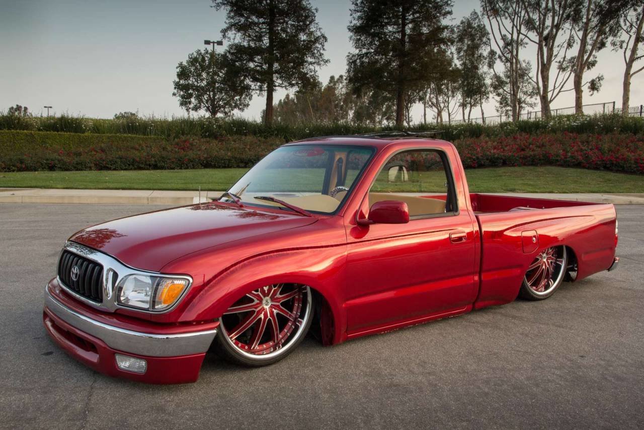

    A world where Tacoma's look like this.....

    I just spewed my coffee!

    I bet no one steels his cats though!?
