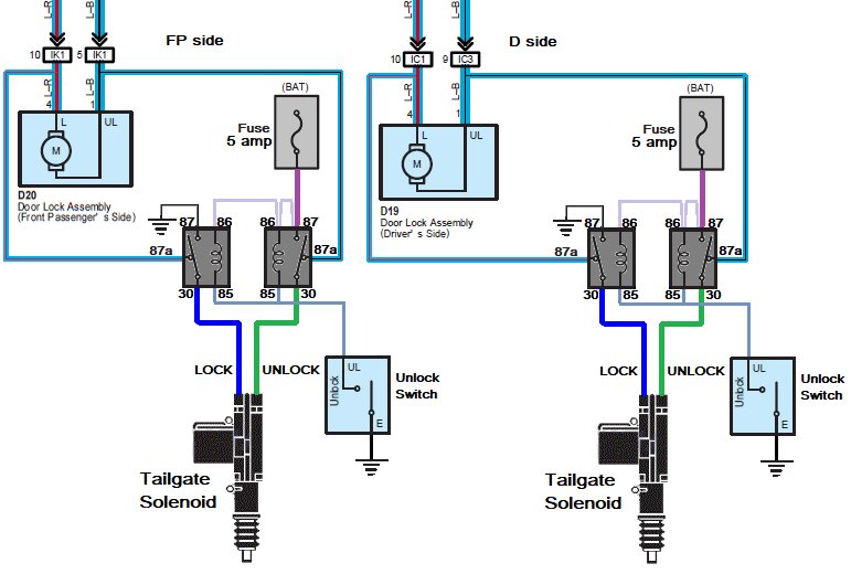

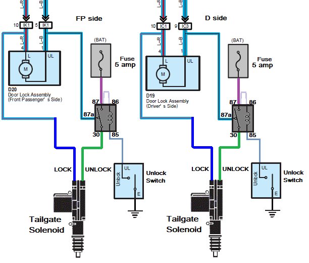

    For those with a need/want, to unlock tailgate added locking/unlocking solenoid via hidden or not hidden switch.
    As tied into vehicle's power lock circuit, Front Passenger's side & Driver's side.
    With added 5-pin relays to isolate the tailgate solenoid from the rest of the vehicle lock/unlock circuit.

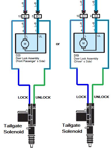

    This will also work...
