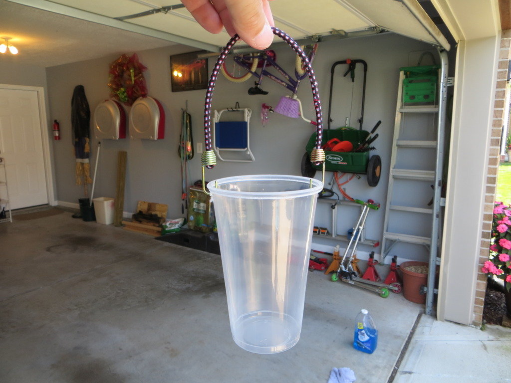

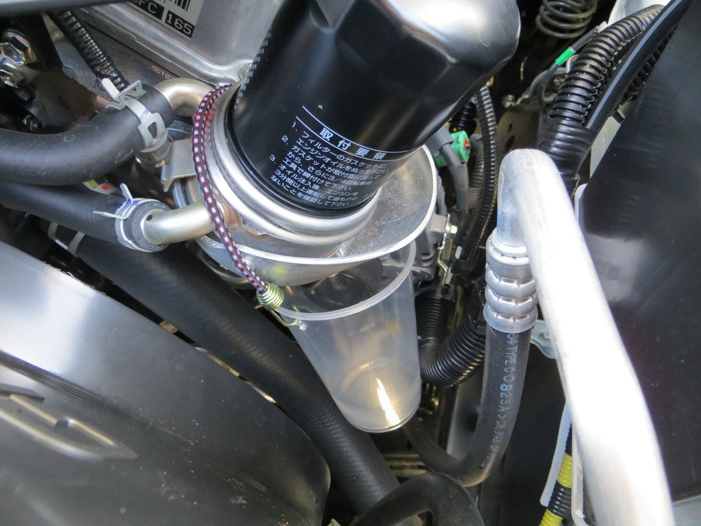

    This may not be original...but it is to me and I thought I would share it just in case anyone else likes it. I assume this would apply to any 4.0L V6...be it Taco/XRunner, 4Runner, FJ, etc.
    Since our oil filter is on the top of the engine, many of us use some hose to connect to the nipple on the collar of the filter housing to drain into the catch pan. Nothing wrong with that at all. This is just an alternative to using a hose.
    I just took a plastic cup (a slim one), put a couple of holes in the rim and attached a small bungee cord to it. When your done carefully lift it out and dump it. Throw the cup away or clean it out and use it next time.

    Innovative. I like. I normally use a water bottle. Good tip.

    Thanks. I've done 2 OC's with it. Very easy and clean with nothing more than a paper towel to clean out the cup when I'm done. No more nasty dripping hose for me. :thumbsup:
