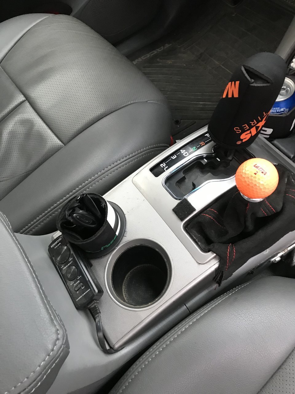

    Automatic Tacoma’s only have a single cup holder behind the shifter. Amazoned a drop in cup holder and a hole saw, bam, 2nd cup holder. Don’t mind the golf ball shift knob.

    That's innovation.
