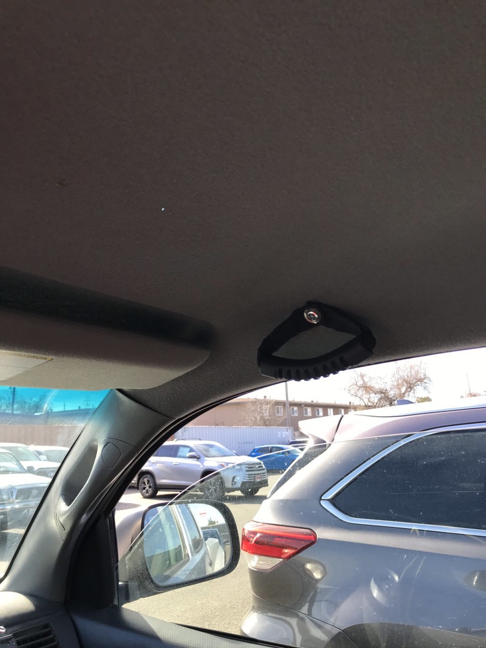

    Best mod for my wife so far. Simple headrest handle from Amazon. Pulled the headliner down and found a mount for other models. Marked and drilled headliner and boom, passenger side grab handle.

    Very nice!
    How did you know to look for the attachment point?

    I was going to mount one no matter. I was going to use pop rivet nuts but found the factory mount once I pulled the headliner down.
