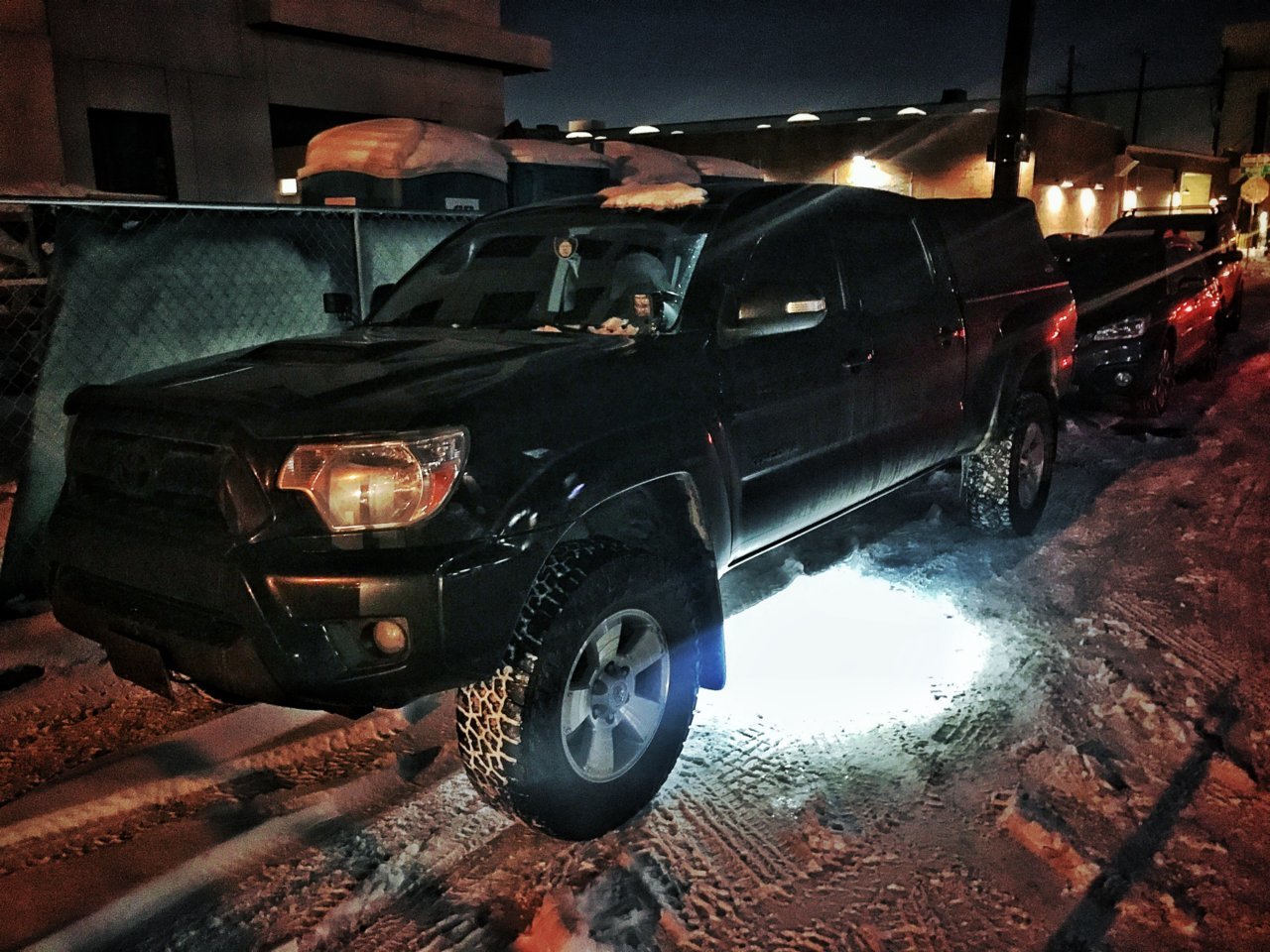

    How about DIY puddle lights. A few options out there. B5BC1D8B-3D59-4C87-8D61-D371B663A20E.jpg

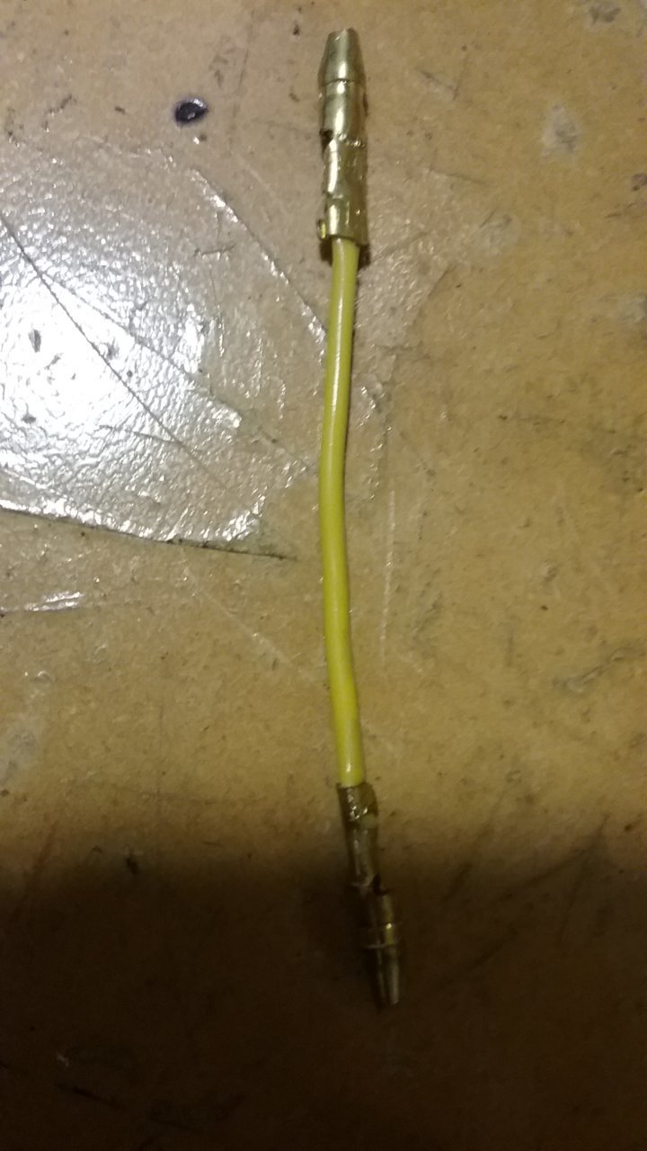

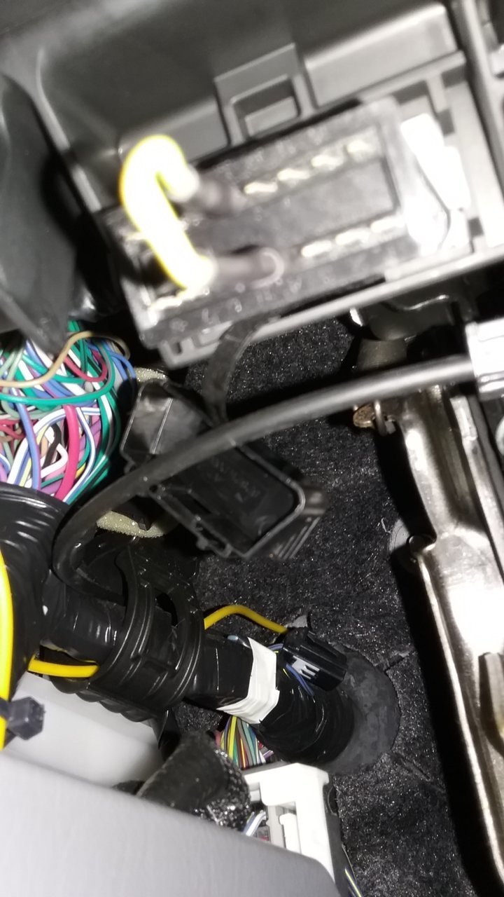

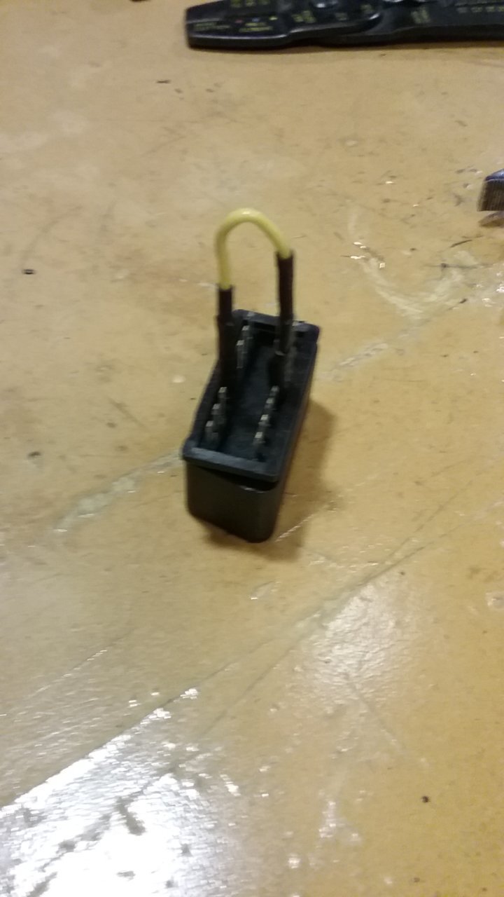

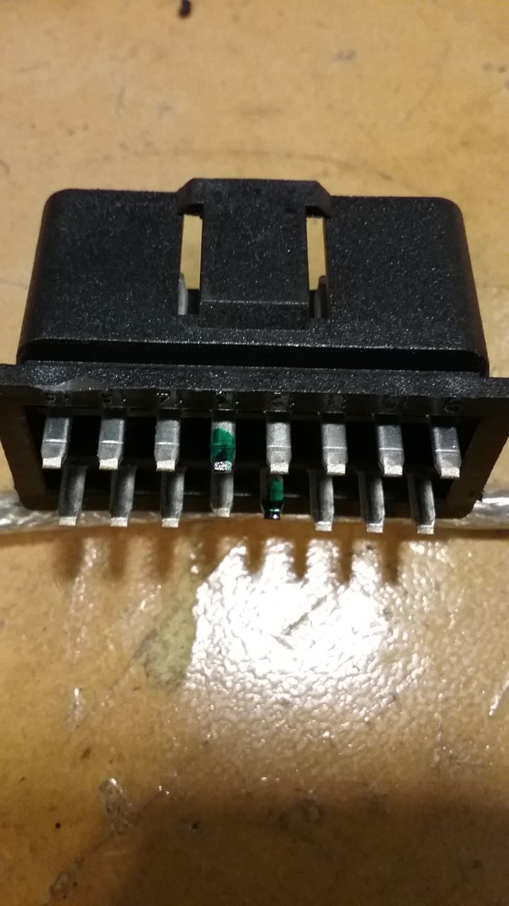

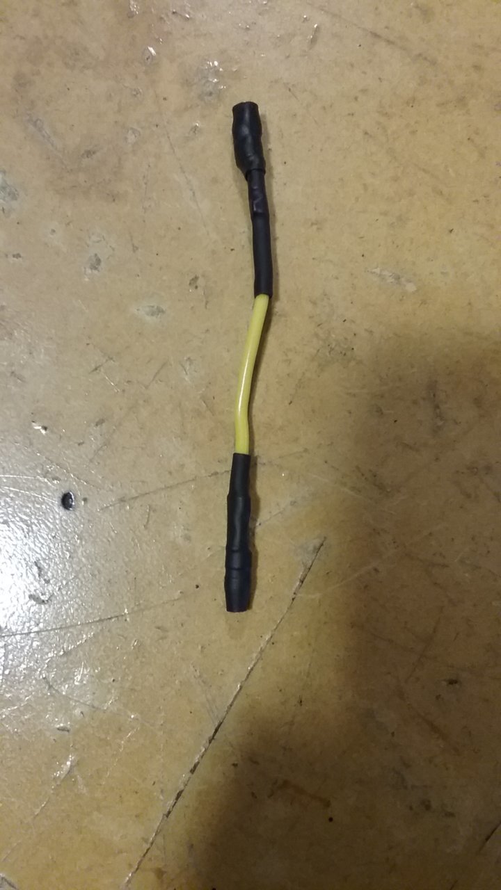

    For those you who have not visited the how-to thread for the 2nd gen transmission drain and fill...here's a tip. I didn't come up with this idea. But I did copy it and am passing it foward .
    Buy a male OBDII connector. I picked one up on Amazon for $6.50.
    Permanently jump pins #4 and #13. Now you have a simple plug and play option when setting the rig into temp check mode for transmission fluid work. No more horsing around with trying to insert a wire.
    I've used it 3 times so far. Works perfectly.
    Marked the pins with a green Sharpie.
    Created a jumper wire. I insulated it with shrink wrap.
    Finished product.

    What type of wire connectors did you use for the pins? I made one of those also but your wire connectors look much more secure.

    I have a box of nothing but terminals and such....stuff that I've accumulated for years. I can say for sure...but I think they were the male ends of a male/female connection that could be unplugged if need be.

    Looks like 1/8" spade.
