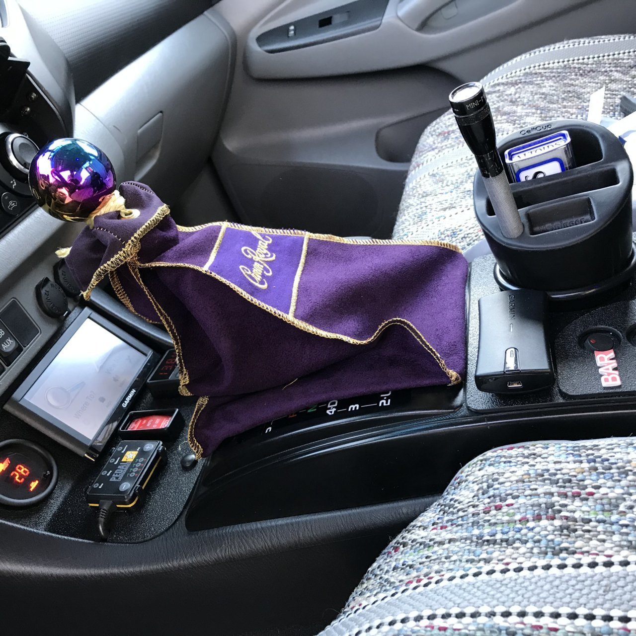

    Is that panel ABS? If so, how did you bend it? I'm thinking of attempting that with some ABS grill honeycomb.

    Yes its ABS...slow...low heat as in a heat gun on low setting, as it approaches the right temp to bend..... it will on its own....once you see that..... bend slowly to desired shape and hold till its completely cool (I run it under the water) once its cold it holds where ever you bent it too ? to ? two? its one of those 2's.....

    Ha, ha, and thanks for the tips. Since the bends half too bee placed exactly I was thinking of making a form out of to x ten so they are in the right place, at the correct angle, and have the the right radius of curvature. Still waiting on finding a local grill insert though.
