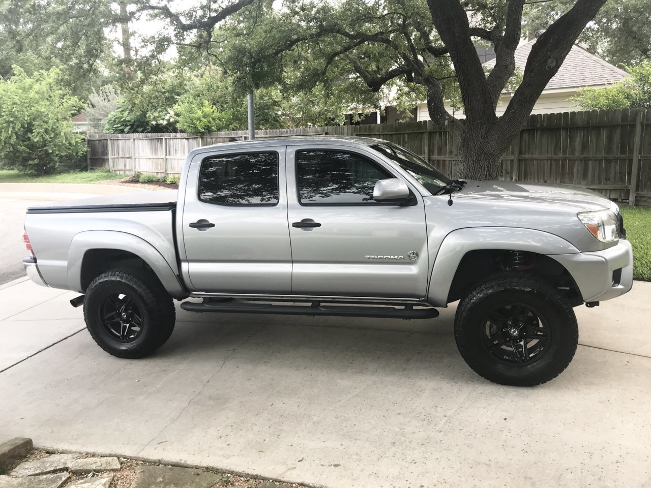

    3” lift with 285s. And you may need ucas if you can’t get the alignment in specs. You won’t know till it’s on the rack. 836B0D3D-B525-4EF1-BB5E-B6EAB78FC063.jpg

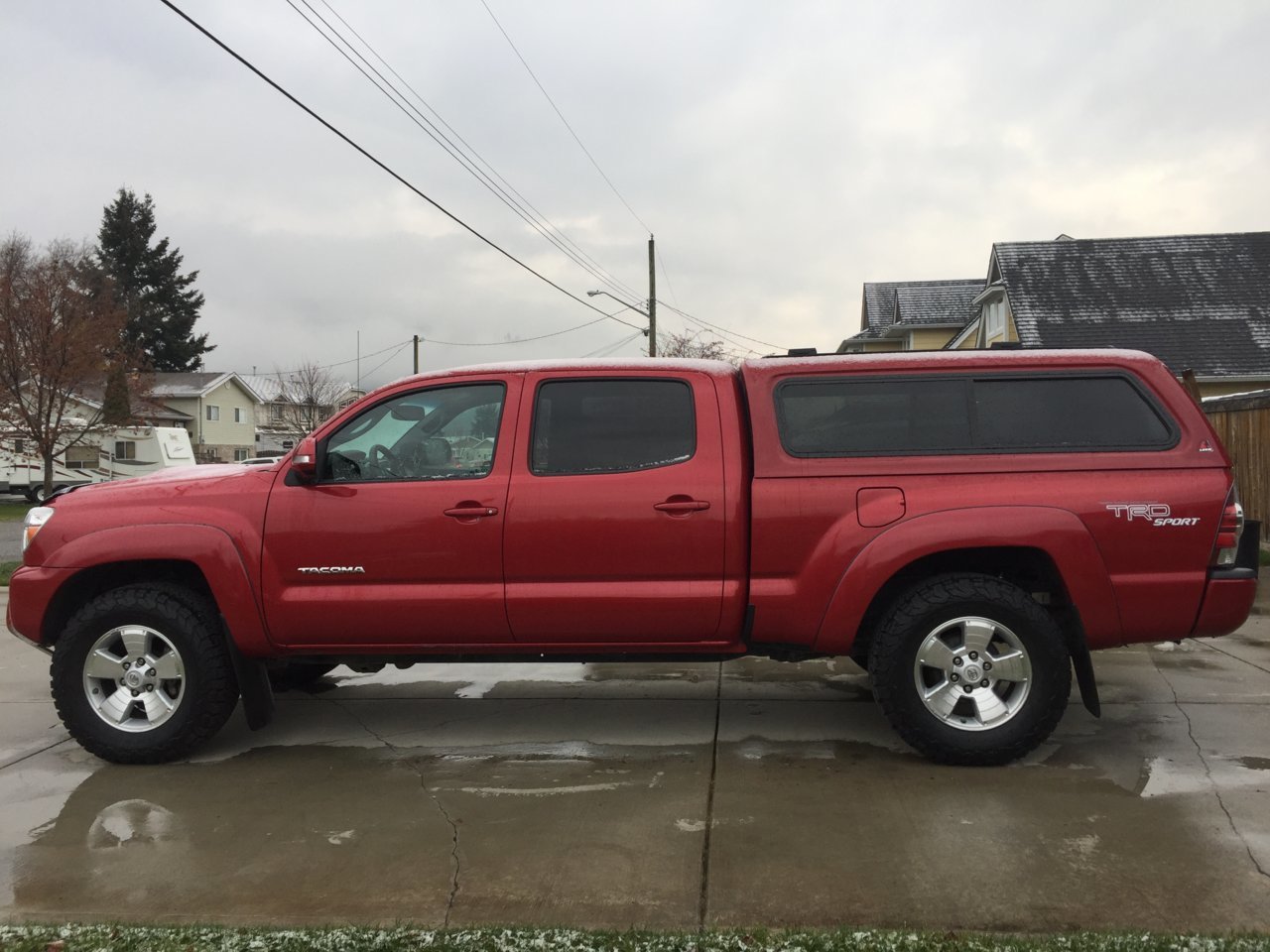

    - ICON UCAs, BP51/Kings, SCS wheels, 285s, Leer 100XR canopy. Greenlane aluminum winch bumper, Smittybilt X20 winch. Trying Falken AT3w now, Really like BF KO2s.
    I like 255s but my 285 70 17 C load KO2s are only 51lbs vs the 53lbs Falken, 55lbs Nitto and 58lbs for the ST Maxx.
    I’m still getting close to 18mpg combined with a lift and a leer Canopy.
    Also 255s wander a bit more than 285s.

    I did run 265 70 17 on my stock Sport wheels, and then I got some SCS wheels. I just had a tech at Toyota (I know sounds crazy) do a wheel alignment and I had no issues.
    This is with 5100s and Eibach coils so around 1.5 inch of lift. Icon mini leaf pack in the rear.
