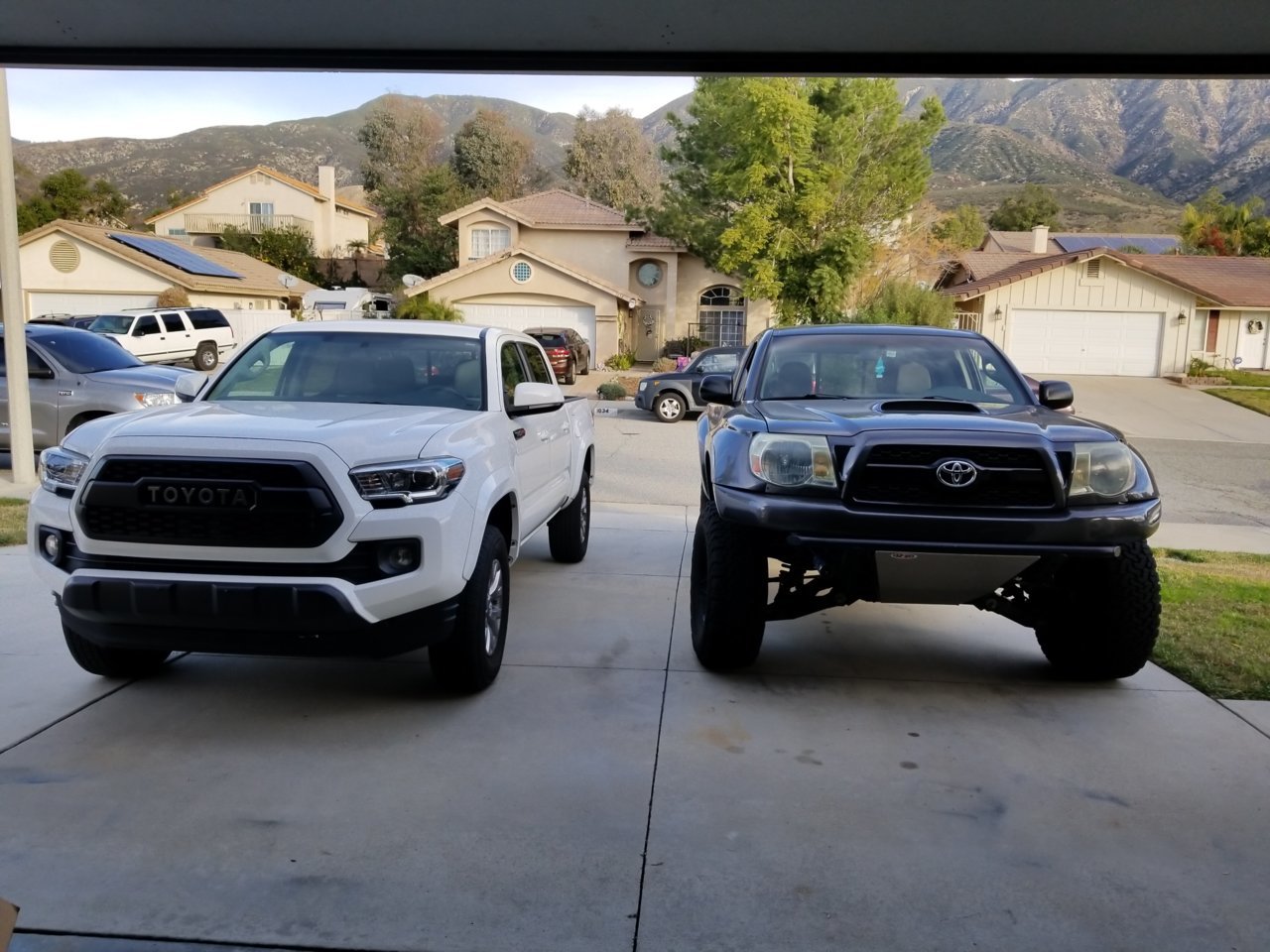

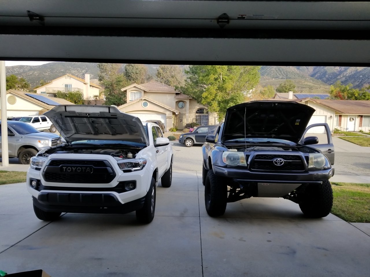

    I'm currently doing some research on converting my 2nd gen front end to 3rd gen front end.
    According to my research the cab on 3rd gen and 2nd are nearly indentical.
    My wife has a 3rd gen and I have a 2nd gen. So I made a few comparisons.

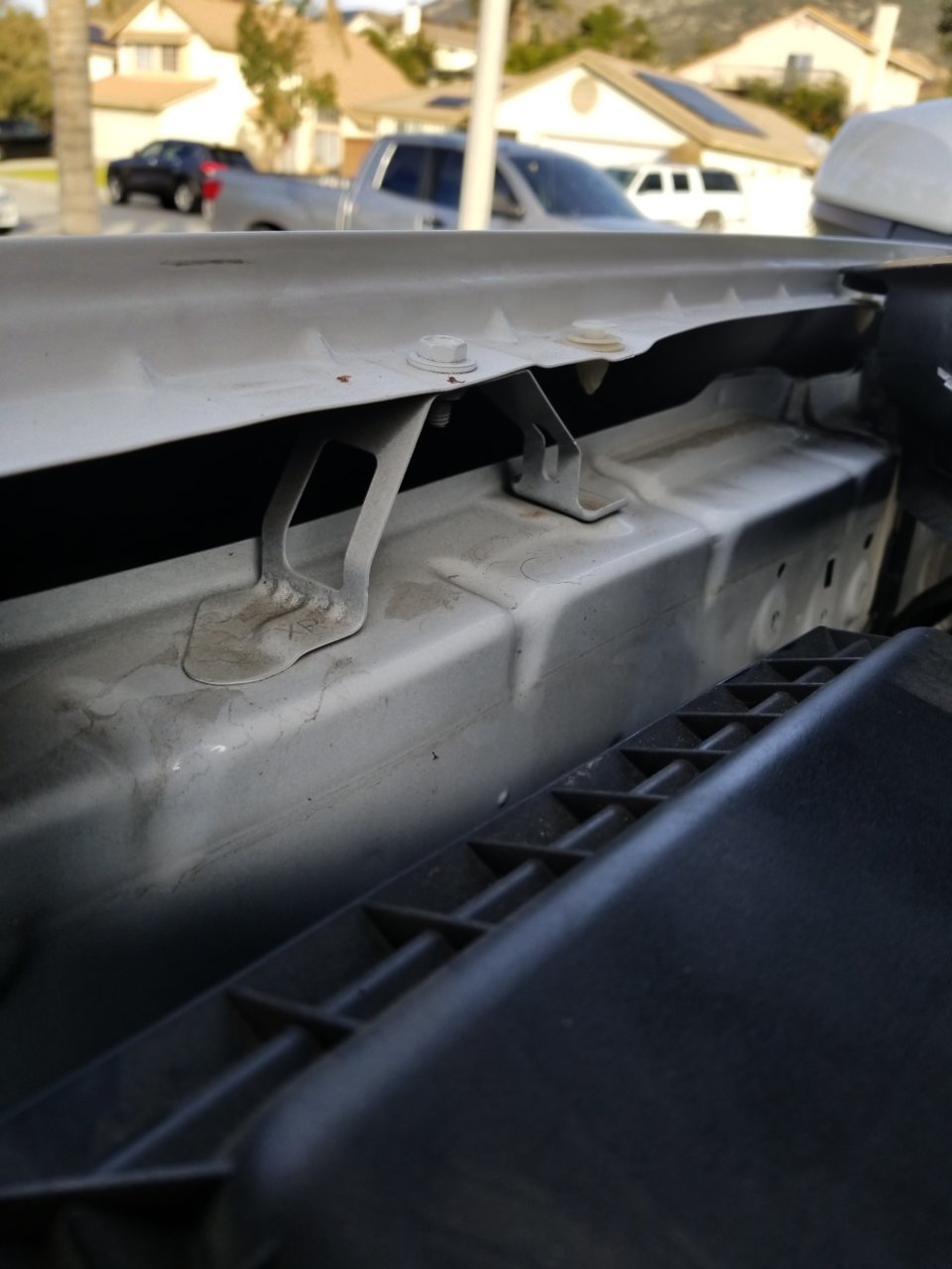

    I know you will definitely need 3rd gen hood hinges. 3rd gens are different and have incorporated a extra flange where 3rd gen fenders are bolted.
    3rd gen also has taller fenders so they have incorporated riser bolt points to compensate for taller fenders. A total two per side. They look like a table top flanges. Pics attached
    You will also need 3rd gen hood latch assembly for longer hood and grille attachment. Grille on 3rd gen is pushed forward about 4-5 inches.
    I understand there's already a thread (link below) but not much details.
    https://www.tacomaworld.com/threads/convention-2008-to-2016.427200/

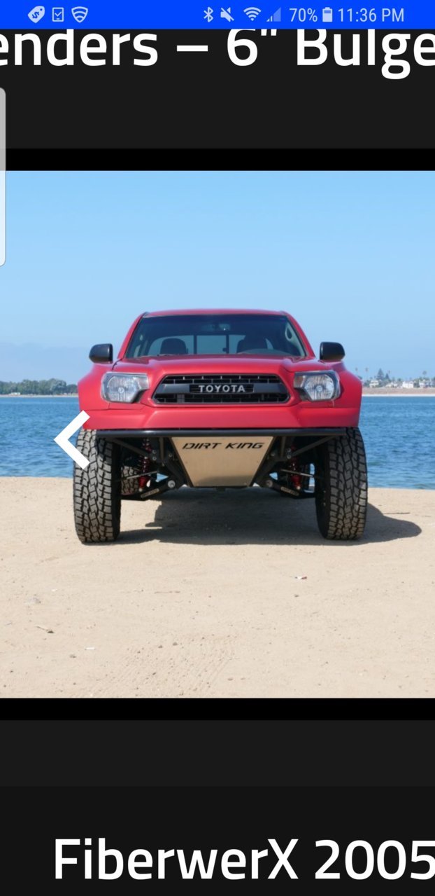

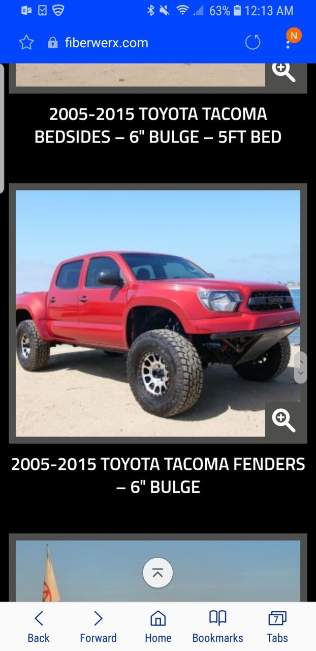

    When 3rd gens first hit market, I thought 2nd gen front ends looked better as well, especially 2012-2015 front end which would be easier to convert from my 09 2nd gen.
    But the 3rd gens look grew on me and was already planning to convert to 2012-2015 front end via fiberwerx 6" fenders with 2012 valance which is pretty rad.[​IMG]
    Then thought if I'm going to convert to 12, why not 16.
    Mcneil fiberglass has a 2nd gen to 3rd gen conversion kit in the works but the down side is that they are selling a fiberglass hood with it that requires hood pins. I prefer using a OEM steel hood which may be possible via 3rd gen hinges and 3rd gen hood latch assembly.
    Yes, my 3rd gen is a trd proser. It's a sr5 in transition : )

    Red truck is Fiberwerx s kit.
    Silver is mcneils 2nd to 3rd gen conversion.

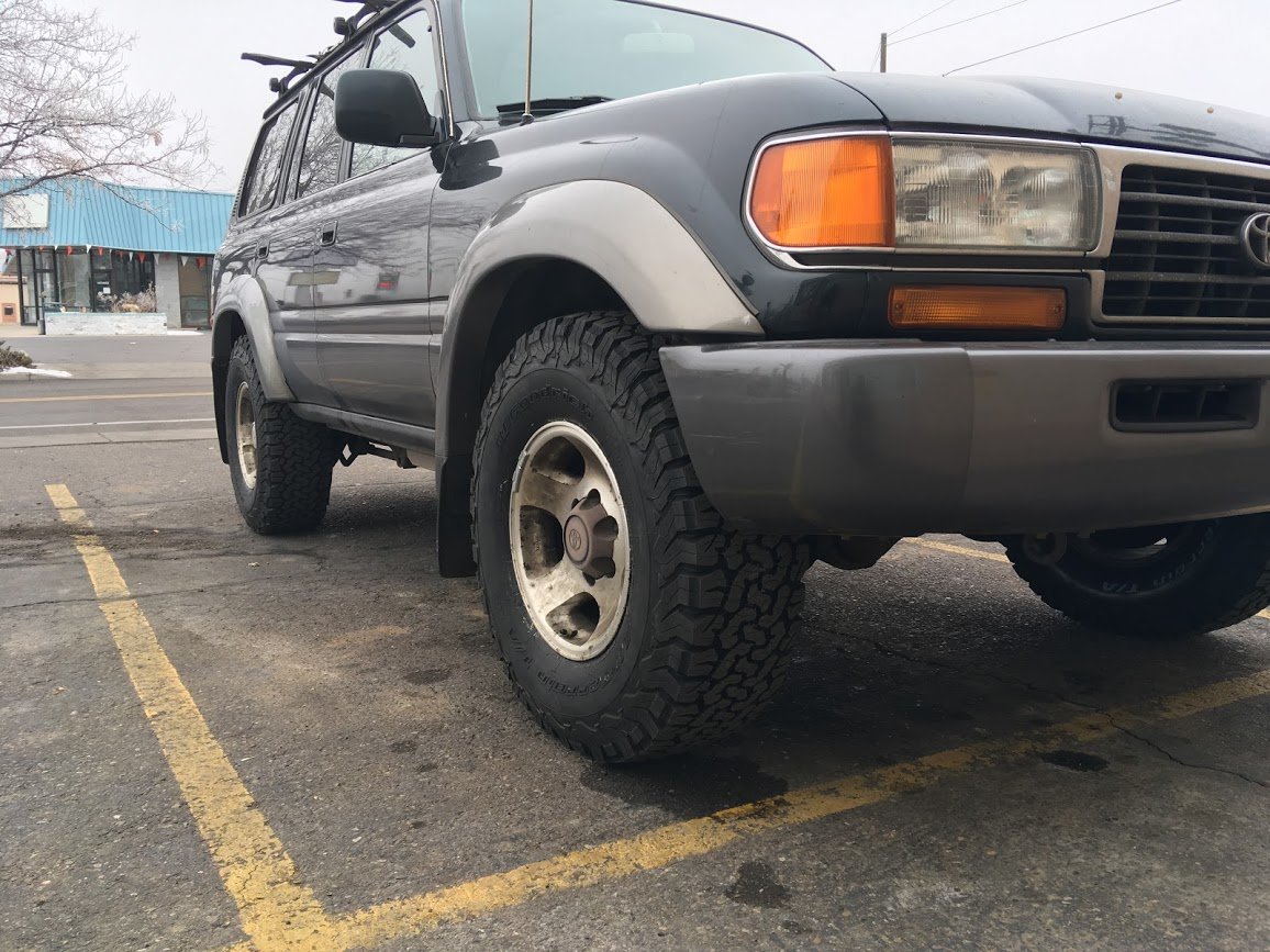

    Land Cruiser conversion is best IMHO:
    This Front end conversion also allows fitment of 285/75/16s with no modification. :)
