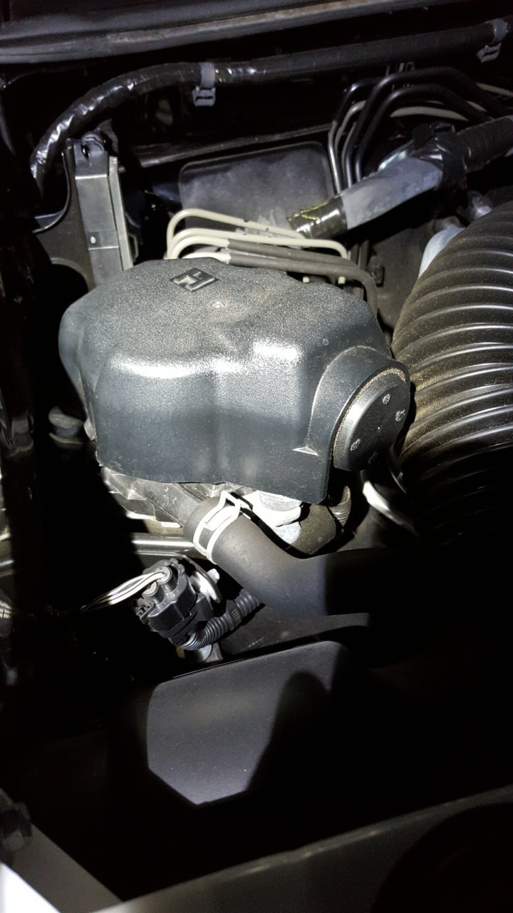

    I just checked the vin and there is a recall on it. Quoted from the recall/campaign:
    Any authorized Toyota dealer will inspect the vehicle. Based on this inspection the dealer will repair the air injection pump and install an improved filter, or replace the air injection pump with one that contains an improved filter, as needed, FREE OF CHARGE. The dealer will also replace the air switching valves in the vehicle emissions system FREE OF CHARGE.

    That's great you have that covered if it happens. The symptom is Limp Mode. My sons truck did this just before the recall. I spent about 500 bucks on parts and fixed it myself. A year later the recall came out but I could not find my receipt. You might want to open the pump and take out the little sponge filter and replace it with a Uni-Filter. The sponge will come apart and get sucked in the valve and clog it up. I did this to my 2015 just to be safe.

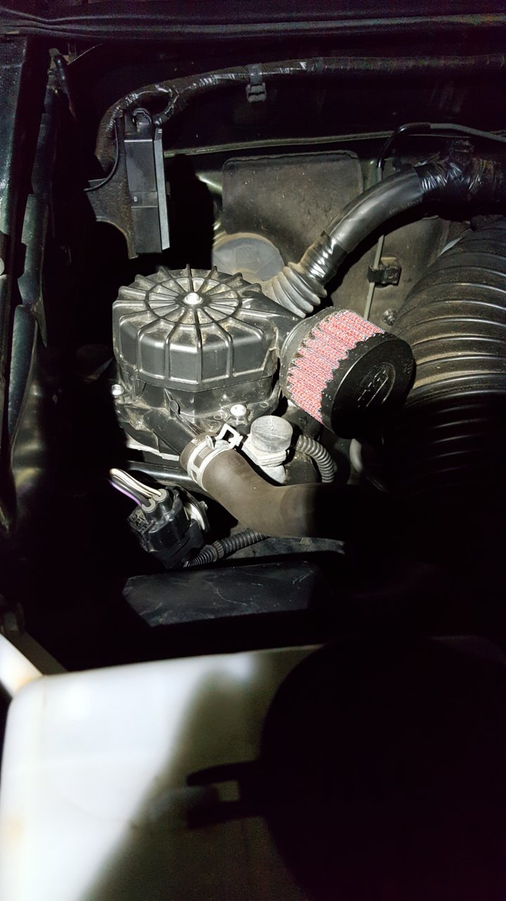

    I have seen the $13 uni filter mod. Was that filter the cause of the problem with your kids truck. I don't believe the recall has been done on this 2012 yet. Previous owner told me that, beyond maintenance parts and tires, the only actual "repair" he has made was a light bulb.

    Well when I pulled the cover off the fan motor half the sponge was gone but also there was water and mud in there. He is young and likes to have fun so I am sure his mud riding had a lot to do with it. After I replaced the parts and added the uni filter I also bought a cover for the fan to help keep it dry. My 2015 has a cover on it so I ordered one for mine and it fit perfect on his. I don't think the 2012's had that option yet. 5 years now so far so good.

    Will the cover fit with the external filter installed. I guess it would since the "breather" section sticks out anyway. That cover is on my salvage yard list unless I find a new one cheap online. The recall looks good since they replace the valves too. My rear wheel drive will not see mud unless some biblical thing occurs.

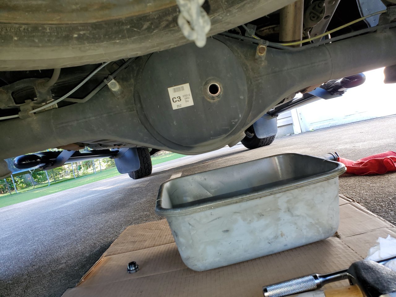

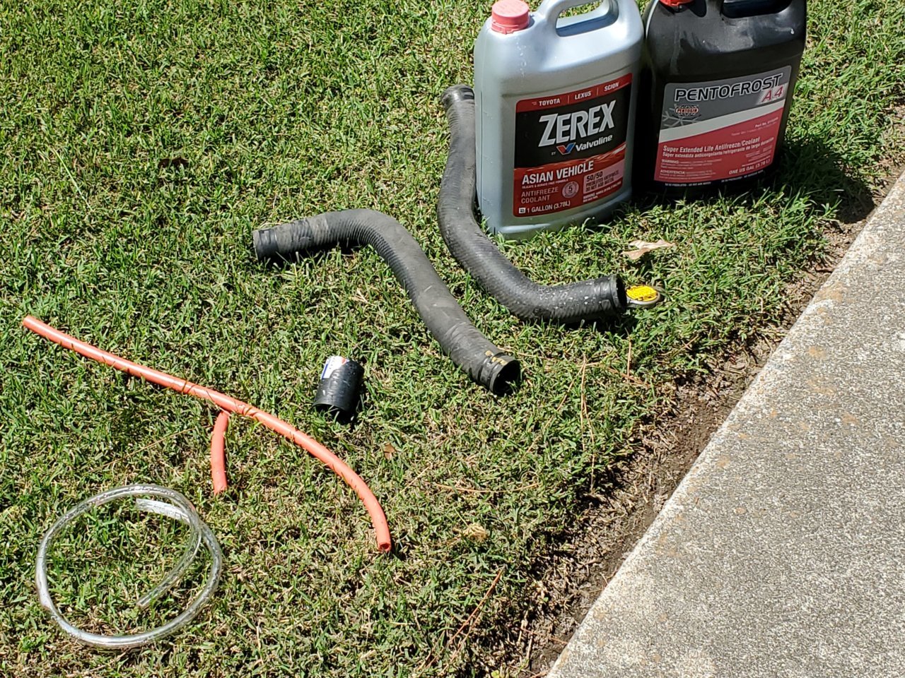

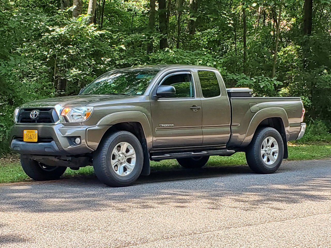

    Just an update. Installed my Quikfix brand seat spacers under both front seats. Replaced dull yellowed headlight to match the other that had been replaced. Spark plugs done. Diff fluid changed. PCV changed. Brakes changed. MAF cleaned with CRC. Engine block and radiator coolant drained and filled. Replaced upper and lower radiator hoses. Drained and cleaned coolant reservoir tank. Radiator cap replaced. Serpentine changed. Throttle body CRC cleaner bought-need to get a gasket first. RWD has no zerks in driveshaft u-joints but they are tight and quiet. Still need to flush and fill power steering fluid and brake fluid. Still need to drop at dealer for full 10 qt transmission service. Very satisfied with how well it runs, shifts and drives.

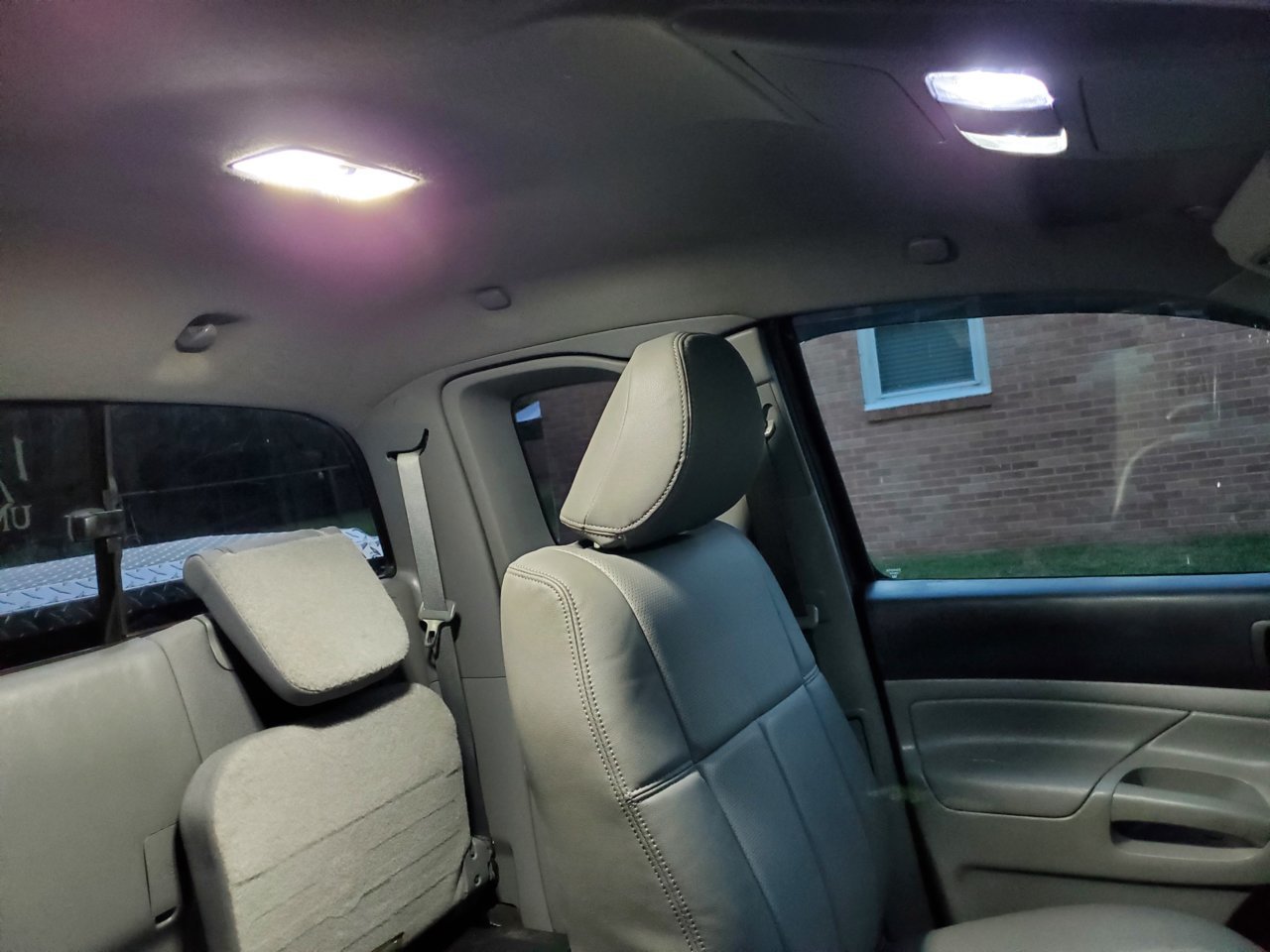

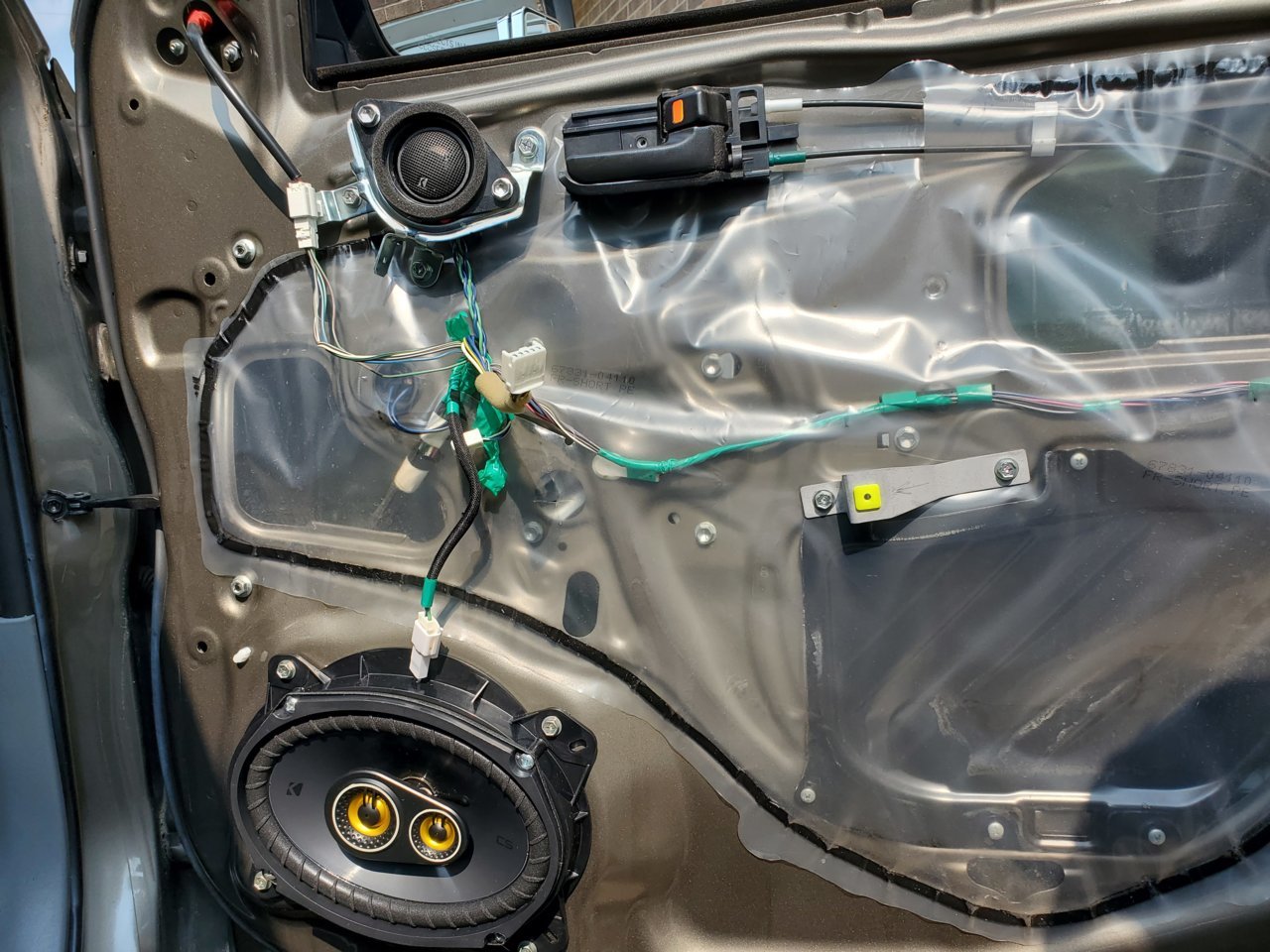

    Also added nerf bars, tool box, vent visors and Clazzio seat covers. Replaced all door 6x9 speakers and tweeters with Kickers. Replaced quirky hvac knobs with the lighted knurled rotary style knobs. Gutted my 3rd gen meso ultimate LED dome and fitted guts to my 2nd gen stock dome housing (after some minor solder repairs). Replaced maps with much whiter and brighter LED bulbs. Replaced rough riding AT tires on stock 16" steelies with 17" 2019 4runner SR5 wheels with Dunlop 265/70/17 street tires (also replaced spare tire with new 4runner 17" wheel and tire). Bought 2nd fob and 2 extra programmed keys. It's getting there. Had it a month and still haven't washed, compounded minor scratches out and done the ceramic wax yet due to frequent rainy weather.

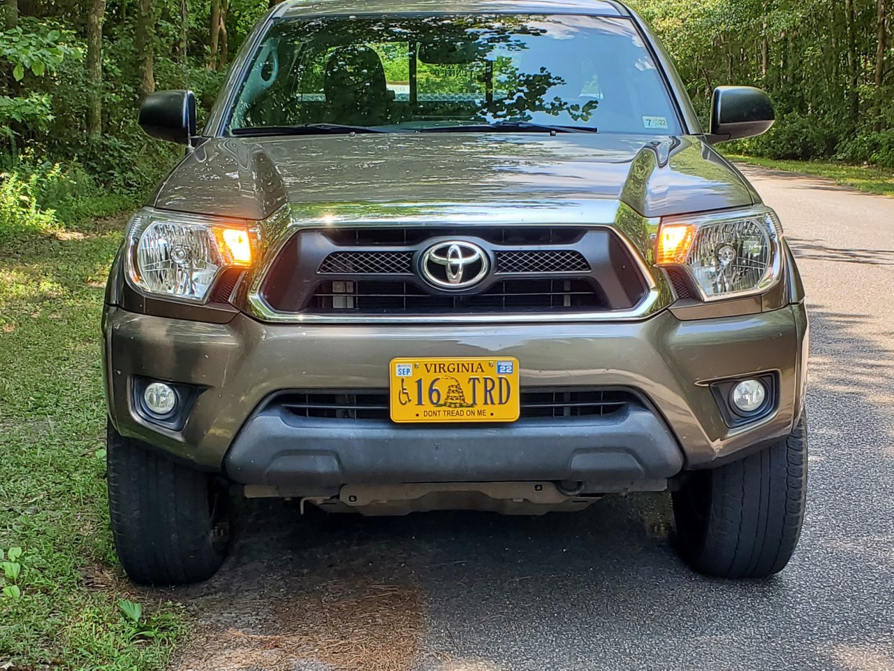

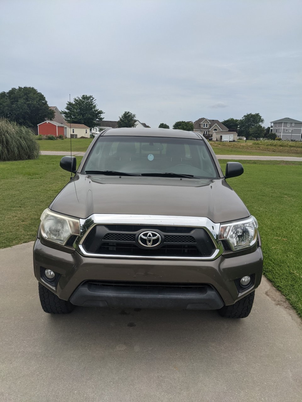

    I had the tinted Pro headlights in my 3rd gen so the dull (more cloudy than yellow) single light on the 2nd gen really irked me.
    before when purchased:
    after I bought it:
    Don't knock the 3rd gen plates. They were paid for until 09/2022 so kept them for now.

    How are the speakers with the (I assume) stock head unit? Did they really make a difference?
