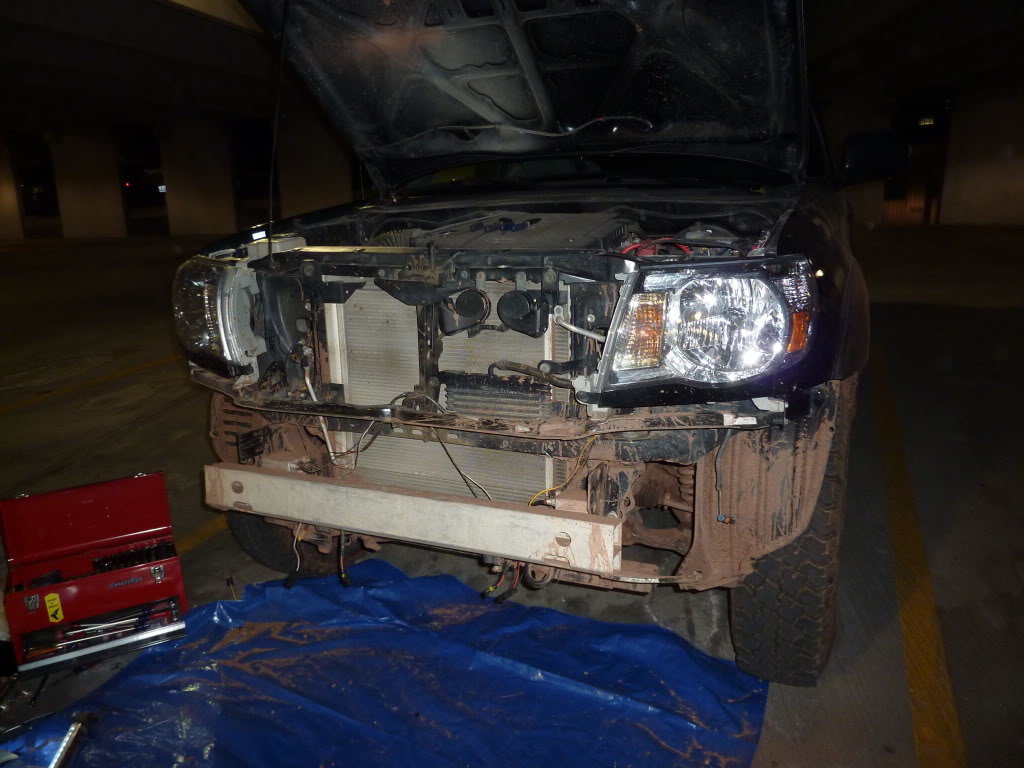

    Its about the size of a envelope.

    How thick is it? Do happen to have a picture? How is it connected?

    It t's into the top line of the tranny cooler lines going to the radiator. Do not run it off the bottom line. The radiator warms as well as cools the fluid. Too cool fluid=rough shifting.
    You want one with the least amount of flow resistance. Usually around 1" thick or more. It's more about efficency of cooling than size. Smaller, crossflow coolers are better than larger tube-style coolers.

    Hi SB,
    Is that the trans cooler that comes with the tow package, or is it an aftermarket? Also what is that trans cooler rated at in terms of towing pounds/capacity?

    Ya it comes with the towing package. The size of cooler doesn't determine the capacity that you can tow. They say yuo can tow 6500lb with the towing package, but I seen tests where someone hooked in a trans temp gauge and with no load they were pulling some high numbers in the city.
