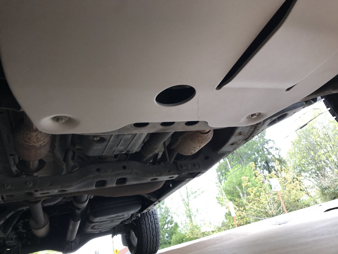

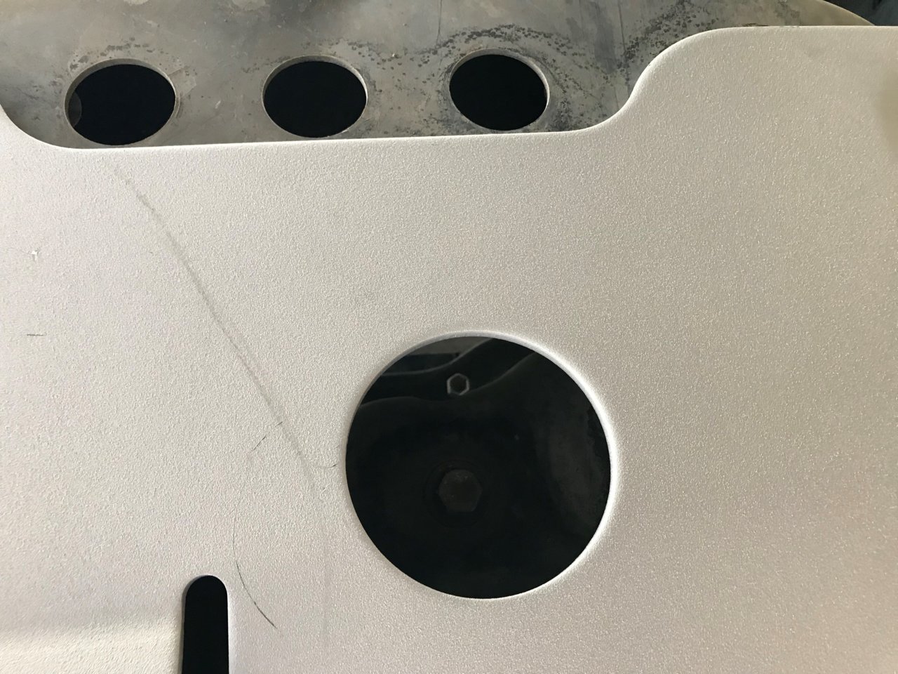

    I just ordered the 3rd gen TRD Pro skid plate (PTR6035160) for my 2007 TRD Sport 4x4. I will post pics once I receive it and can confirm that it also fits 2nd gen. From looking at aftermarket skid pics, it looks like it should fit and still facilitate oil changes without removal. I also read in another TW thread that mobtown says their 2nd/3rd gen plates are interchangeable. A lot of people seem to think that the aftermarket skids are better, for similar pricing, but my comparison shopping landed the OEM plate at $405 shipped; whereas most comparable aftermarket plates were north of that.

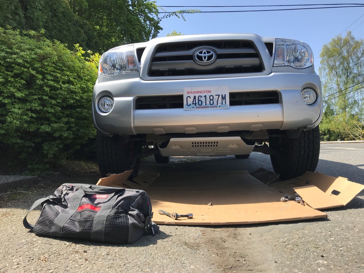

    It fits. Also, I weighed it at 27 pounds.3rd gen Skid.jpg oilDrain.jpgIMG_7255.jpg

    I can confirm the TRD PRO skid fits 2nd gen perfectly. Installed on my 2012 Baja.

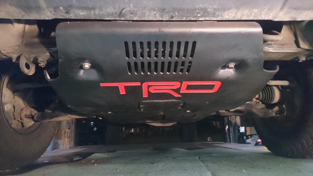

    I have the third gen TRD skid plate on my '12.
