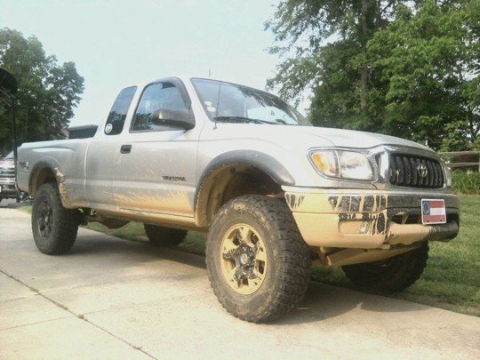

    So I am getting ready to convert my truck to manual hub 4wd, will the 2nd gen TRD rims fit over them?
    Like these rims

    They sure will! Keep in mind the offset of those wheels is different then the 1st gens. I had to run spidertrax 1.5" lug centric spacers after i swapped to 2nd gen wheels and they are great. The truck drives like a Lexus, no wobble AT ALL!

    Sweet man!! Yeah I have these rims already and they are very close to the top of the front spindles!! I was just concerned about the center fitting over manual hubs!! I need some of those spodertrax spacers!!

    Bore should be fine.
    as stated you will need spacers as they are around 5.5'' BS which is too little so you need to push them out more.

    I already have them on my truck with out a problem. Probably will buy spacers soon anyways though!
