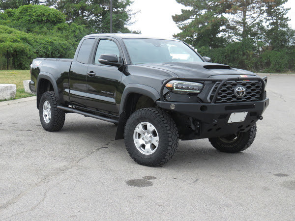

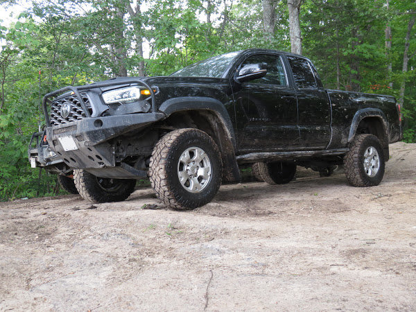

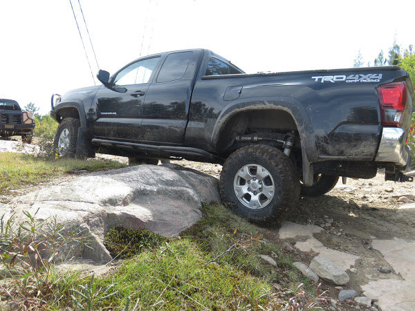

    I've been running them for more than 10 years on two trucks. The finish is holding up despite all the trail rash with effectively zero maintenance. Their high offset causes rubbing on the UCA and LCA at full steering lock with my alignment setup (SPC UCA, LCA cam bolts set for max caster), but it hasn't been enough of a problem for me to change anything.

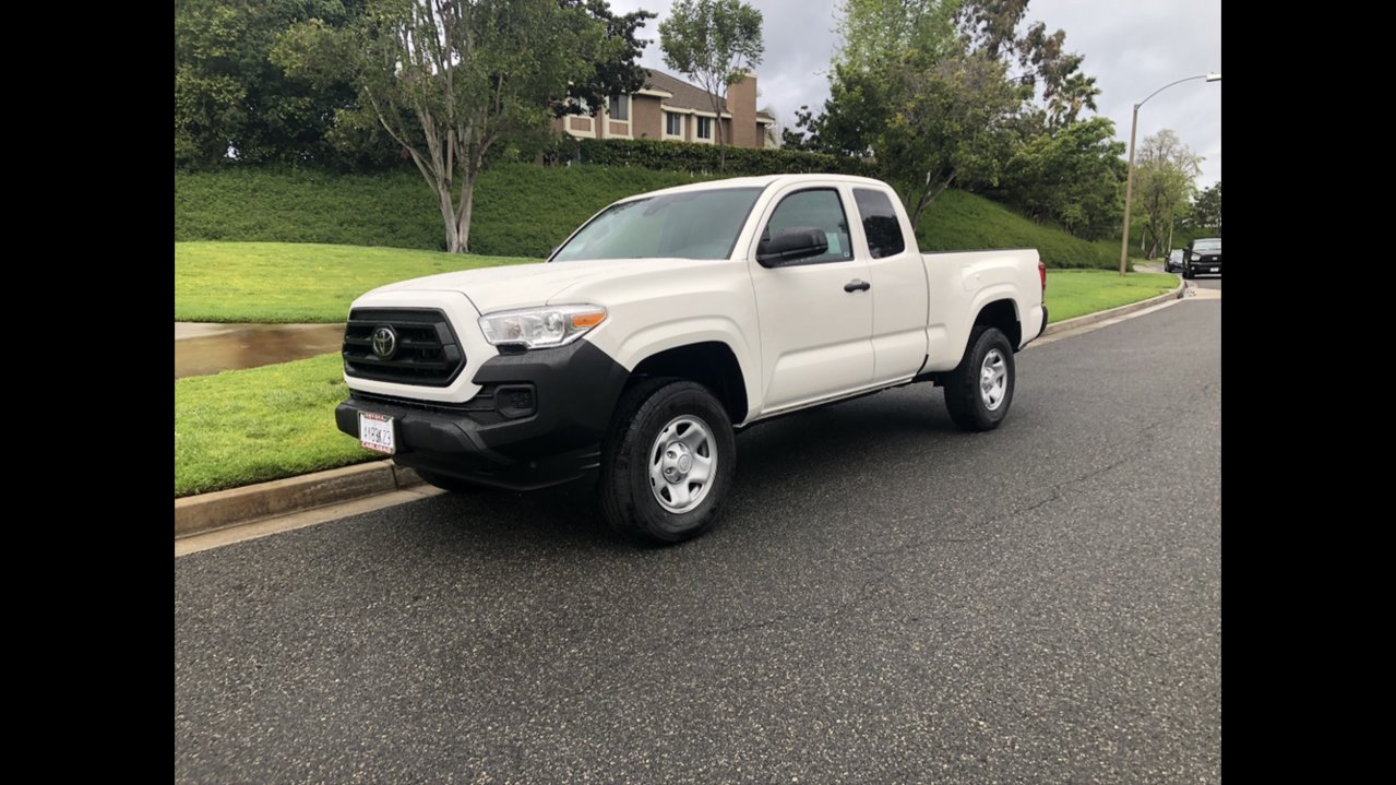

    They’re replacing the stock 2018 SR steel wheels with a 25mm offset, so those with the 30mm offset shouldn’t be an issue on a completely stock suspension. I was planning on going with 265/70R16 tires instead of the stock 245/75R16. I am not anticipating any rubbing. Hopefully?

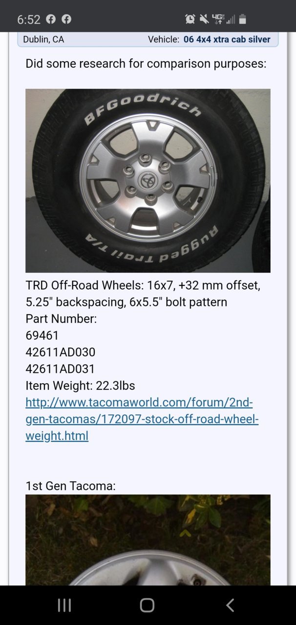

    I ran a stock 265/70-16 on my snow tires. They the offset on those are 5mm higher than the stock 2016 TRD Off-Road alloy per this thread:
    https://www.tacomaworld.com/threads/wheel-specs.30754/
    Per that thread it appears at least that the SR5 steel wheel and the 2G TRD Off-Road has the same offset. I've run both on my truck and had zero issue with rubbing, but my truck was lifted with the SR5 steel wheel.

    From what I can tell, the rubbing happens only with my specific setup - SPC UCA, LCA cam bolts at max caster. If you run a non-adjustable UCA (stock or aftermarket), you won't be able to set LCA cam bolts at max caster, and therefore won't have this problem.
