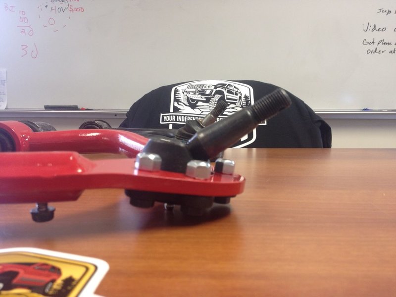

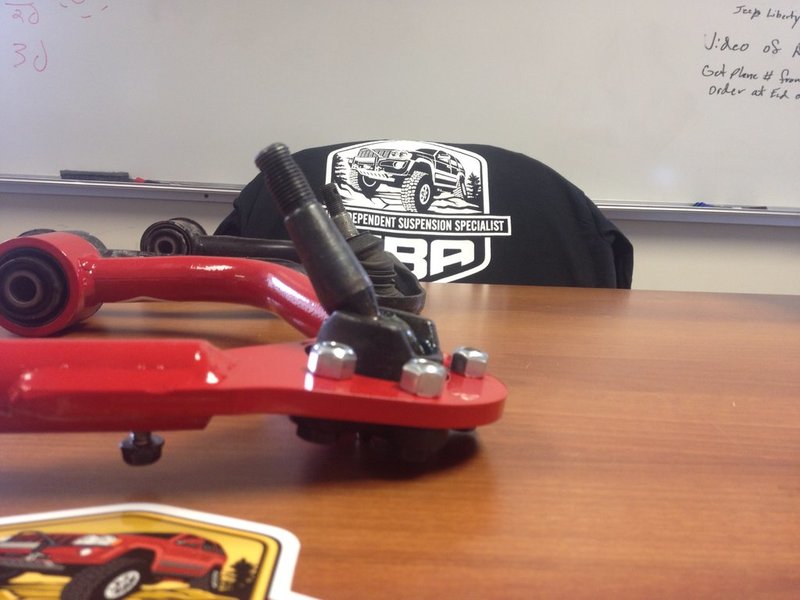

    FYI JBA got back to me (REALLY quick i might add).
    Downtravel flex is MUCH greater than stock, id be interested to see how this would compare to a uniball.

    I'm sure those will articulate enough that they won't limit your down travel. But I doubt you'll ever need that much flex or angle in that BJ to reach full droop.

    I can only imagine that a 1 ton ball joint off a Chevy truck is much stronger and hence longer lasting than our stock ball joints. I'm going to be getting some JBA's in the future.

    Possible. I know even with uniballs they come REAL close to topping out the flex on them with 5100's
