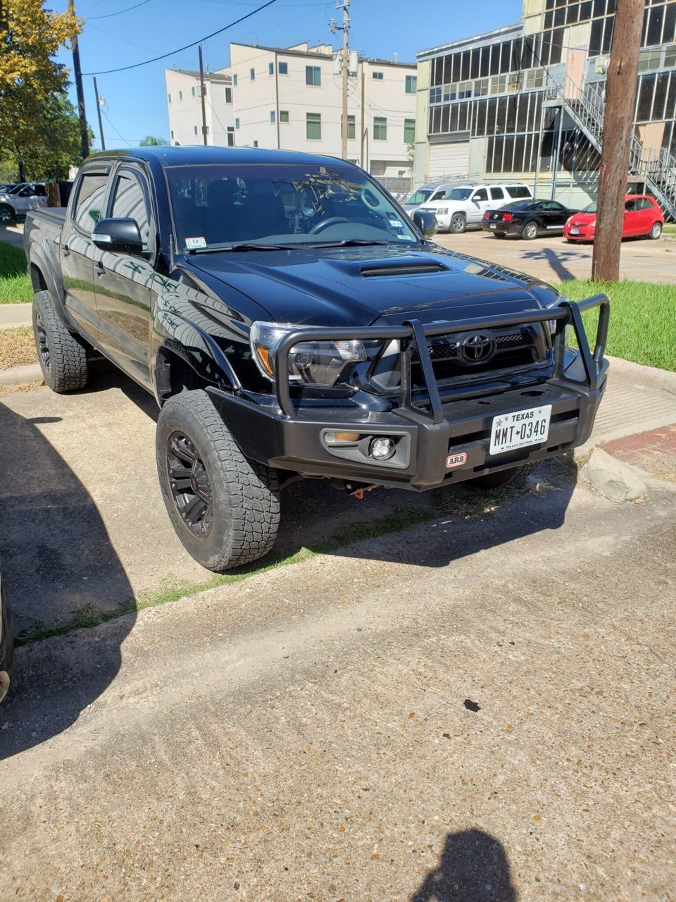

    I have a toytec boss coil-over (on my 2014 TRD sport) that needs to be taken into the shop to get un-seized. I can't get the allen head release screw to budge, so before I really bone myself, im going to take it in. While they are taking out the stock uppers too, I thought I might as well upgrade. whose got the best bang for ya buck with a budget of around $500? I have heard good things about JBA UCA's, but still looking around. I offroad a bit, but nothing hard when I do, the beaches of Houston, and some trails in Austion (soon!!)
    Thanks in advance guys!
