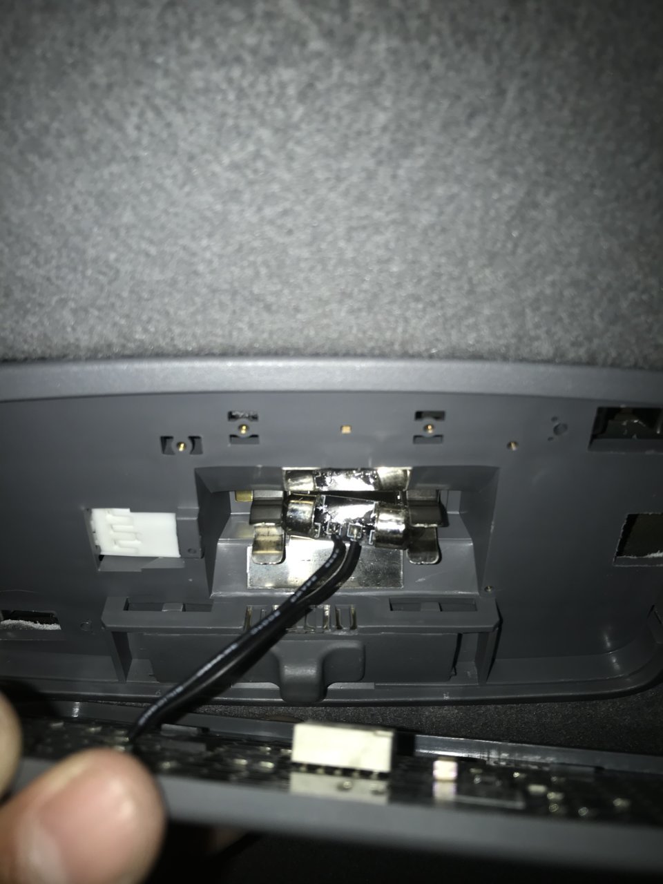

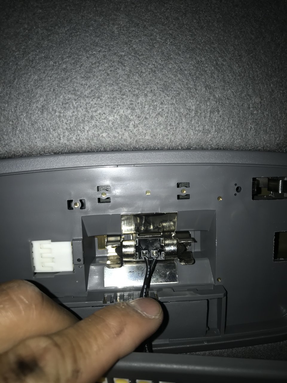

    @MESO I just got my new plastic piece in the mail today and went to go install it but the feston tube isn’t fitting snug in there. It looks a little small cause it can’t stay in. Am missing something here?499DDD3F-AB4D-44AF-8A55-CF0900199BFD.jpg70CA6AC2-9240-4636-847B-4680A7C5B19A.jpg

    Remove adapter, Pinch the metal contacts closer together with your fingers. Reinsert bulb adapter it will be making contact on each of the tapered ends. Looks loose but it will fit snug and won’t move.

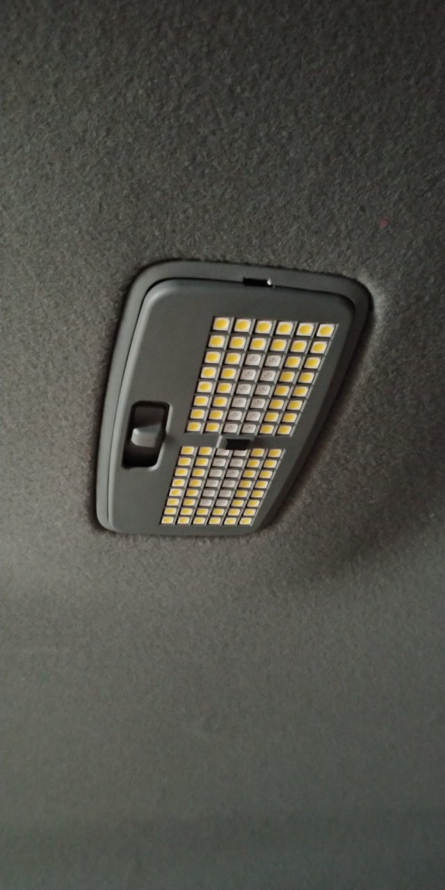

    got it! Thanks meso. Your shit it bright AF like always.E5CA732D-7CB1-48AB-9761-1180B4F62F36.jpg
