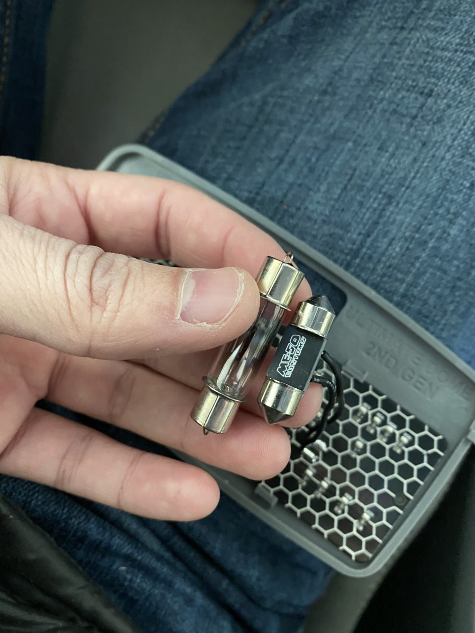

  17. Dec 30, 2020 at 1:09 PM
    #3197
    Iggy
    Iggy Well-Known Member
    Feb 2, 2012
    #71971
    4,016
    Northern CA
    09 4x4 Off-Road Access Cab
    Check out the build
    How are you guys wedging this adapter in the light. Is a lot smaller than the holder.
  18. Dec 30, 2020 at 1:26 PM
    #3198
    kidsmoke
    kidsmoke Well-Known Member
    Mar 14, 2015
    #150859
    2,697
    Flyover Country
    '13 BR AC SR5 4x4 AT
    A: remove the old lamp (done)
    B: pinch the spring clips in the fixture closed - or closer together. The spring clips remain separated slightly
    C: insert the new festoon. the spring clips will capture it on the conical ends. It will not be grasped by the spring clips in the same 'snap in' manner as the original lamp. This is ok. All it needs is to be making contact.
    D: Install the LED light fixture. Locate "Eclipse" glasses. Enjoy.
