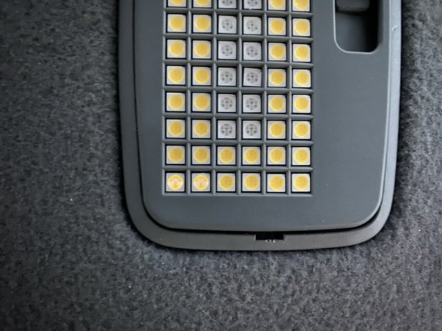

    I just got my order of V2 dual color dome and red map lights. Disappointed is an absolute understatement. Dome lights have horrible fitment, spring function doesn't work as the fit too tight. Dome light resistor is too small so I had to squeeze the prongs in a ton to get them to grip the Meso resistor. When to dome is coming on and going off, it’s glitchy; when the dome light goes off when set to white, two leds stay very dimly lit for 15-20 seconds. I emailed them my concerns, we’ll see.

    Not sure yet... Meso is sending me replacements... I hope it was an issue with the lights themselves, and not a short in the truck... or the DMM.

    Hope that’s the case. It’s certainly possible that the wires from the leds to the festoon connector could be damaged instead of the festoon socket wires. I’d suggest testing them before snapping them fully into place and pay close attention to arranging the wires when you do snap them. Not saying you didn’t before, just that it’s one place it could happen.

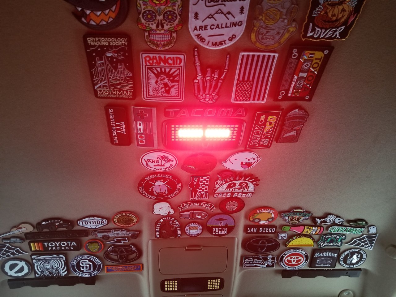

    My dome pattern changes. This is about as good as it gets. Too bad. I really like the red for readin’ prints in the early Mornin’. Big savings on eye drops.

    The bottom two left leds stay dimly lit after the dome light goes off. Quality control seems to be a big issue with this many people having similar issues.

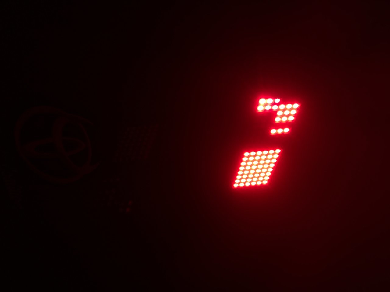

    If anyone is having these issues, double check the orientation of how you installed the Map lights. I installed mine perpendicular to how they should be (it was dark and obviously no lights in the truck were on). I flipped them 90 degrees and threw in a new fuse and definitely needed my eclipse glasses!

    Same thing happened to mine a while back dude. Shoot meso a note on here or his website. He’ll hook you up with a new led board. Swap is easy peasy
