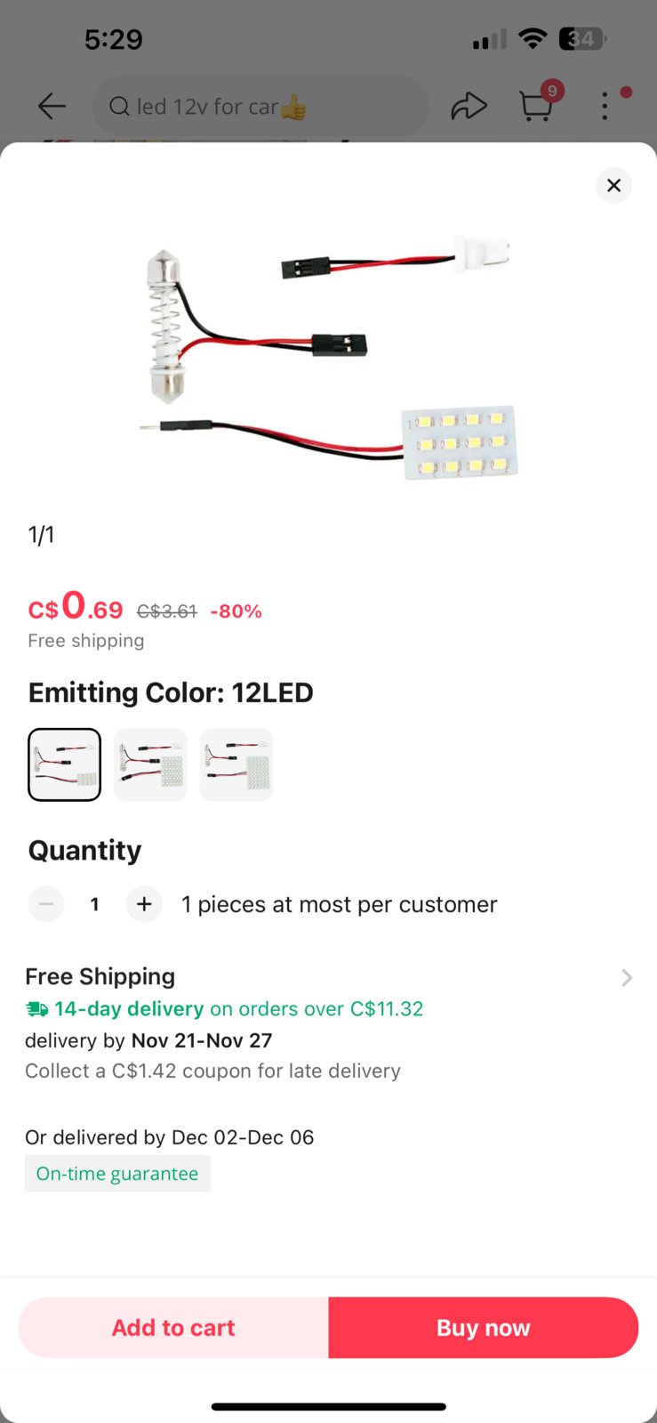

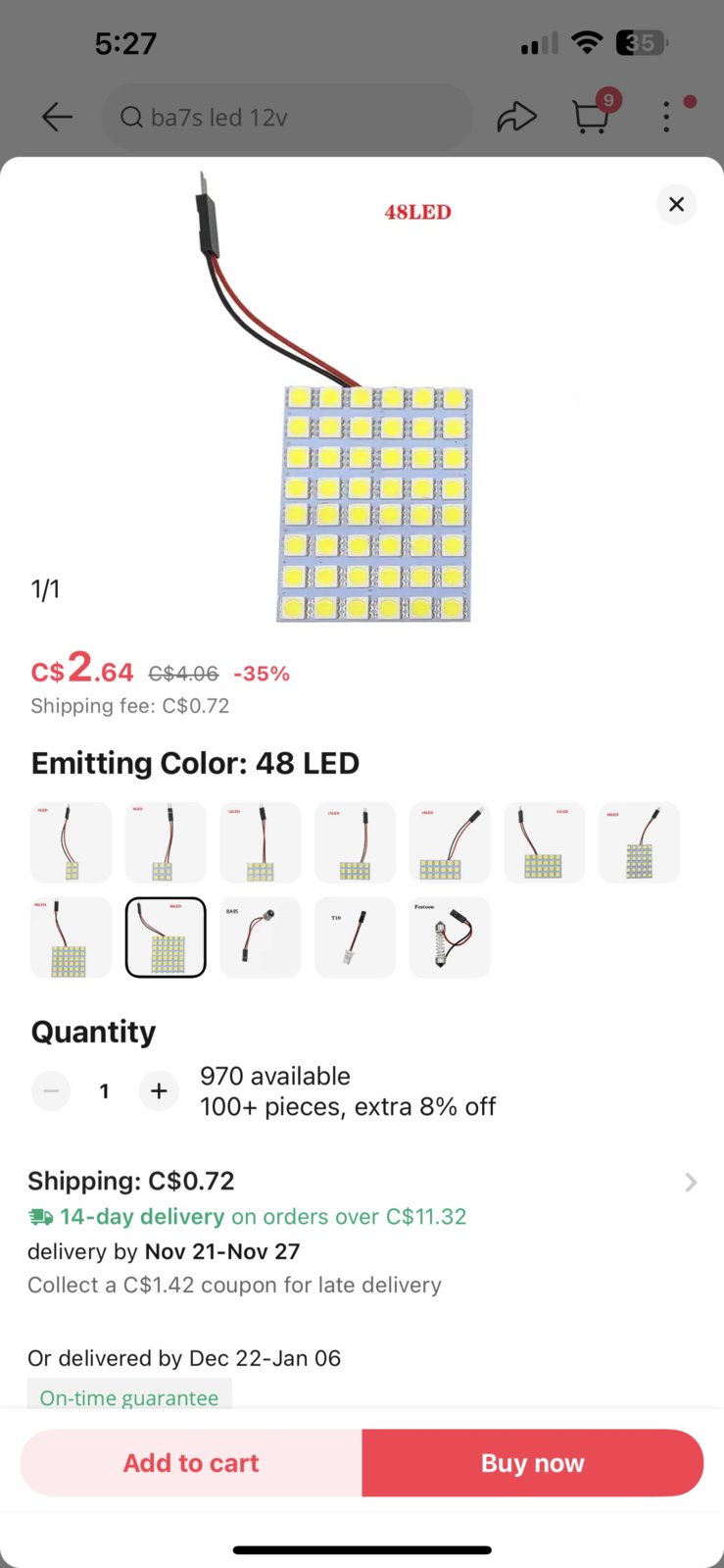

    Those leds seems to be the same ones you can buy off of eBay for a couple of dollars. You’re really paying for the mold.

    As long as they are the older style this is exactly correct. Anyone should be able to Google like 24 smd led panel and find what they need or whatever # LEDs are on the board. The newer ones where he had custom led panels made to fit the print might just have to be replaced by generic panels.
    To be honest the choice of connector they used for the 2nd gens sucks anyways, it’s not the correct festoon size, at least on the newer version dual red/white dome I have and I believe I bitched about it elsewhere.

    Even has the same “double sided” tape as the ones you would get off of eBay or AliExpress. Recognized them right away lol!
