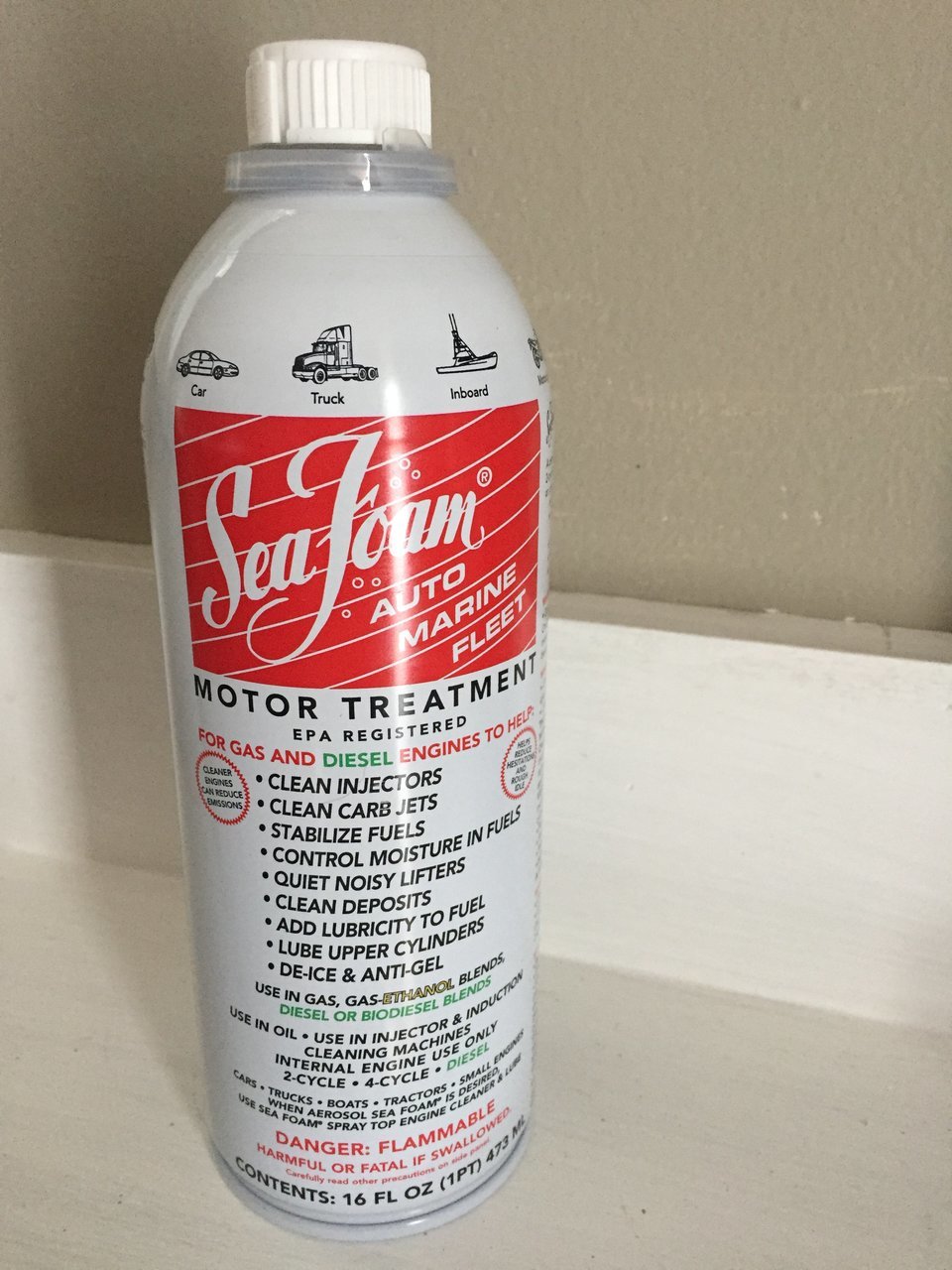

    So this just started . 2008 auto with 105xxx miles . Was my daily driver but I have not worked in a year so it sits more than it ever has but not enough to have old gas in it .When moving from D to P or D to R it stalls . Its also idling low . Im thinking the MAF sensor or build up in injectors ? Plugs new at 64000 .Any ideas ? Thanks

    Oh yea ,bought some Seafoam !Will try that at next fill up . Any other advice still welcome ! Thanks again.

    I bought some Sea foam and put it in my 2007 Toyota 4 runner and actually got 40 more miles to the tank last week.

    Thats good to know ! Seafoaming everything I own today ! Truck ,snowblower , generator, mowers , chainsaw :thumbsup: . :rofl:

    Added the Seafoam (1 1\2 cans ) filled her up only drove about 10 miles so far ,stalled in the driveway when I got home ,still doing it :annoyed:check my air filter thats good . At start up idles at around 1100 rpms put in in drive with foot on brake drops to 800rpms move to R or P and it stalls .:annoyed:?????
