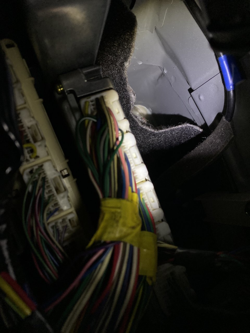

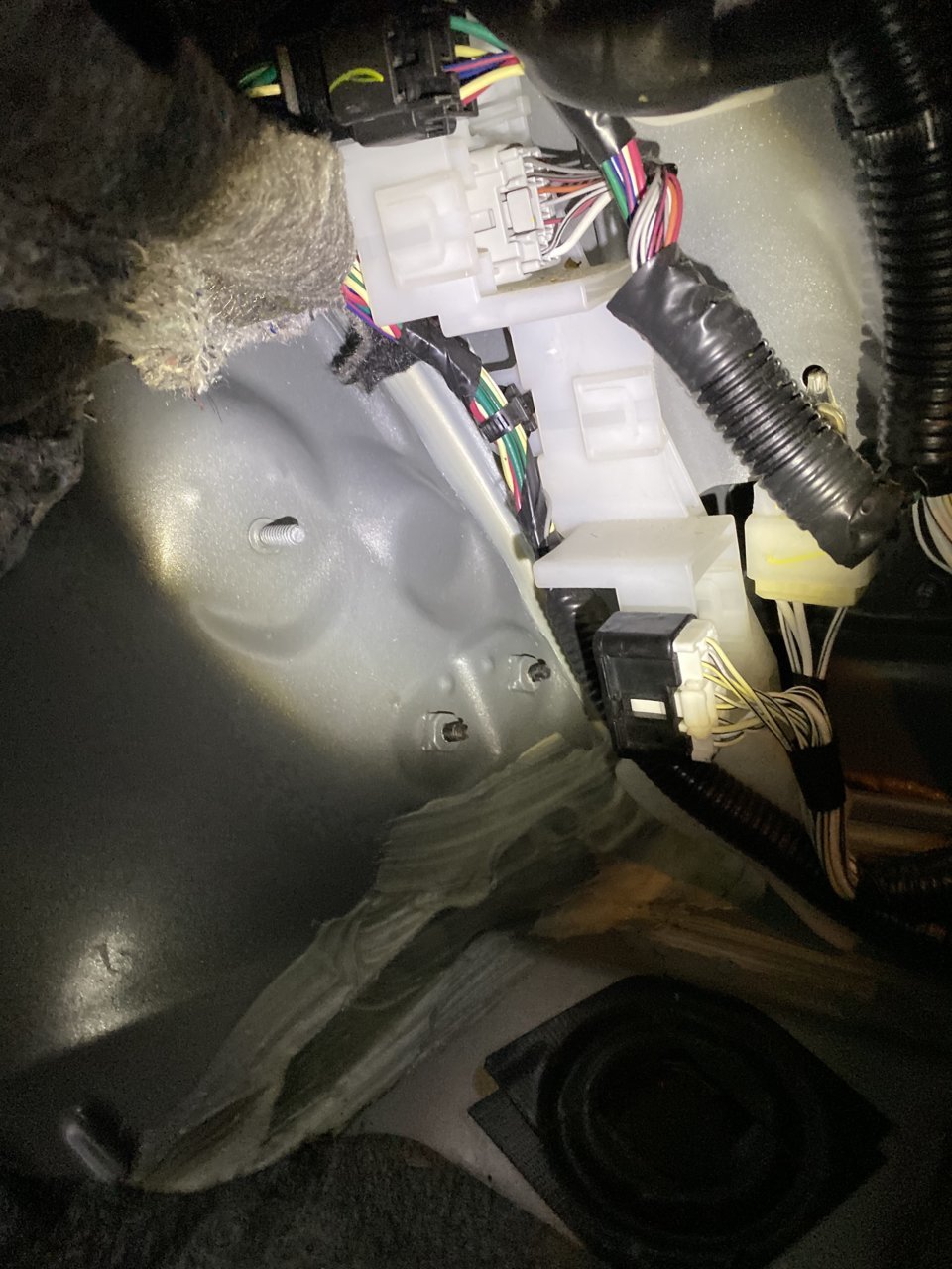

    Hey everyone,
    So long story short there’s a leak in my 2005 Tacoma that is causing water to build up on the passenger side floor.
    At first I had zero clue where it was coming from but finally traced the interior location of the leak. It is coming from the kick panel location from what seems to be a body seam when I look far enough inside.
    My question is where is the external location of this leak at this point. It comes trickling down the side of the kick panel wall behind all the electronics. Any advice would be greatly appreciated.

    Here is a TSB for that leak:
    The TSB will tell you where to look and how to fix the seam leak. It was a known issue on some 2005 Tacoma's.
    http://www.customtacos.com/tech.old/files/tsb/BO00405r-05-Leak.pdf

    Just got back from Canada a couple hours ago and the first throng I did was take apart the cowl, buy some 3M seam sealer and go to work lol.
    Its supposed to rain tomorrow so I guess we’ll find out then. Keeping my fingers crossed that this does the trick. If not, step two is too take the fender off and start checking all the inner fender seams as well. I will keep you posted!

    So it rained pretty good yesterday afternoon and today early morning. Typically after rain line that, I would have at least a small puddle of water under the passenger carpet.
    The results? So far so good! I was able to pat down the entire carpet and no water stains appeared due to water. Can’t thank you enough JimmyH. Even if it does return I know what the next steps are because of the TSB document you shared.:cheers:
