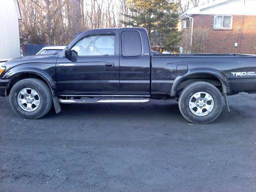

    This was the day I installed my 2nd generation wheels.
    Over the summer, I painted them black. Love the look, it's just a really crappy photo.
    Hope this is what you're looking for.
