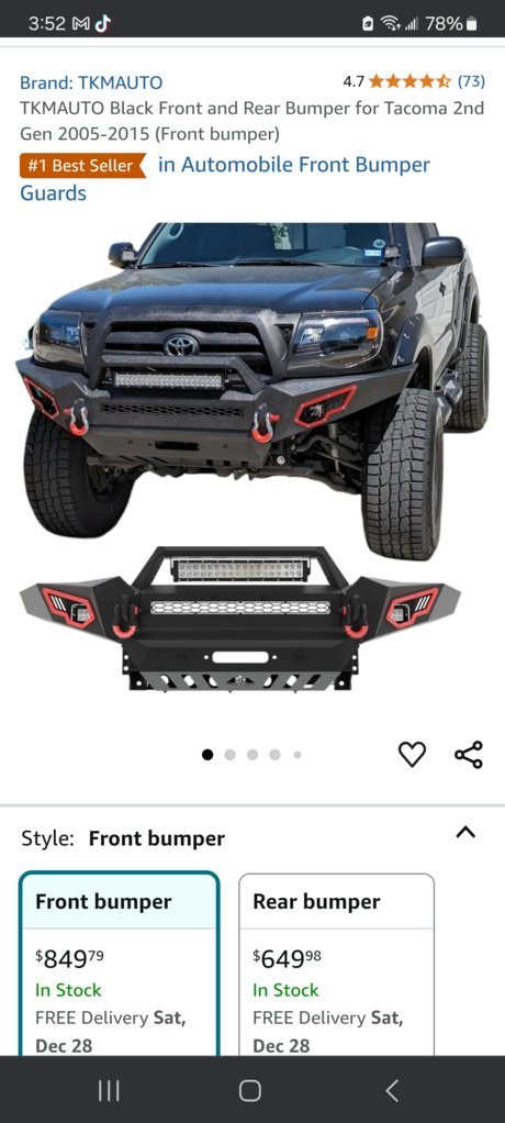

    @Arrowshot no it did not, it's a cheaper TKMAuto bumper from Amazon so it barely came with instructions lol
    I have zero experience with winches (other than quads) so I wasn't sure. Thanks for the input!

    Does it have a winch mount? Should be a plate located on the inside of the bumper with 4 holes.

    Link took me to a bunch of products but not bumper.

    @Arrowshot it has a plate and 4 holes for mounting a winch, as well as the cutout for the cable

    That is a nice looking bumper, not a monstrosity like ARB. Suggest a Warn 8000 winch although cheaper alternatives are out there. Main thing is to check fitment right away so if it doesnt fit well you can return it.

    ETA- Before you use those recovery points for anything other than decorations, make sure that they are properly installed. Most of the cheap bumpers seem to have shackle mounts that are welded to the bumper and do not actually tie back into the frame or have reinforcing sufficient for a basic single line pull, much less a hard pull. I have a cheap rear bumper because I needed to replace my bent up factory one; it has shackle mounts but they're essentially decorations, there is no way I'd actually use them to pull from. They are handy for securing a brake line for kayaks though. :rolleyes:

    Good stuff there. I almost got hit by a 20lb snatch tackle that broke its securing line. Hit the handles of a rake and shovel and broke them both even when they were just leanining against a tree. Know the limits on that bumper.

    I wouldn’t trust any Amazon special unless it was an ARB bumper since they sell through Amazon.
