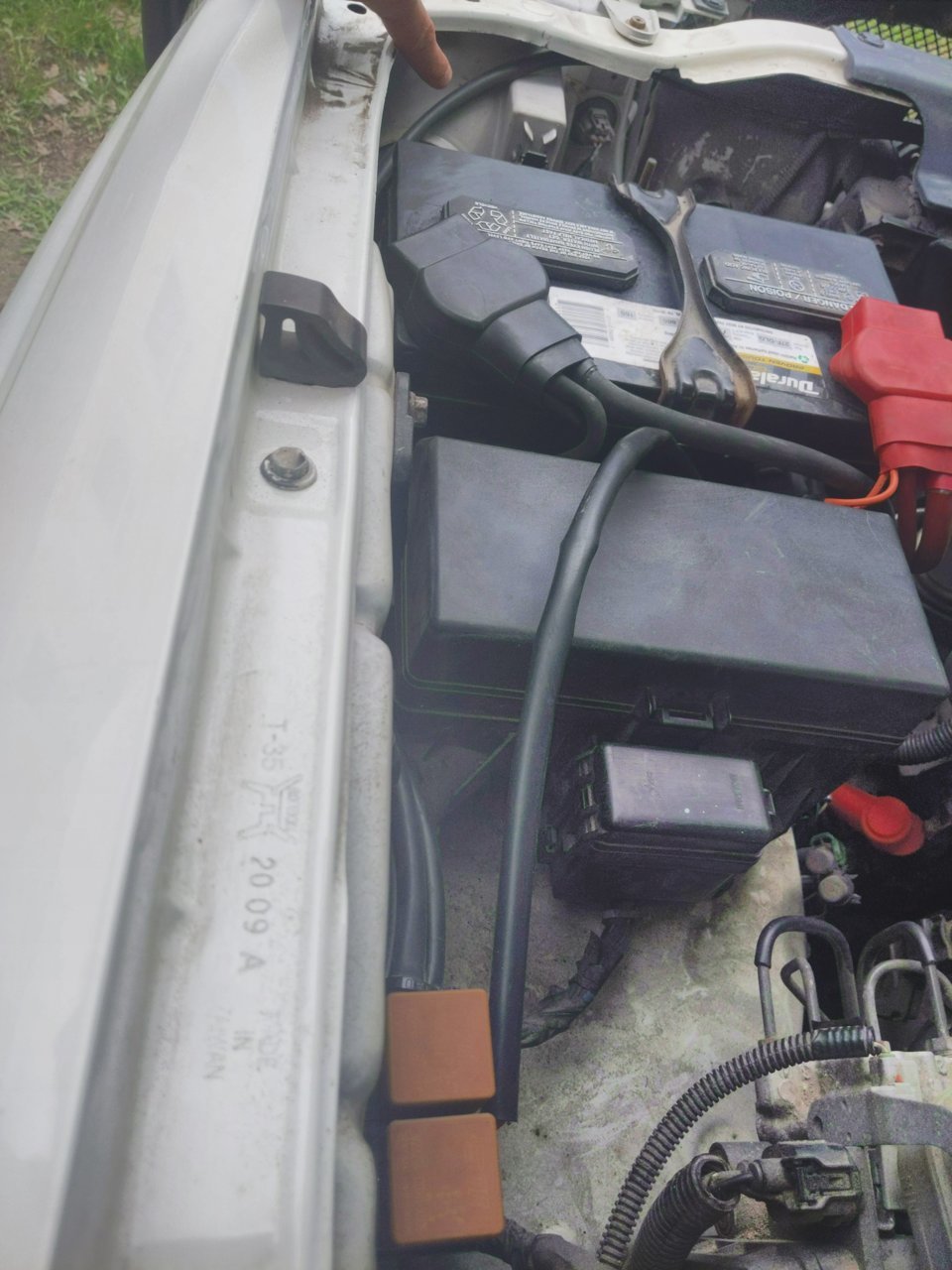

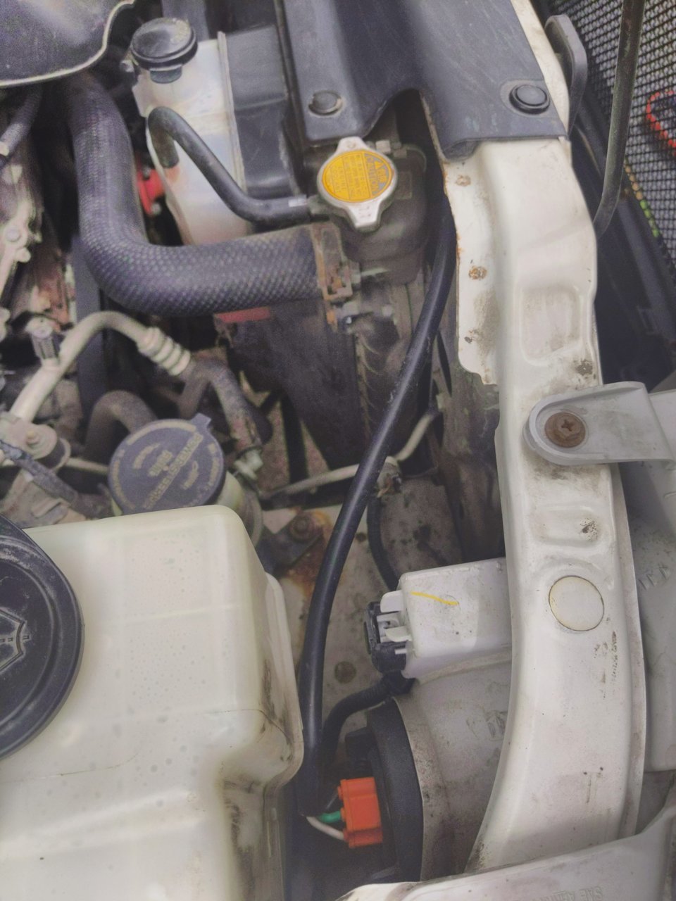

    I've got the relays mounted to the driver's side fender, with the negative and the headlight runs running around the factory fusebox and under the radiator cowl:

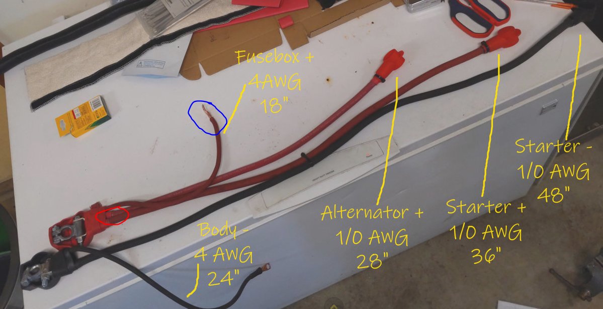

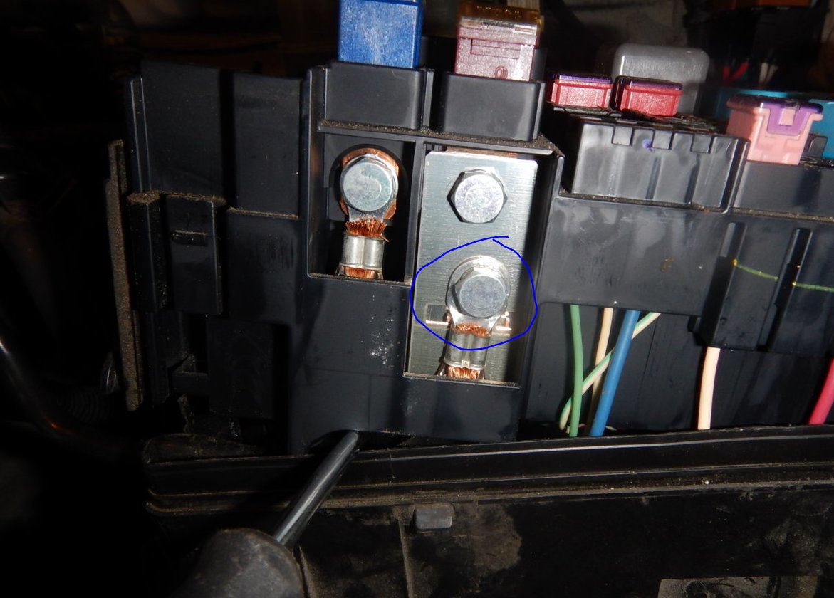

    @deanosaurus -
    Do you recall what size ring terminals everything needed? 3/8? 5/16?
    I'm trying to better understand what you did with the "2C" wire.
    In your original photo of the wire harness, you have the battery connecting to the alternator....is this incorrect based on your revised "2C" wiring?
    In other words. Should the Blue circled terminal below connect to the fuse box where I have the blue circle (photo 2)? And the red circle (that you have on the battery terminal in photo 1) actually connect where the red circle is in photo 3 (instead of the battery)?
    And then the Red circle
  11. Aug 20, 2021 at 9:26 AM
    #31
    deanosaurus
    deanosaurus [OP] Caveman
    Jul 23, 2018
    #260241
    2,150
    Northeast Region
    09 TRD OR AC
    I really should re-take these pictures, but I really don't want to gut the truck again until I have to.
    Short answer: Your pictures and color coded circles are correct.
    Long answer: please bear with me while I explain.

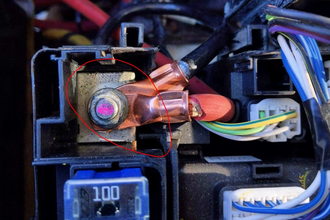

    Let's reference this picture here:
    The one labeled Alternator + is shown connected to the positive battery terminal. This is INCORRECT. Do not attach it to the battery terminal. Instead, attach it to the threaded stud inside the top of the fusebox (AKA 2E in Toyota reference material). This is where the factory alternator connection is. The factory alternator connection runs through a 130A (or 100A if you don't have the tow package/tow alternator) fuse, and then goes to the battery via 2C.
    In order to attach Alternator + to location 2E, you'll want to bend the lug 90 degrees. I stuck it in a bench vice and used just a little muscle to bend it after it was already soldered and crimped to the wire, then opened it up just a HAIR with a small round file. It slipped into place no problem.
    The wire labeled Fusebox + (AKA 2C), has one end connected to the positive battery terminal, and the other end you circled in blue goes to the location in the fusebox I showed you how to access with all the clips, where you have to remove the 10mm bolt and bend the little tabs.
    The end you have circled is the one that can be a 5/16 in order to not have to mess with a washer for a good fit. You can just as easily use 3/8 for everything to save parts ordering hassle, just use a small thin washer to help it fit underneath the stock bolt, which is what I did.
    For reference of the locations referenced above (2E, 2C) here is an abridged diagram:
    Does all that make sense?
