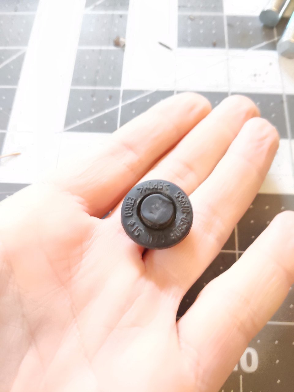

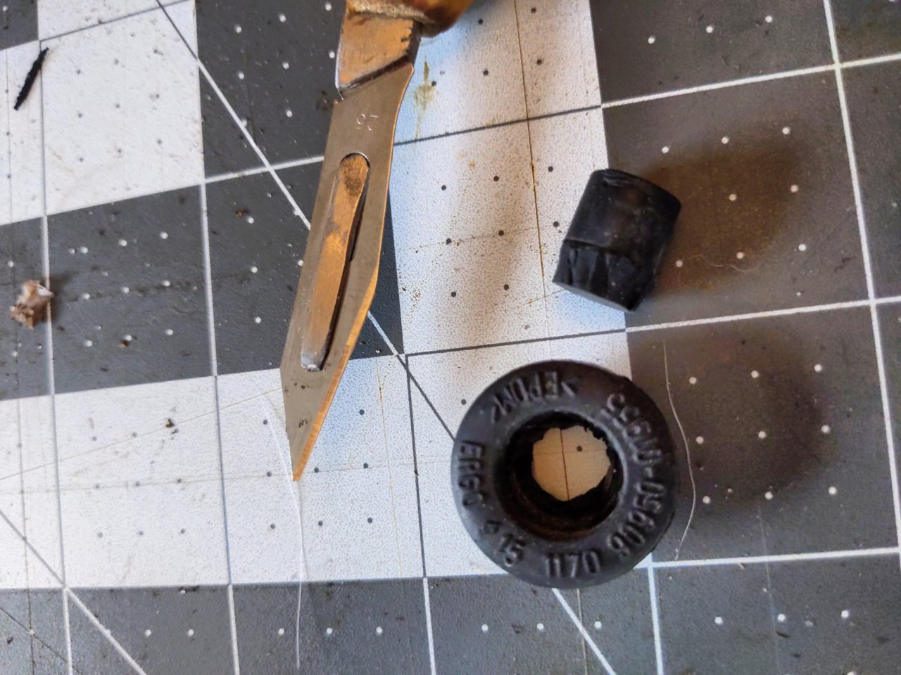

    Pretty sure it's just a plug for a manufacturing process manipulation hole, IIRC I ran my sub power wire through there with a grommet and significant FIPG 103.

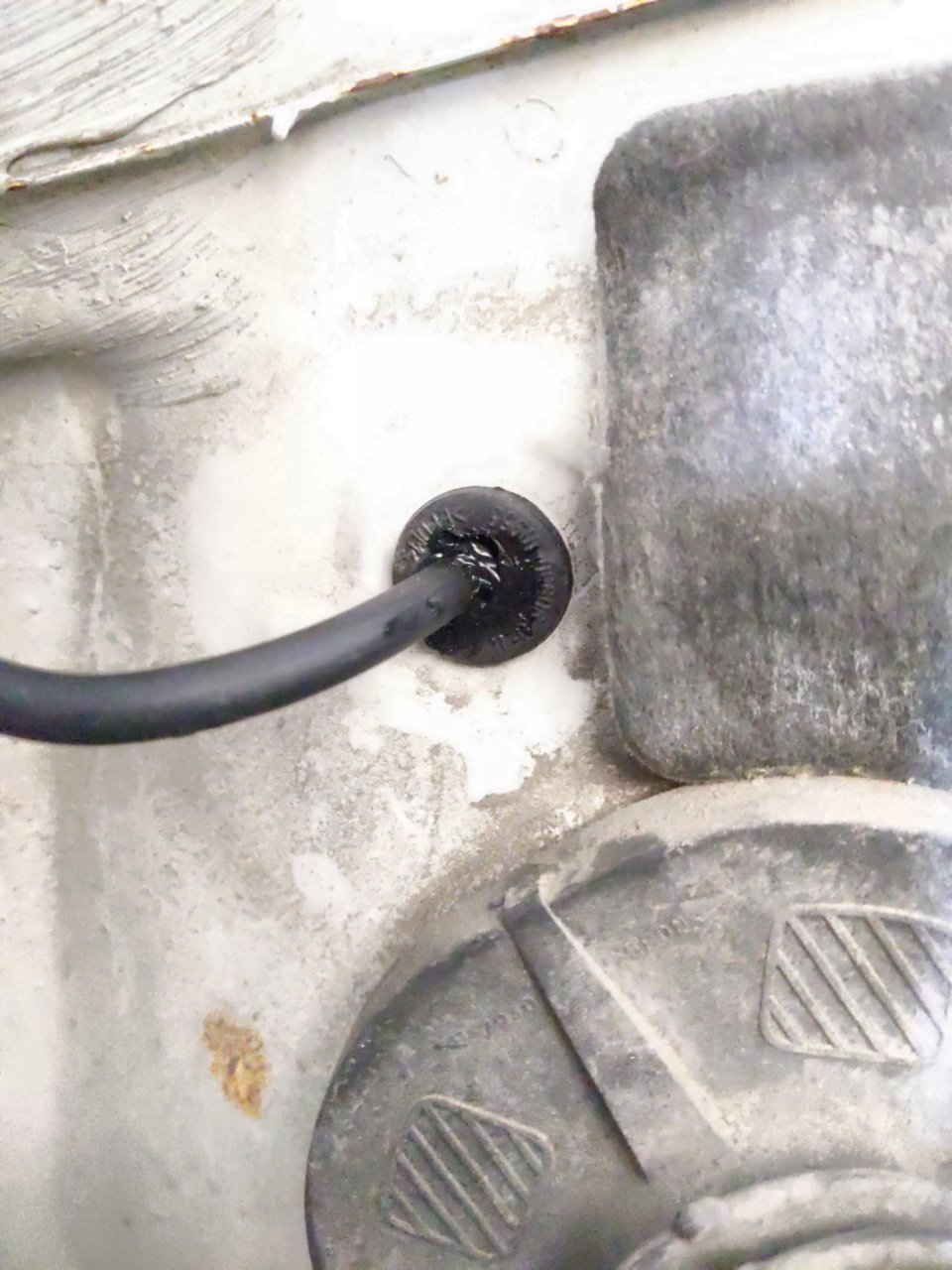

    That plug pulled out with a pair of pliers, and I was able to carefully cut the core of it out with a scalpel, preserving the exterior:
    I slit the fiber liner behind the hole, and used the modified plug and some RTV to run the cable. It dropped right down into the pax footwell:

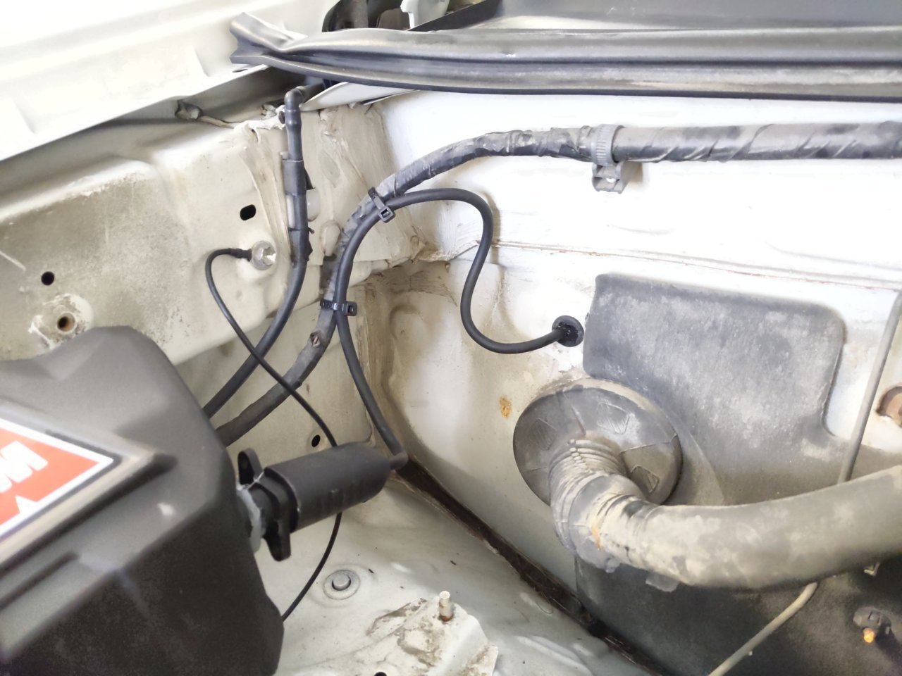

    My winch is a Warn EVO 10-S.
    The EVO line of winches uses neither the 3 or 5-pin winch standard. Instead, it has 4 pins.
    The wireless remote feature on the EVO series is handled by a wireless receiver which at first glance piggybacks onto the standard control scheme. The four pins from the remote cable, as well as a separate antenna, disappear into the receiver black box, which then connects to the contactors.
    I expected that one of the four pins would be +12v (red, bonded to 'hot' inside the winch with a Y junction leading from the hot line from the battery and leading up the remote wire and into the wireless receiver), one ground (the black one, bonded to ground the same as the +12v), and the other two, white and green would be signal wires to send +12v to the standard Albright contactor (yellow and blue from the receiver unit to the contactor).
    Instead, I got a really confusing set of voltages among those wires when I checked them with a meter (the white and green both came up to +6v simultaneously whether hitting the IN or OUT button). Jumping any combination of the bare wires together did nothing, except jumping red/black which produced sparks and the smell of danger ;).
    I contacted Warn, who had no pinout data available (strange) and the CSR mentioned that the remotes were "special" but didn't know anything more than that. A lot of head and ass scratching and failed research later, I broke out a pocket scope to go with the meter and dissected the guts.
    It turns out the EVO series remotes appear to operate digitally over the two signal wires, sending signals to the wireless receiver to close the contacts. Even dumber, if you cut ONLY the green wire, the remote still works fine in wired mode. I suspect that the cut ends of the green wire were essentially acting like antennae so the digital signal was still making it to the receiver box. Why did they go with four wires? The more I think about it, the more I think deliberate compatibility choices, whether for "safety" or because they make less on the EVO winches and want to make up the loss selling the new accessory line. There's also probably some nickel pinching going on with reducing the complexity of the remote and receiver wiring.
    Anyway, after some screwing around, I determined that if you cut the green and white wires off of the wireless receiver and Y them into the yellow and blue leads leading from the receiver to the contactor, you can operate the winch the same as you would a standard 3-wire setup (from the in-cab controls), except you get a bonus ground that runs into the cab along with the other 3 wires. I'll be using it as the ground for the indicator LED for the control panel arming switch on the in-cab control panel.
    Happily, the wireless function of the factory remote is preserved, so you can still winch from outside the truck if you need to. Some guys have had them for years on the factory batteries, which in the newest versions of this winch apparently use 3xAAAs, where they previously used some industrial cell that was difficult to source. We'll see if it holds up living in the truck or if the winter eats it.

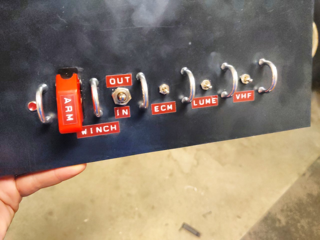

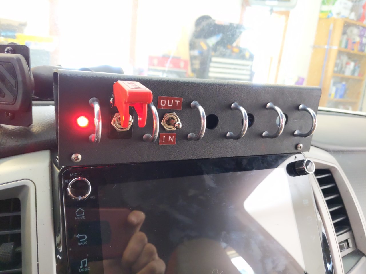

    Control panel finished. Just need to get the housing made and snake the cable through the dash and behind the head unit:

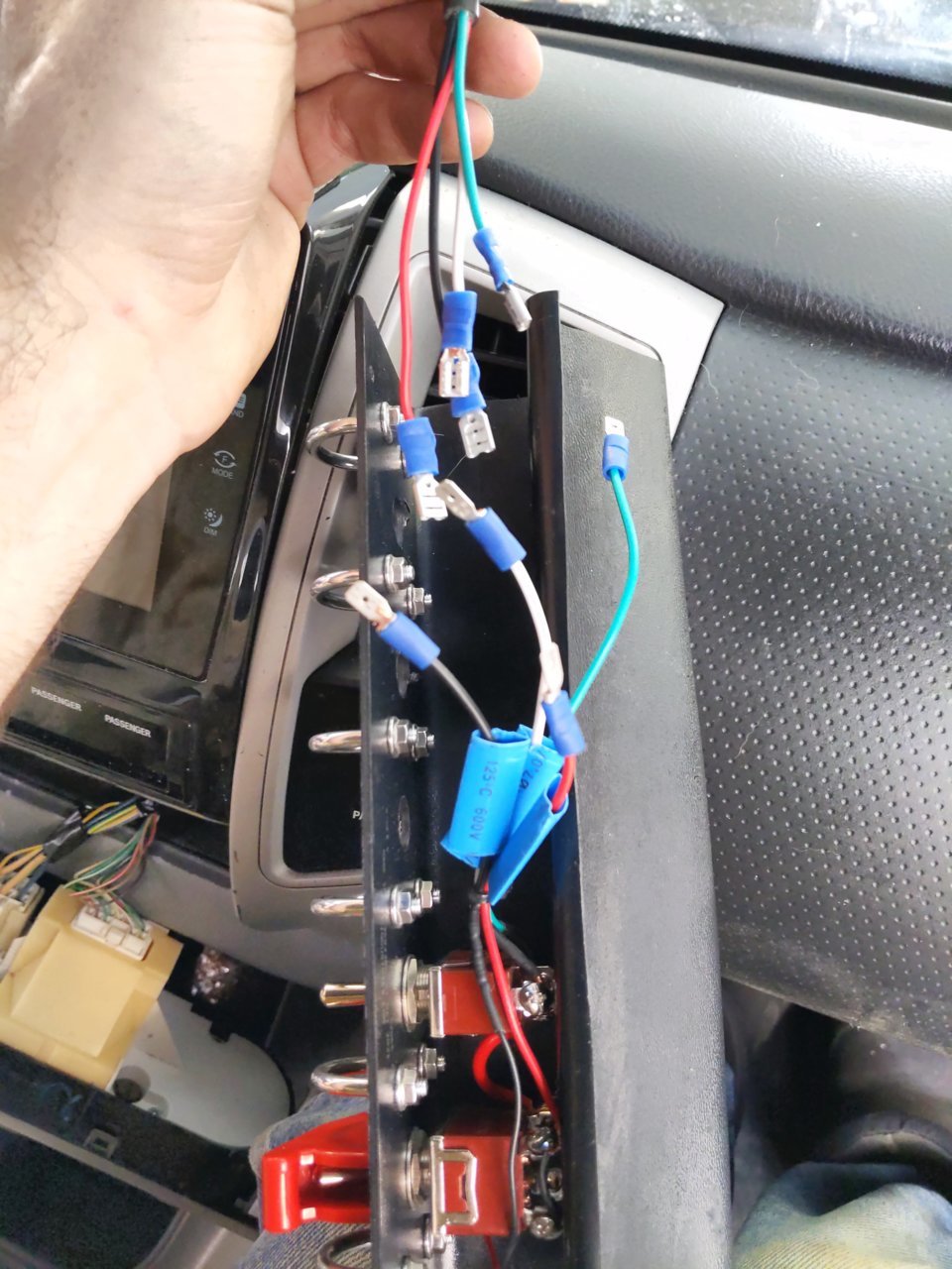

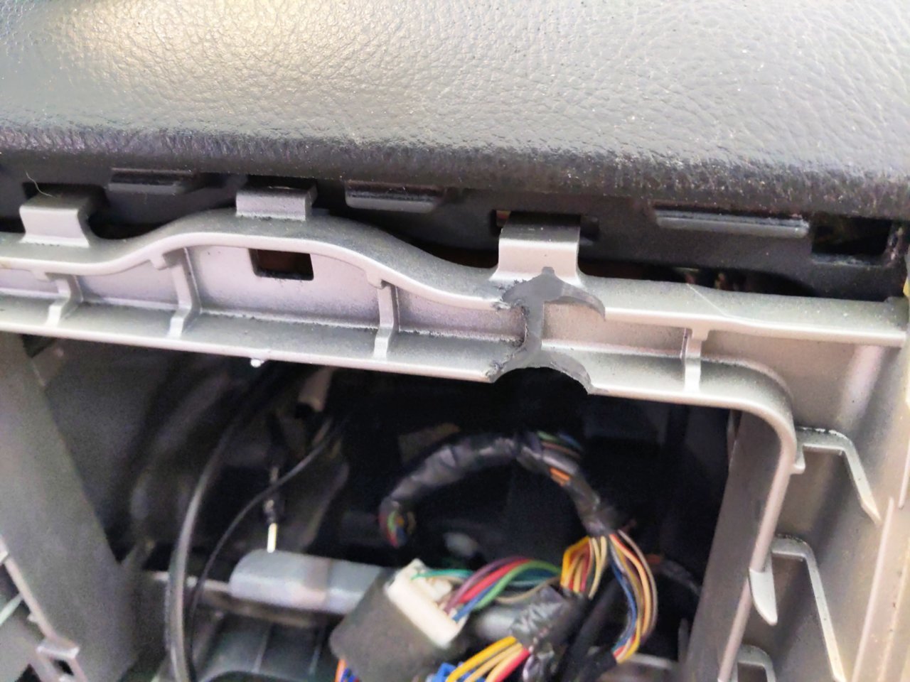

    OK. There is still some fitment tweaking, end caps for the housing to make, and switches in the mail, but I have basic install done:
    From my line of sight everything sits below the hood - in other words, I don't lose any visibility even though it looks hella tall on the dash in this pic.
    The wiring runs up through some slots I made in both the faceplate of my Joying head unit, and the interior plastic mounting plate for it. This pic also shows the screw tabs I made and attached to the head unit with VHB tape - the rear edge of the housing, once final fit is done to the curve of the dash, will get a line of VHB tape as well:

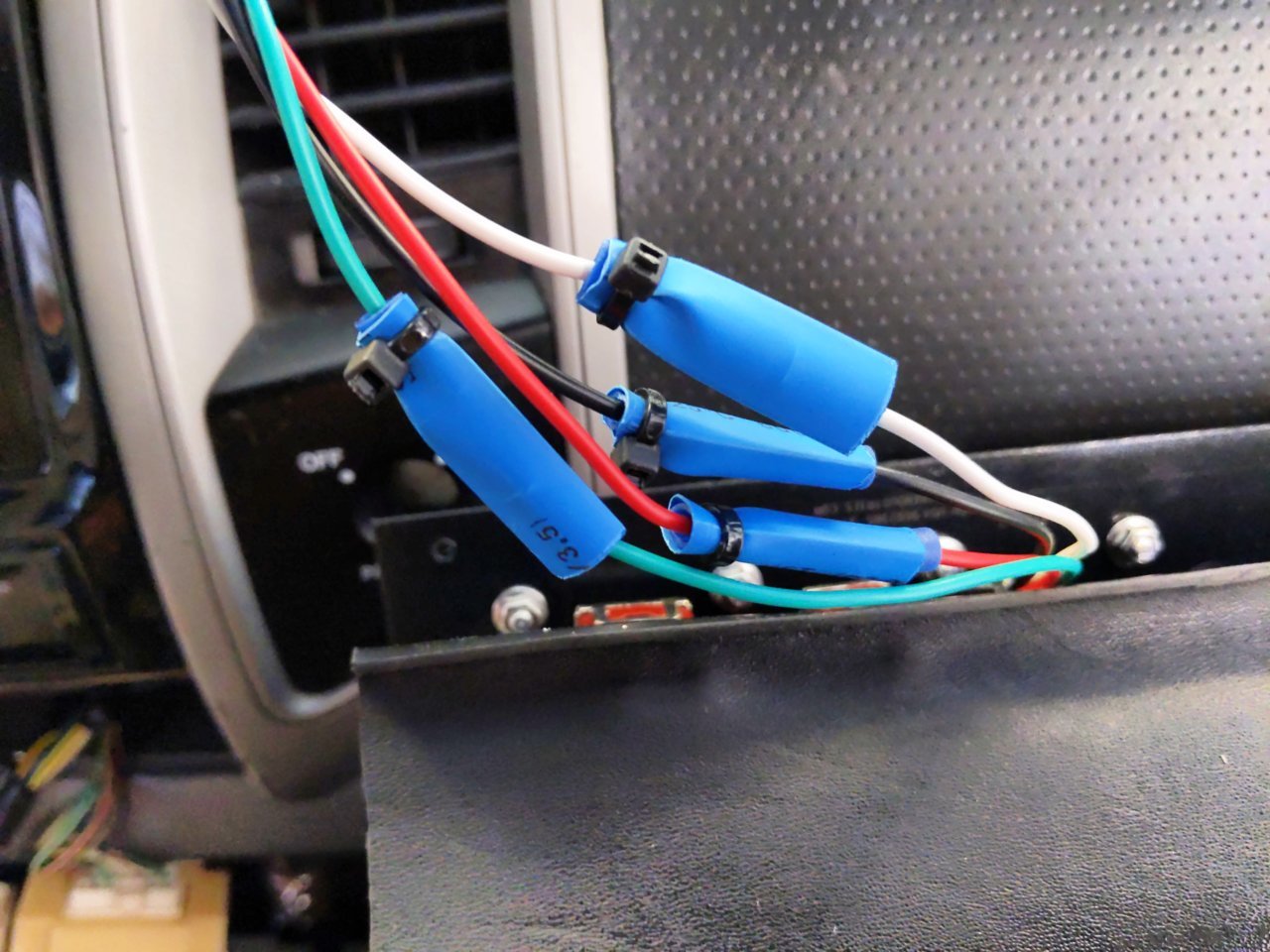

    The wiring was done with 3/16" quick discos. I didn't have any insulated terminals so I zipped on some un-shrunk heatshrink:
    The parts in the mail are SPST toggles with amber LEDs on the tips - they will be used for light bar, VHF, and scene lights (eventually).

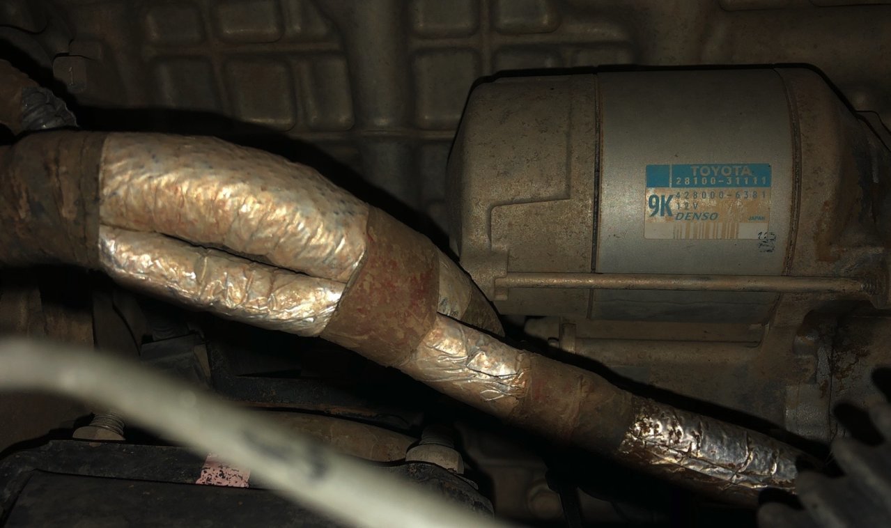

    Bought your Big 3 kit and finally got around to installing it on my 2015. I noticed the addition of heat shield around some of the wiring so I'd like to go with that. I can find it on Amazon but I have no idea on what width to get.
    Anybody replace theirs or got any ideas?
    ETA:
    So I took a piece of zip tie and wrapped it around. The smaller single wire is 3" around and the two together is 5". Brain Fart :anonymous: My new cables will be thicker. I'm still trying to figure out what size to get.

    When I upgraded to 1/0 wiring I think I got the 3/4inch stuff, was a little loose on the wire but just tapped the ends and called it good. Idk what gauge you're running there
