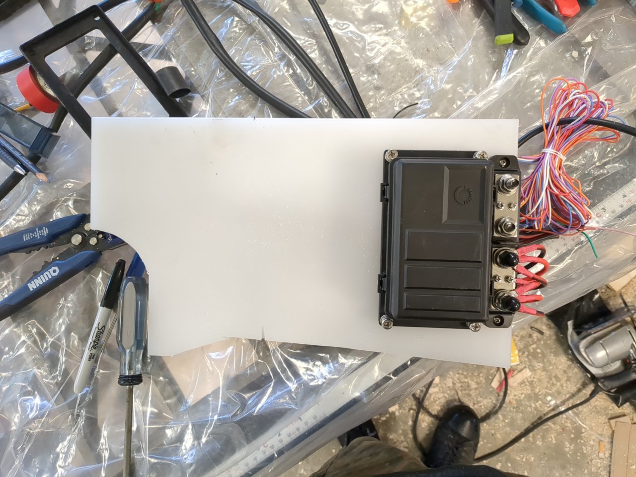

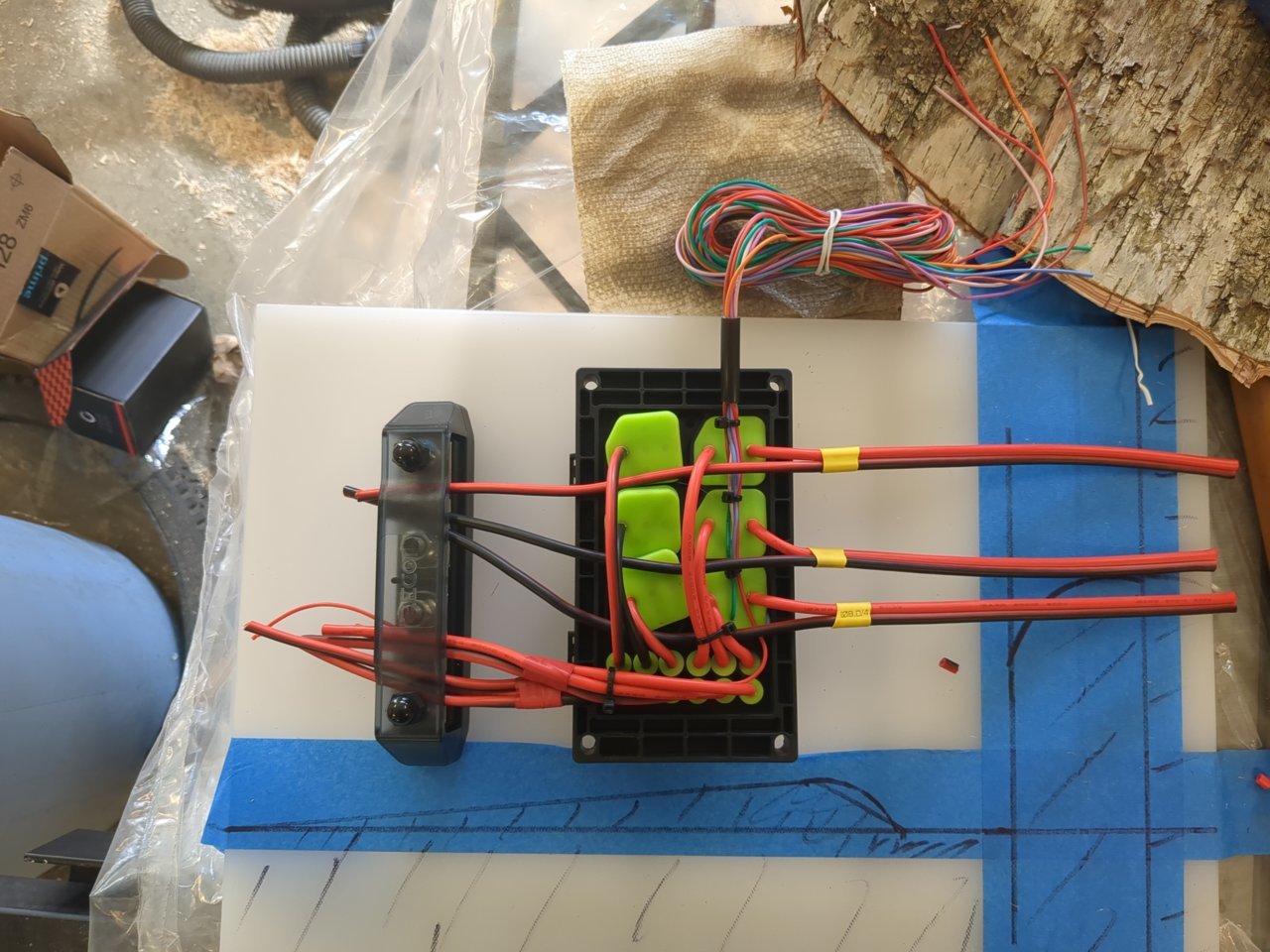

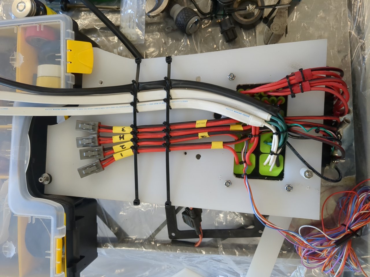

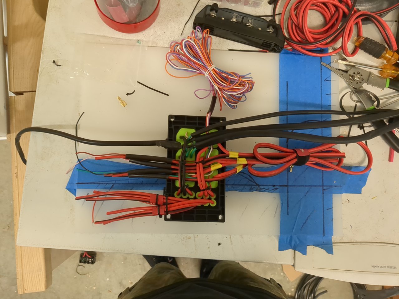

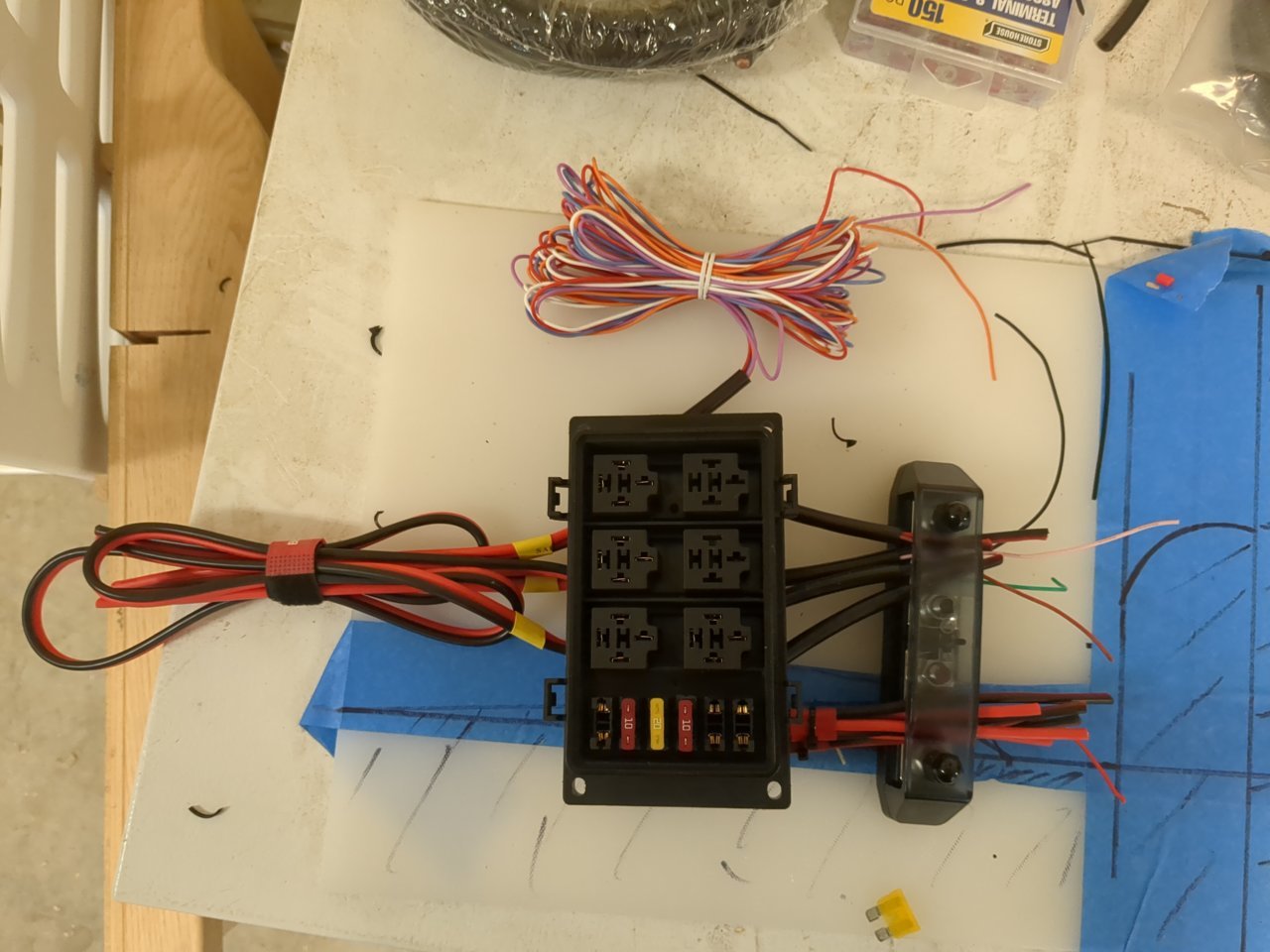

    The time has finally come to clean up and consolidate the mod wiring.
    I'm going to be dropping in some new lights soon, and as I was pondering how best to run them, I realized that I had a lot of onesies and twosies snaked wherever was convenient, and that adding more to it would have pushed me dangerously close to rat's nest territory, even with military terminals.
    I agonized over how to do it for a while and settled on the passenger side fender. Since this is a TRDOR that space was clear from the factory, and was only hosting my winch controller like so. I figured with a little bit of planning, I could mount an aux panel, bus bar, and the winch box all on that fender.
    Here's the (almost) finished product first:
    My in cab control panel (seen in this post) currently has a winch arming switch (12v cutout) with LED "armed" indicator, and a dpdt momentary for winch in/out. This winch control circuit is fed 12v by the winch via the control box. I want to keep the winch controls independent of the other three switches on the cab control panel, so I can disconnect the winch at the battery and maintain function of the remaining accessories. So, the 3 pairs for the in-cab relay switches will be joined by an independent +12v fed from the bus bar.
    The bus bar will be fed by 4AWG runs directly from the battery+ and battery-, run along the top of the firewall. This is way the hell more than big enough for the devices that will be in this circuit but I have it (and the appropriate lugs) on hand, and it looks hella cool to have big wires.
    The six relays in the new aux panel will be powering a DD 18" lightbar, a pair of DD flush mounts (amber backlights linked to fogs, white floods linked to light bar), the relays for my Headlight Services harness, and the horn, with two empties ready for future dumbass stuff (probably chase lights and an ice cream truck PA).
    I thought about going with a Bussman setup but ultimately wanted to be able to use IceCube/Bosch-style relays because they're easier to source in a pinch and I have a pile of good Densos scavenged from the fusebox used for testing earlier in the thread.
    So, I picked up some 1/4" hdpe stock (cutting board, Ocean State Job Lot, $5) to mount everything to and got the routing and layout figured out. It's shown mirrored here, just because of how I traced everything on cardboard to fit the mounting plate. The next seven shots are a time lapse of me painstakingly populating the relay box with 12AWG tinned copper for everything except the signal wires, which get 22AWG:
    And here's the mounting panel rough cut and with the aux panel and busbar tentatively positioned, so I can dry-fit everything and figure out how, exactly, I'm going to mount it in the engine bay:

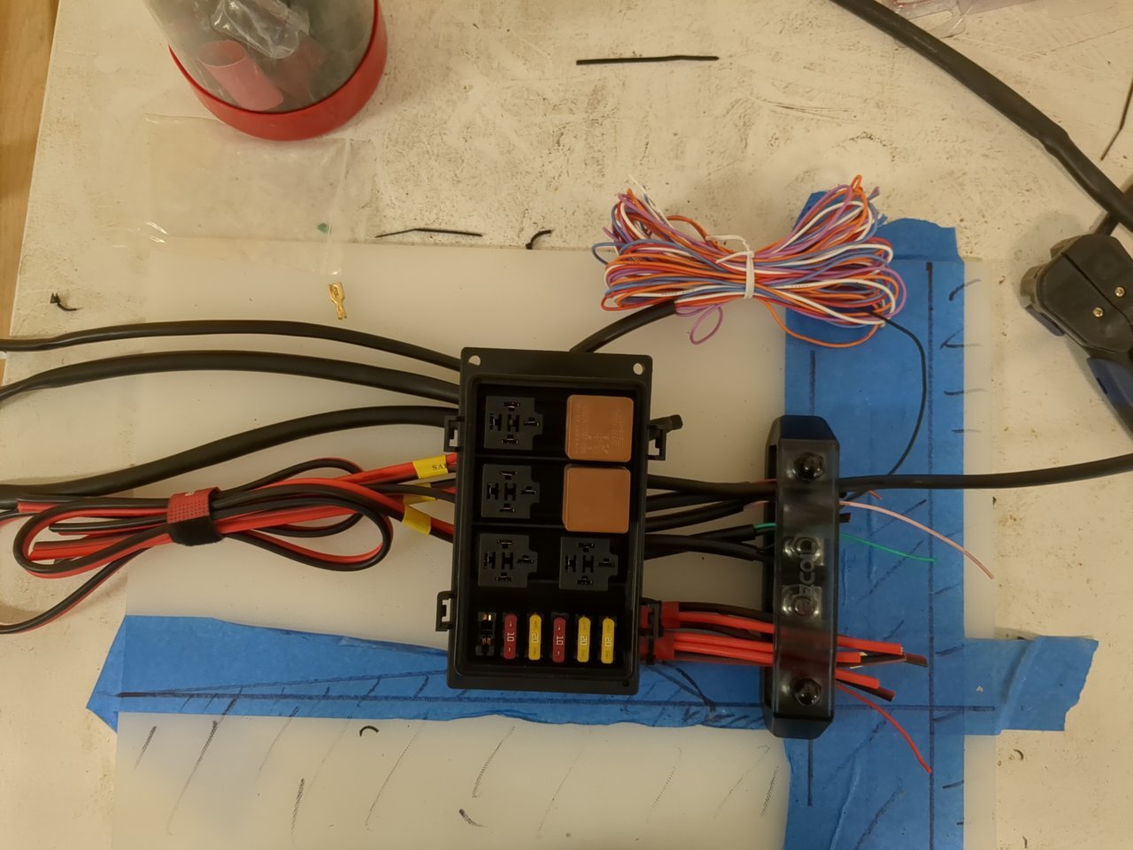

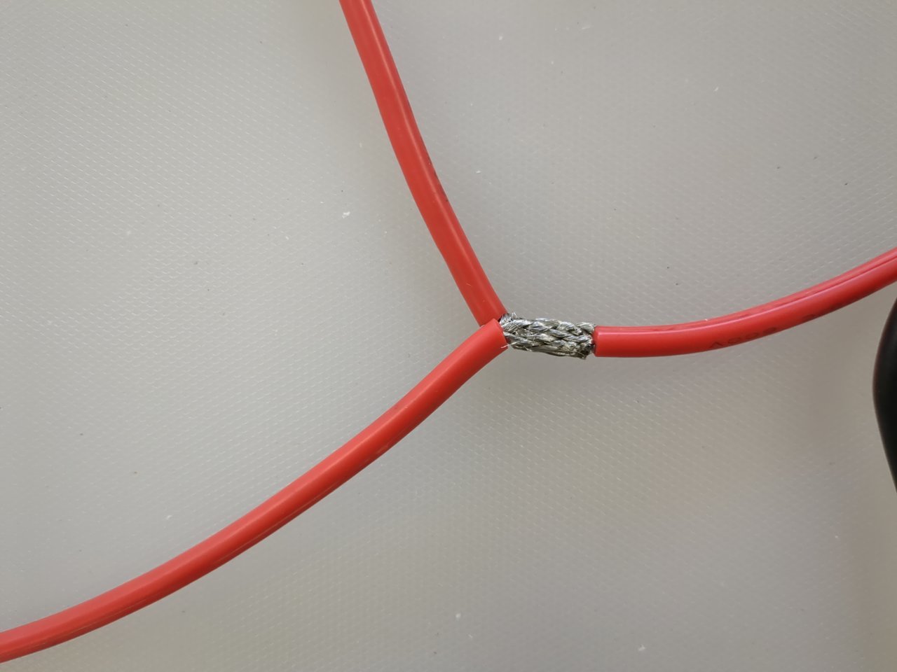

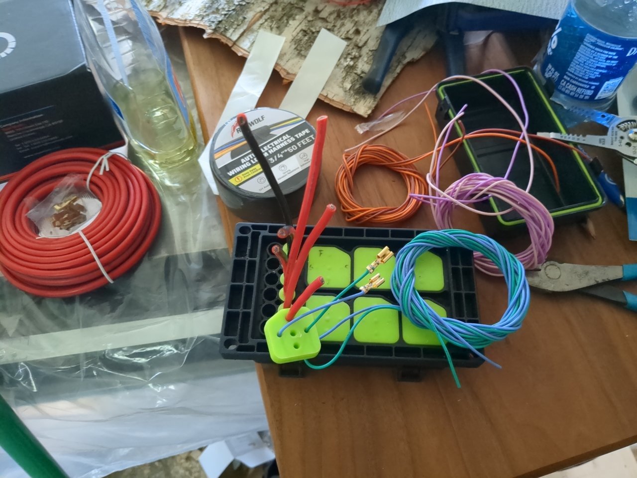

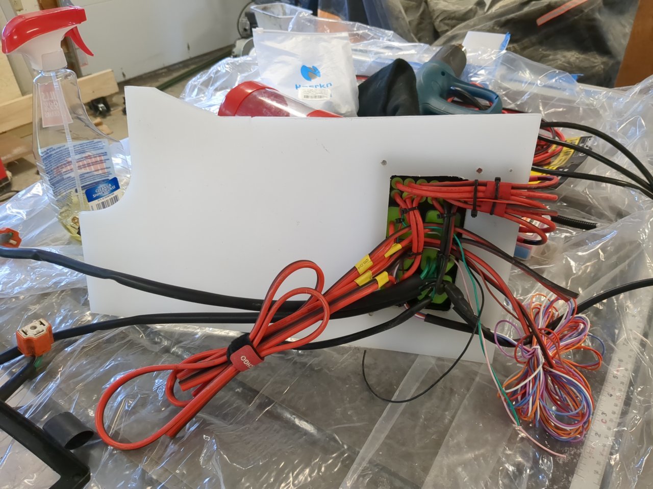

    When I chopped up the Headlight Services harness, I thought I would be able to basically completely re-use/preserve it. I ended up being just scant inches short of where the leads needed to go - basically, I forgot to account for the new mounting position being farther back than the original/manufacturer's intended configuration.
    After several days of wrestling with wiring, I needed a little bit of a mental break, so I decided to experiment with splicing techniques:

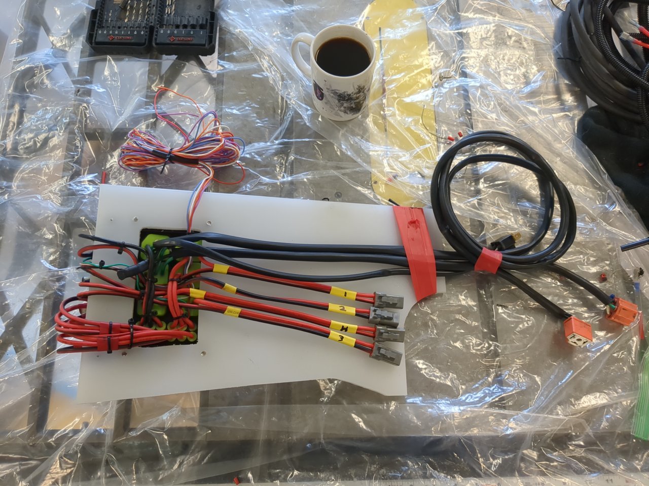

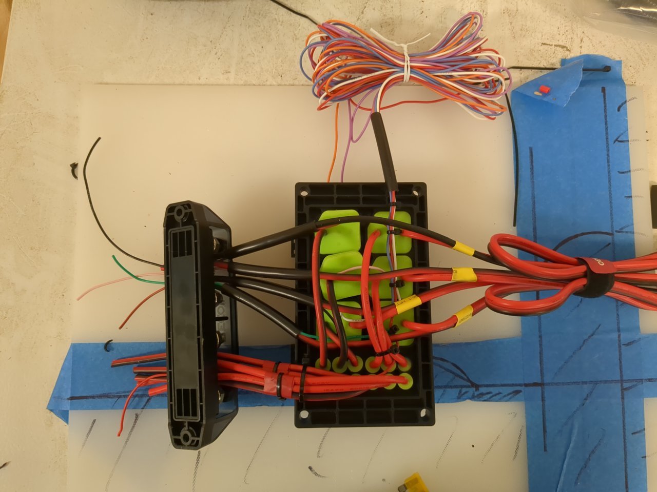

    After that little interlude, I got the DTP connectors put on the relay outputs, tidied up the underside wiring, and labeled everything:

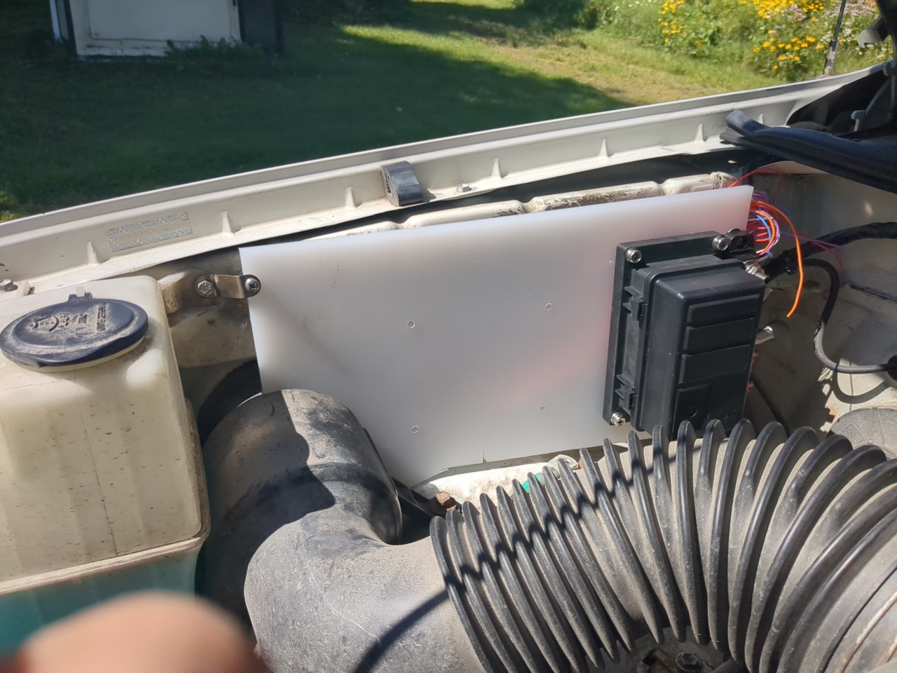

    Here it is after several rounds of wrestling/marking/trimming, in its final mounting position. What I ended up doing was using one of the M8 threaded holes on the fender towards the firewall (mirrored from the threaded holes where the stock fender ground attaches on the driver's side), and the washer fluid tank mount hole. There's a 30mm HDPE spacer on the rear of the panel, and I used a stainless "Z" type bracket from the spare parts bin for the front.:

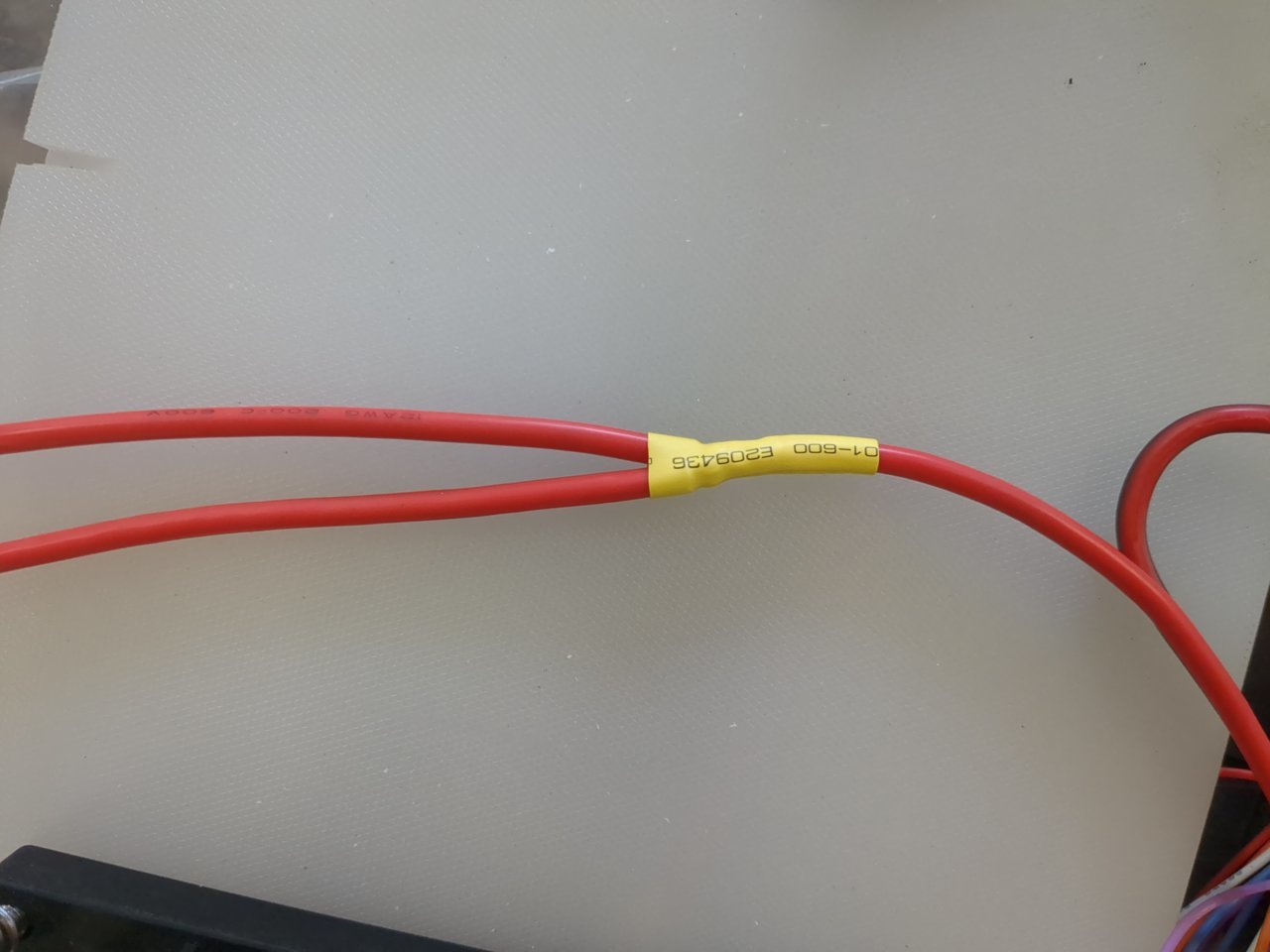

    There are a couple of skipped steps here. You'll notice the painstaking cable management, and also that the Headlight Services harness has been carefully spliced. I used Ancor Marine 12/3 for the powered runs, and 16AWG marine wire for the input plug (the one that connects to a stock headlight plug to signal the relays).
    I ended up using DTP 4 pin connectors with one pin blocked off to turn the old Headlight Services harness into pigtails that plug into the new aux harness (DT 3 pin for the 'input' plug).
    If you're not super familiar with the DT style connectors, pay attention to whether you need DT or DTP based on the wire gauge and amperage of whatever you're trying to be fancy with. If you're using 10-12 AWG you will need to use DTP connectors regardless - the larger pins will not fin in the DT shells.

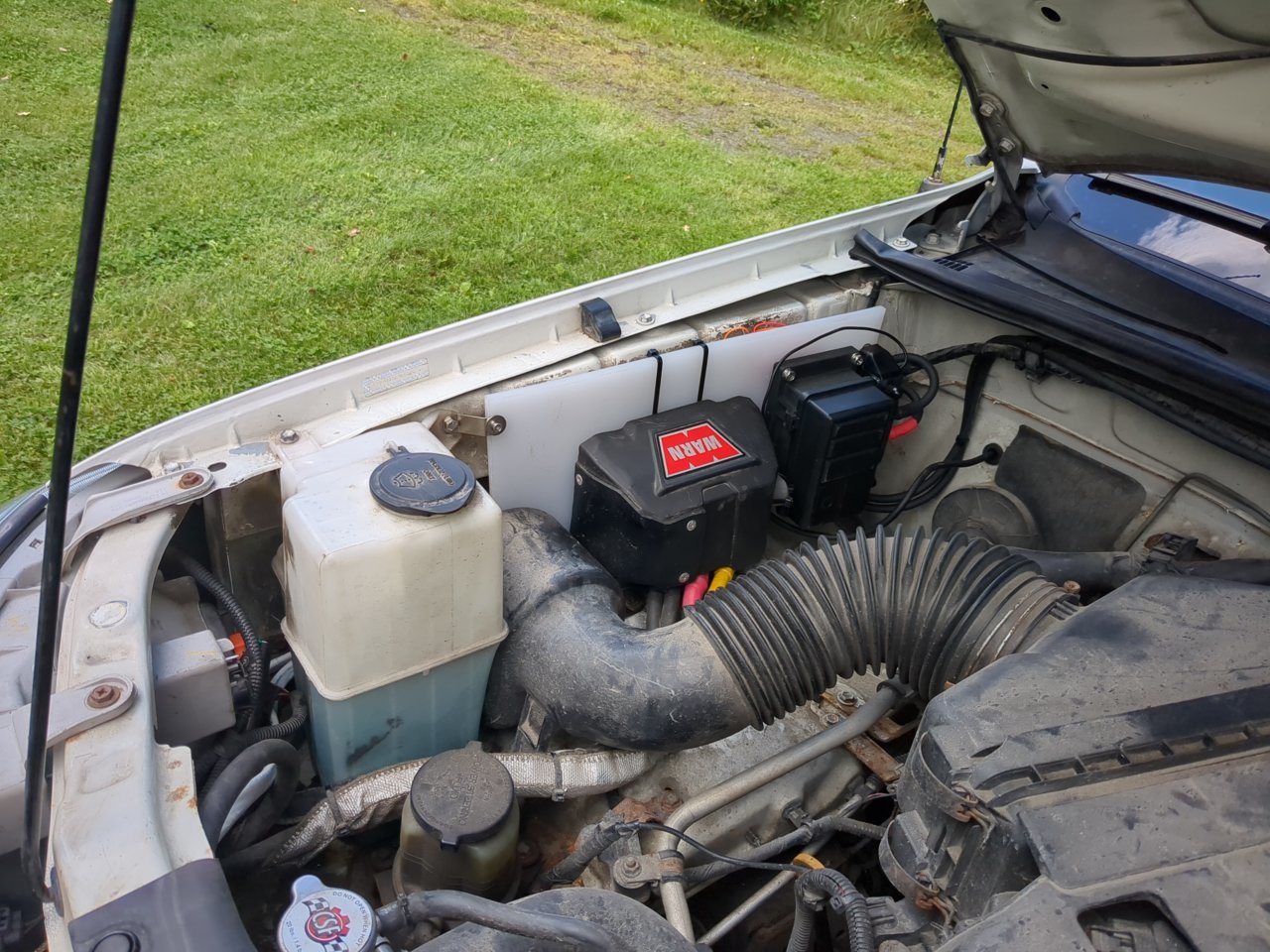

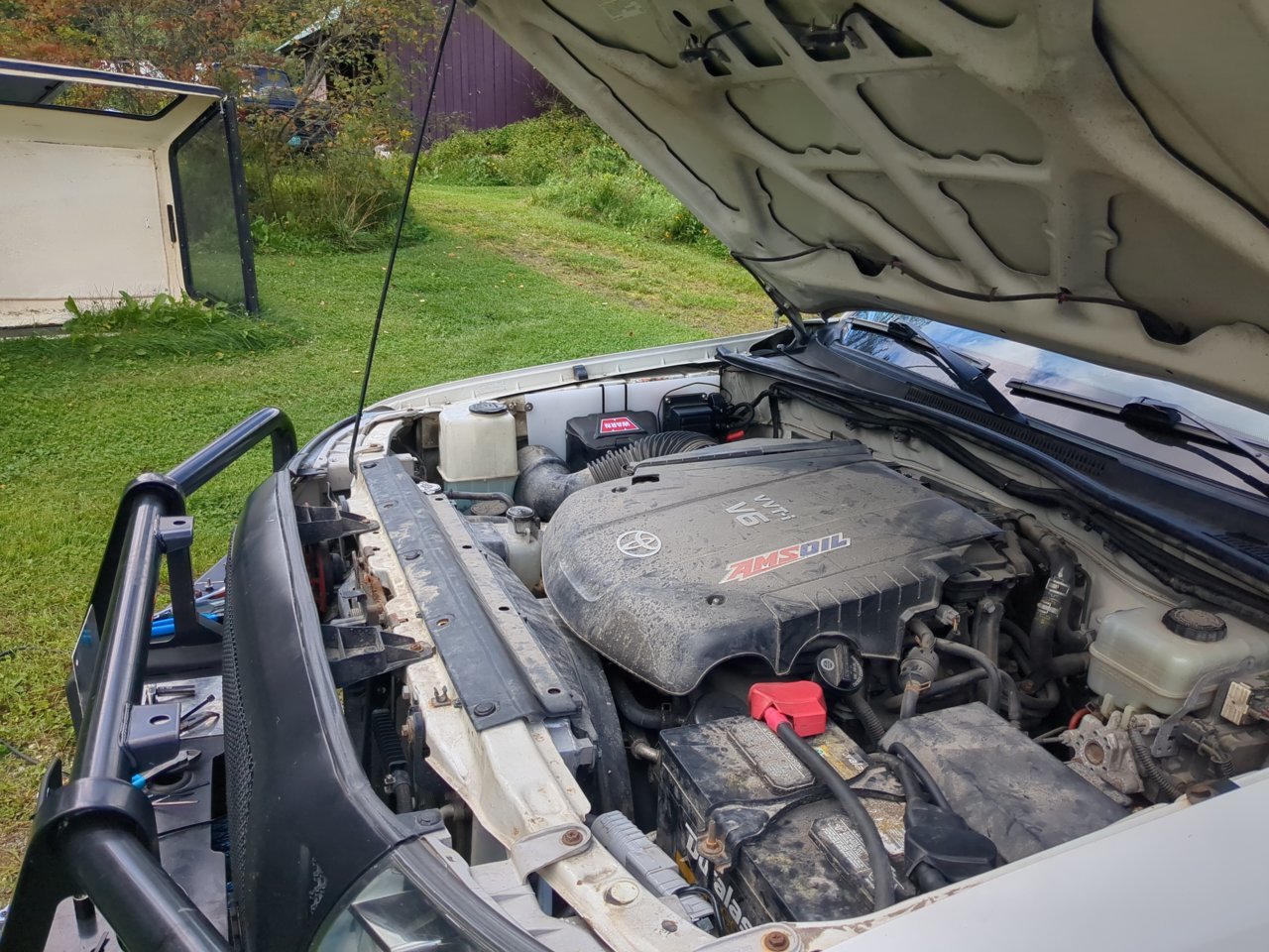

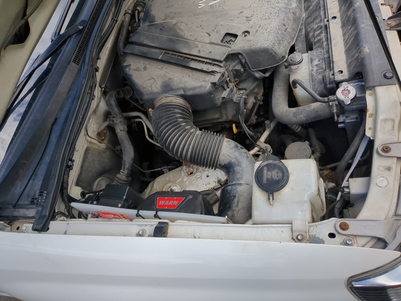

    Here are a couple shots of everything installed. The winch controller fits nicely. I ended up using a clip-on boot from the factory starter wiring to wrangle the winch control cable and winch control ground; when I finish running the new in-cab control bundle (multicolored bundle currently seen tucked behind the mounting panel) I'll get detail shots of that as well as the DT/DTP connectors.

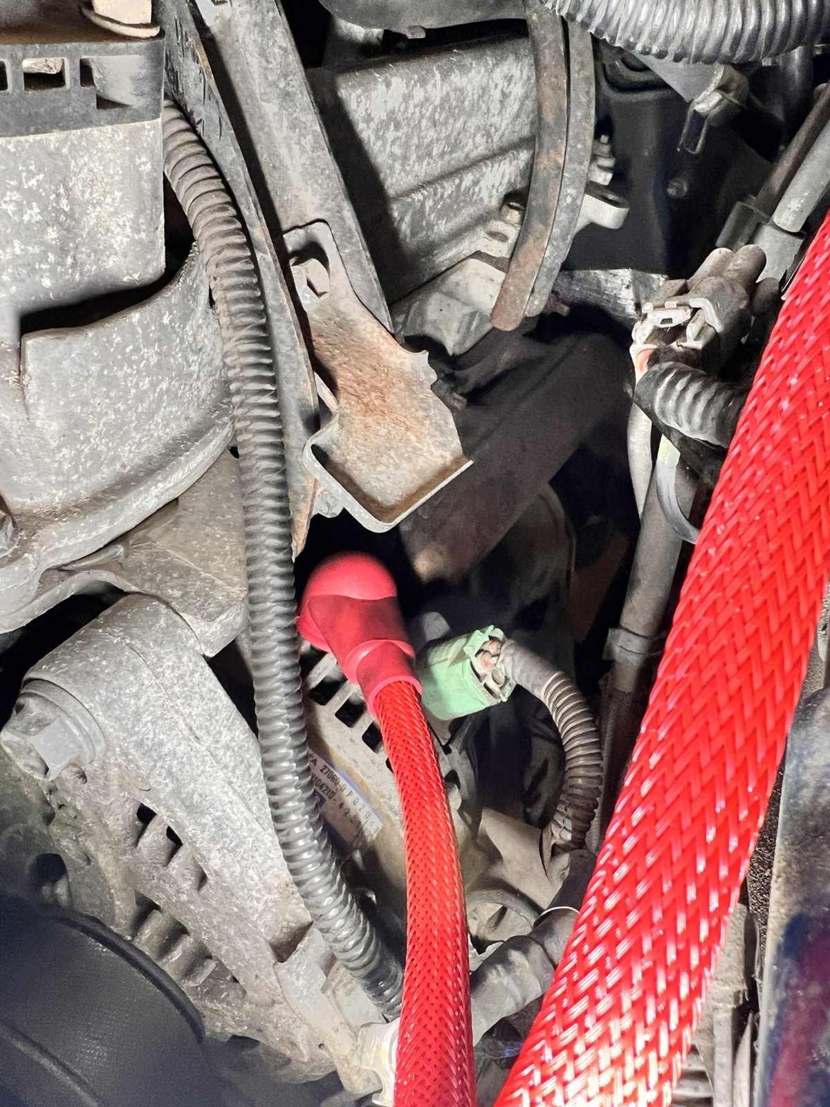

    You can also see in this next pic where I ran the 4AWG pair along the existing bundle on the back of the firewall.
    Overall I'm happy with it, but there are a few things I want to change next time I dig into it (which will be when my 3d printed switch panel arrives and I populate it).
    1) I want to replace the all-zipties loom job behind the mounting panel with some brackets made of HDPE offcuts,
    2) I want to change the way the bus bar is mounted,
    3) I don't distrust the silicone plugs on the back of the aux panel, but I would feel better about it if I put down some RTV - I'm thinking a thin, continuous layer of it applied to the entire back face of the aux panel,
    4) I want to loom up that Ancor 12/3 with some factory style ribbed black loom. I thought I had some that would fit, but did not,
    5) I want to bevel the mounting panel for a more finished look, and possibly throw on some black trim on the bottom edge to fill the gap between the bottom of the panel and the top of the fender curve.

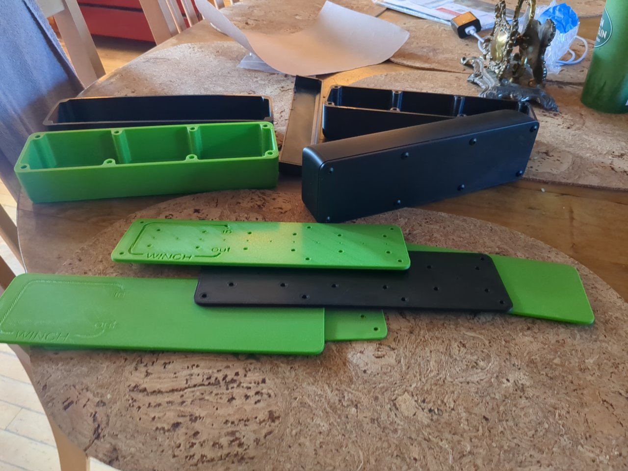

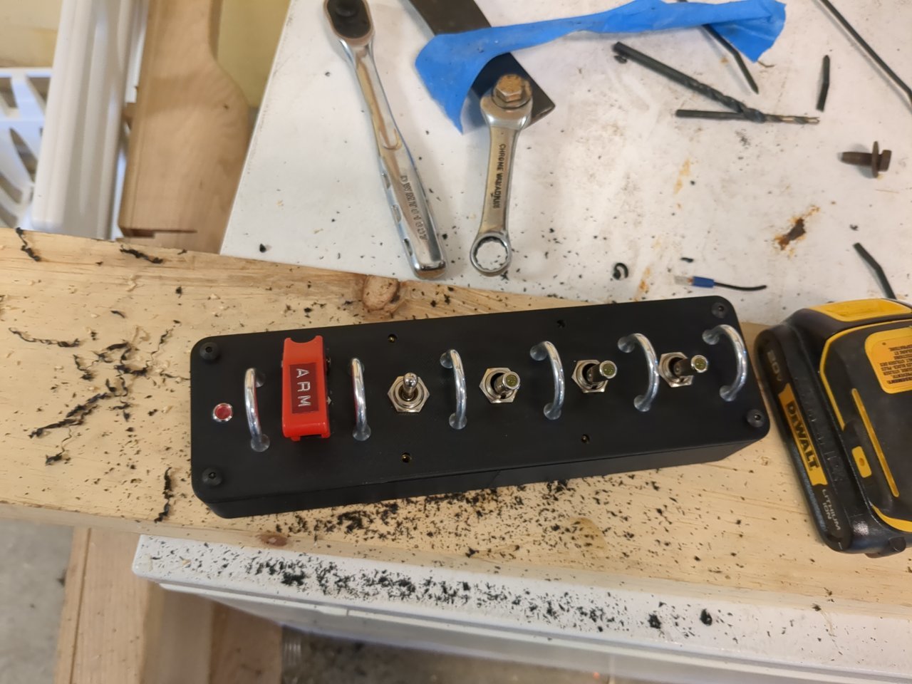

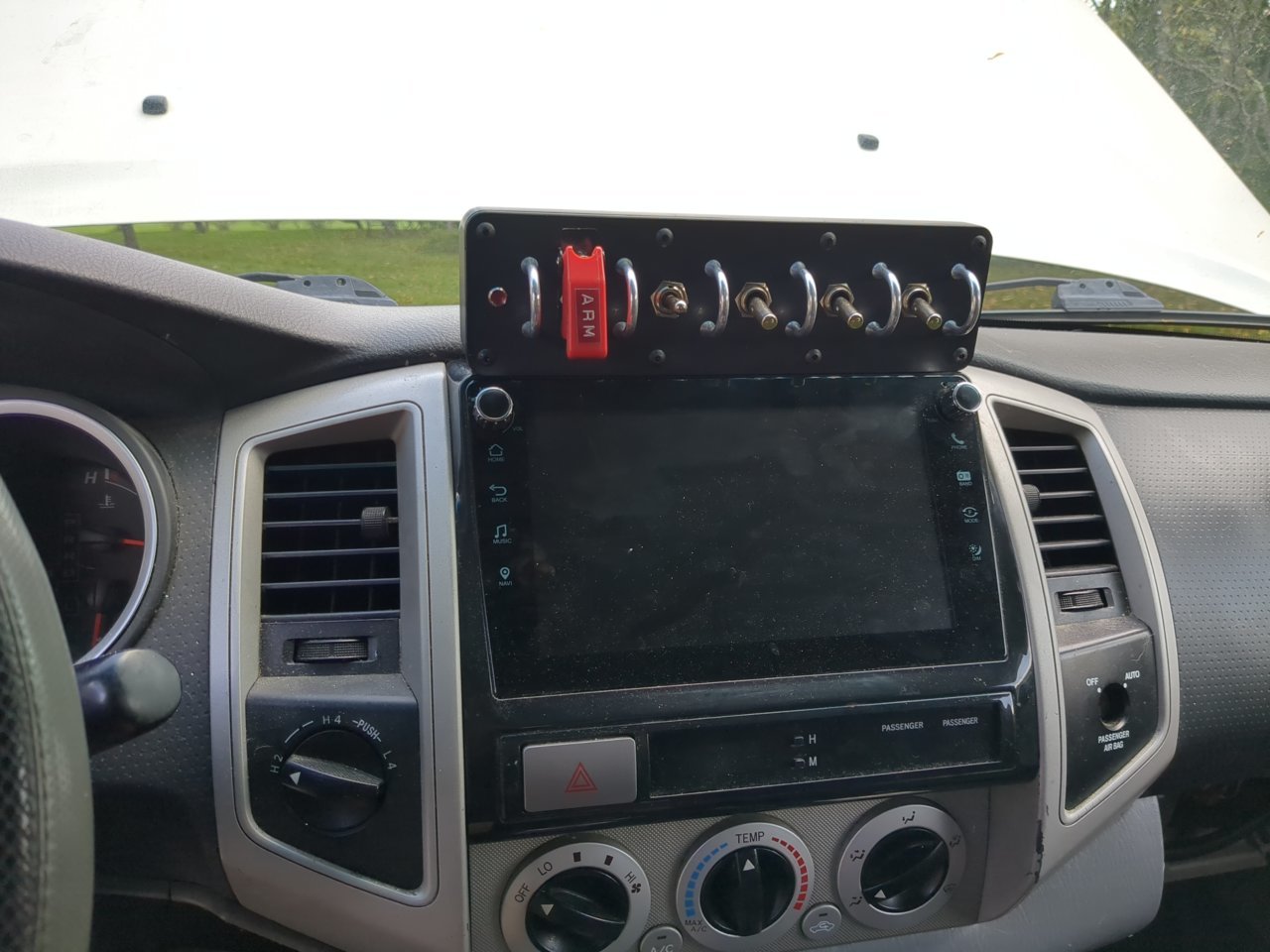

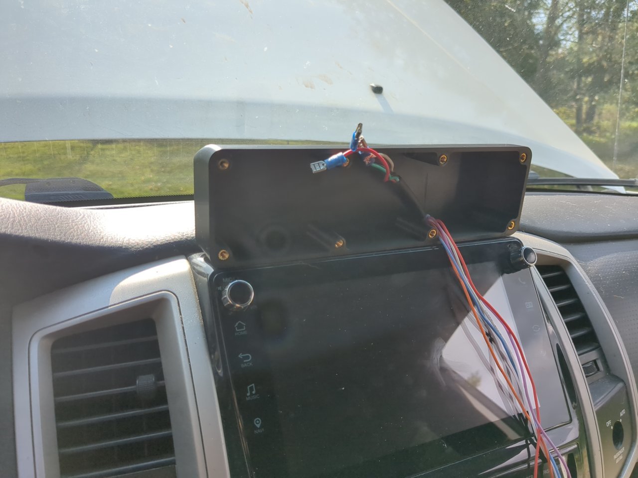

    Buddy of mine who is big into 3D printing visited a little while ago and offered to make me a switch housing to replace the janky folded thermoplastic. Here's the pile of test prints, design thoughts, curve gauges, and an initial prototype:

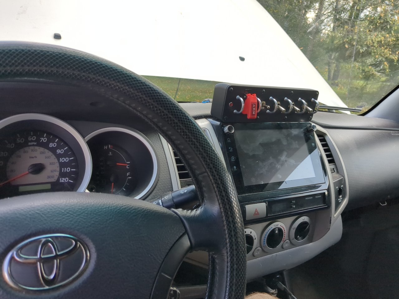

    Here's the switches moved over to the proto. Not shown is the cleanup inside - I replaced a lot of wire loops with ring terminals, used some better wire, and generally did a much less temporary/"just to make sure it works" job:
    Here's the housing placed after slightly enlarging the hole in the head unit bezel and drilling one in the housing. Not pictured is replacing the uninsulated spade terminals wrapped in shrinkydink with fully insulated spade terminals. The new control wiring from the relay box was also run, and the winch and relay wiring inside the dash was loomed together neatly:
    I also loomed up the new wiring under the hood, I'll snap some pics of that when I get back in there in a day or two.
    Here's the prototype panel installed and working:
    You can see in this next shot that we forgot to account for the slope of the top of the head unit bezel, so it tilts a little awkwardly:
    I took some measurements to alter the geometry of the bottom surface of the housing with the next iteration (to compensate for the slope of the bezel), but the interior geometry and switch placement geometry is spot on.
    We also discussed a super trick backlit faceplate idea that he's going to mess with for the next iteration.
    Even though it's not perfect for the time being, it sure as Hell beats what was there before.

    Hey man, something was bugging me about this so I took a more careful look - it is indeed the Alternator -> Fusebox 1/0 cable that requires a bent lug. I have edited previous replies/notes for clarity for others in the future.
    Again, the Alternator +12v feed to the fusebox requires a bent 1/0 x 5/16 lug, which may also require minor fitting with a round file to seat properly. The bend is also not quite exactly 90 degrees, and do be mindful of the crimp orientation to achieve a good fit.
