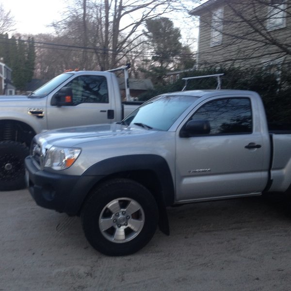

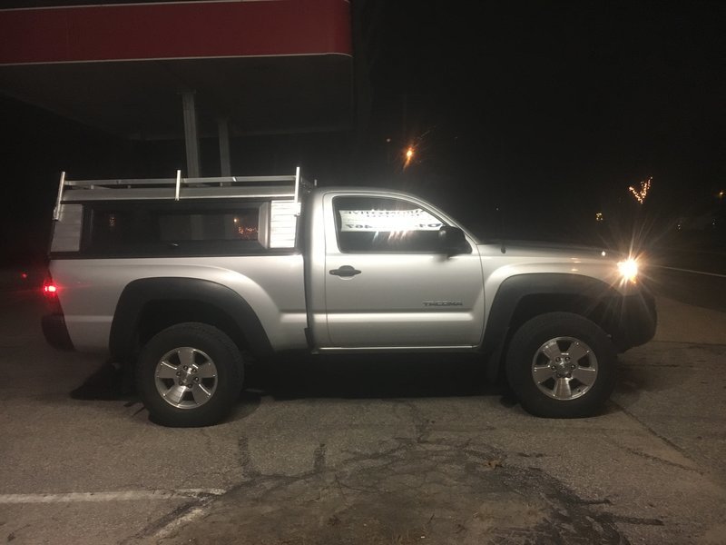

    Its all true... I have 2016 TRDOR shocks and coils on my 2006 regular cab, well worth it! Much better ride, almost 2 inches of lift in my case, bolt on application.
    BEFORE:
    AFTER:
    srdoublecab2.7, kryten and rcsteele like this.
