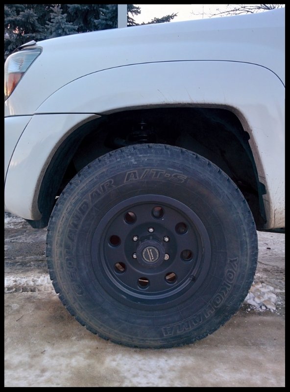

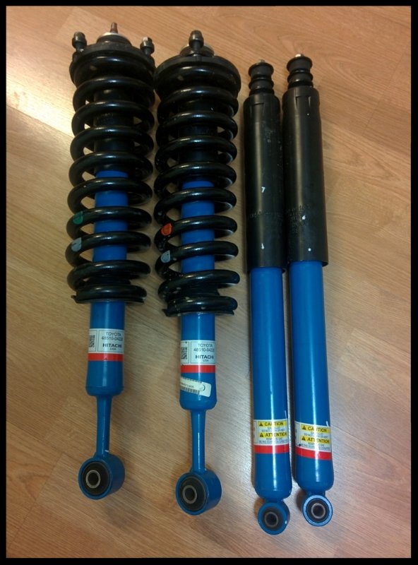

    Very happy how it turned out. Imho looks like a 2nd gen should have looked liked from the factory. Ride is great, I have no regrets. I was a bit worried about it driving like a dump truck with a plow hanging from the front due to the coil weight, but it drives exactly how I would expect a Sport Tacoma to drive. I don't think there is anything wrong with the Hitachi's unlike some of the threads here seem to imply. If you like softer ride go with OR, if more firmer, but not punishing or harsh ride is you preference go Sport, otherwise pick whichever is available cheaper would be my take from this.
    Just a disclaimer, these are just my initial impressions and my old suspension was pretty much shot. I will post back in a month or two when it settles and when I have a better feel for it, but yeah, I'm happy. I don't think I measured on perfectly level ground, but got about 1 1/8" on driver side and 1 1/4" on passenger side. So hub to fender now is 21 1/8" driver front, 21 1/4" passenger front, 22" rear. This is on a DCSB 4x4. Will update in a month or two with proper measurements on level ground after it has a chance to settle. So about total 1.5" lift up front with 265/75/16s and 0.5" in the back so far.
    Also, Hitachi's are larger diameter shocks than Bilsteins for what thats worth, however seems like the welds are smaller on the blue ones. Mine were the same.
    https://www.tacomaworld.com/threads/hitachi-shocks-on-2016-trd-sports.391637/page-4#post-13814065

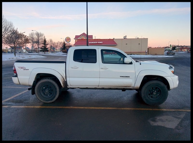

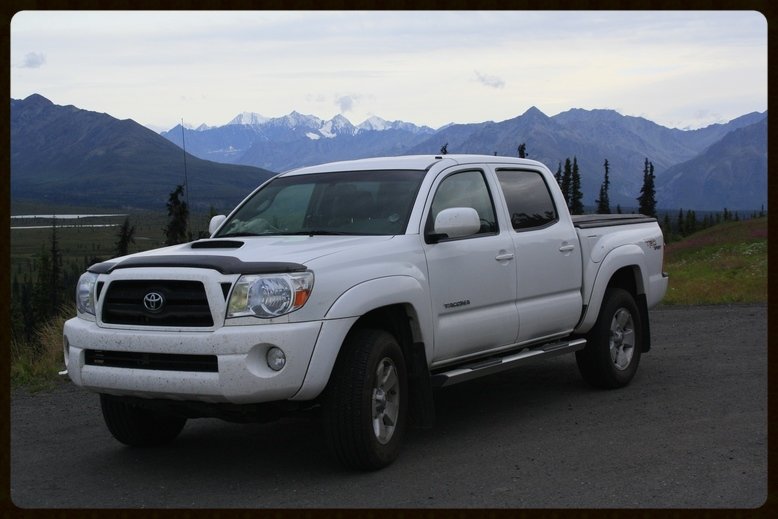

    Before: (265/65/17 HT, stock 4 leaf pack, stock TRD Sport Bilsteins)

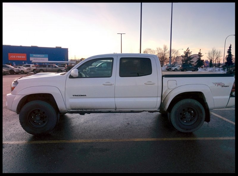

    Before: (265/75/16 ATs, stock 4 leaf pack, stock TRD Sport Bilsteins)

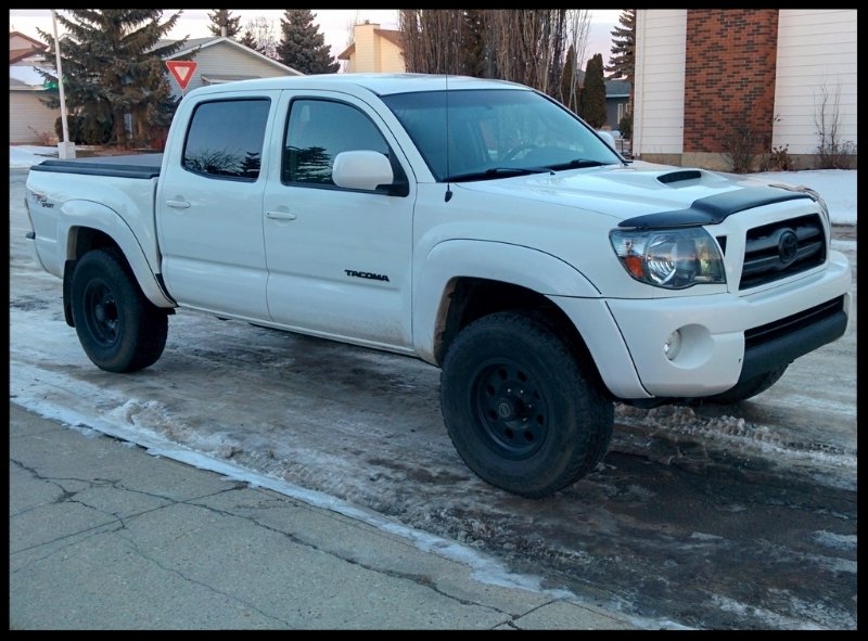

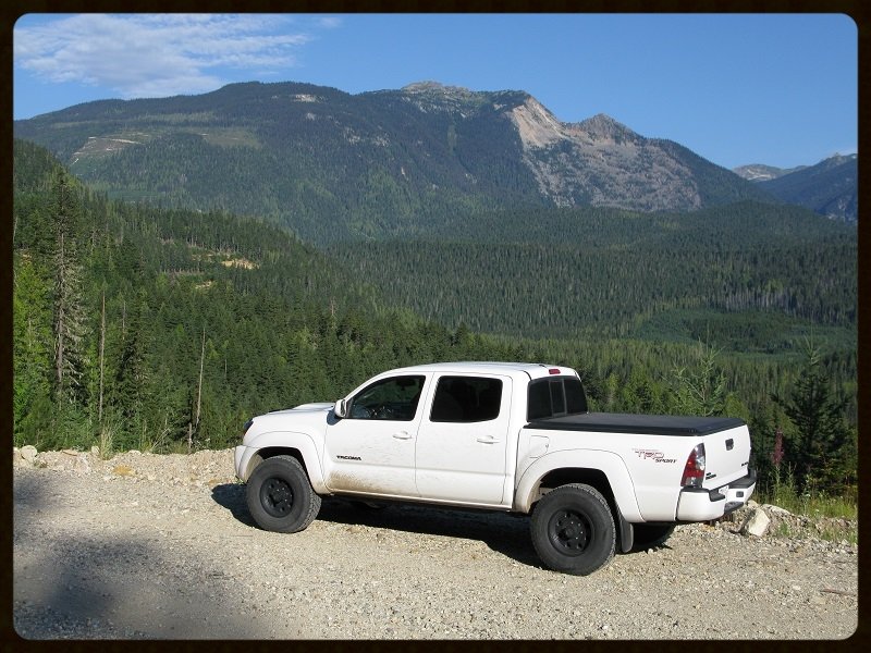

    Before: (265/75/16 ATs, Recall 4 leaf pack, stock TRD Sport Bilsteins)

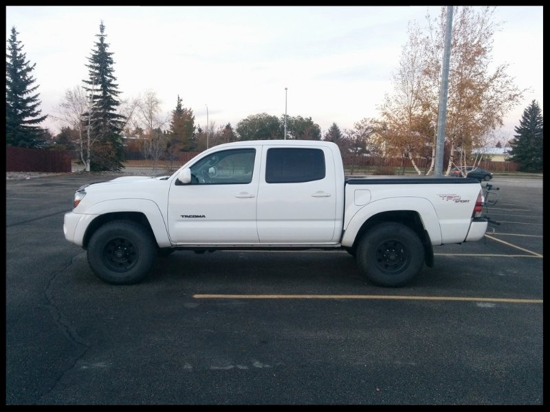

    After:
    (265/75/16 ATs, Recall 4 leaf pack, 3rd gen TRD Sport Hitachis)

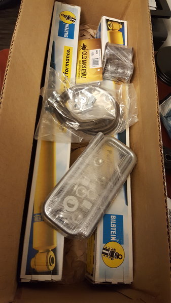

    My current setup:
    OME Dakar Leaf Packs
    08-05-16 Received:
    RCD Bilstein extended length rear shocks
    (Race Car Dynamics)
    Extended length rear brake lines
    Extended Ubolts with hardware
    Poly bushings for Dakars
    CB drop (if needed)
    08-08-16 Recieved:
    Maxtrac 4inch lift spindles
    Extended front brake lines
    With hardware
    Checking hardware count and admiring my purchase.
