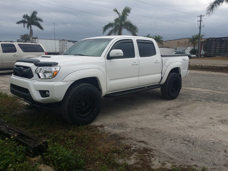

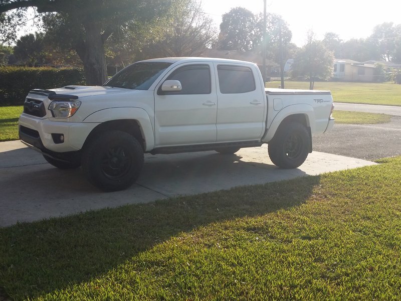

    Fronts done. 2016 Sports shocks and coils. I added a one inch spacer. Got 2 inches and a little brother lean. Hopefully next week I will get the rear done. After
    Before
    Definitely adding the aal.

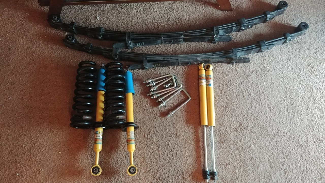

    Please refer to my picture, what is there is what the shop gave the guy back after the shop installed a lift kit.
    Am I missing anything?

    Bump. My understanding is the rear shocks will be a breeze, off and on reusing their bolts.
    I can't find a solid answer on if it'll be worth it to swap leaf springs as well.
    Mine are the TSB 4 pack not 3 months old.

    The front coilovers after I have the springs re-installed, ill be able to simply remove the original front coilovers and place the TRD ones in re-using the bolts? The "top plate" will be re-used?

    You will have to disassemble the old and reuse the top plate or buy new ones.

    Much obliged friend! Finally found a good video outling what I need to do.
