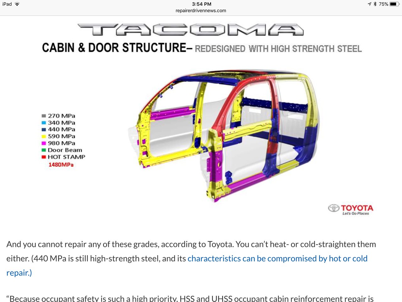

    It seems that perhaps the article means that it is a first for a Toyota truck and first for Toyota in North America.
    That highest strength steel that is designated red in the chart is used in just the pillars and a portion of roof rail on the Tacoma.
    As there are many levels of high strength steel, Ford says that they were using 1300 MPa steel back in 2015.
    The Tacoma has a 4 star crash rating, which is good. Other trucks have a 5 star rating.
    There’s always room for improvement!
    Maybe on the 4th Gen, or possibly sooner, as crash requirements and ratings are revised over time.
