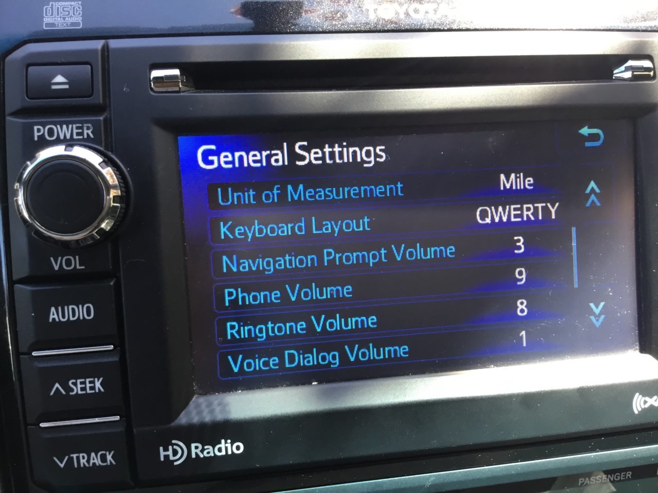

    Go into settings , reset all data to factory. Restart vehicle

    Could you walk me through this resetting the factory settings. I went into map settings then what?

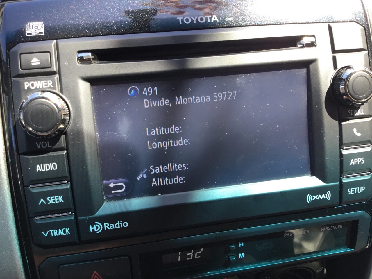

    When I hit location and gps information it shows 491 divide, Montana 59727

    I’m not in my truck now, but after hitting settings (main settings, not map settings) click on something that leads to factory reset.

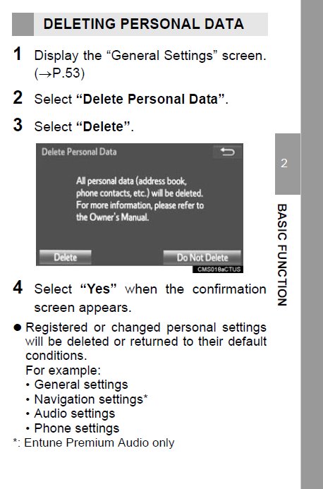

    Try this:

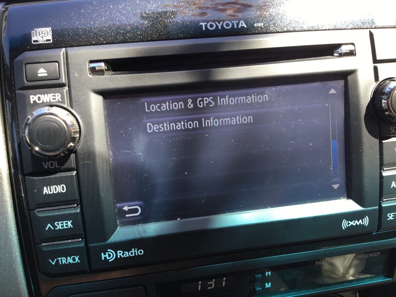

    Under location and gps info

    Ok I will try it
