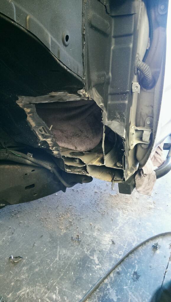

    I'm going thru the 35 thread now, you talking about the wedding for the cmc? I'm more scared cutting fenders. What you do for intake to prevent water

    I'm lucky I have some good friends in the medal fab profession, but no one here has the knowledge on this setup on Tacomas here

    :eek:i thought just had to beat that in

    That's all I did, but I have long travel. I had to beat on it with a 10 pound sledge until the metal stretched so far it began to crack. Like more than 100 full power strikes per side. My therapist says I have anger issues. Fuck that guy.

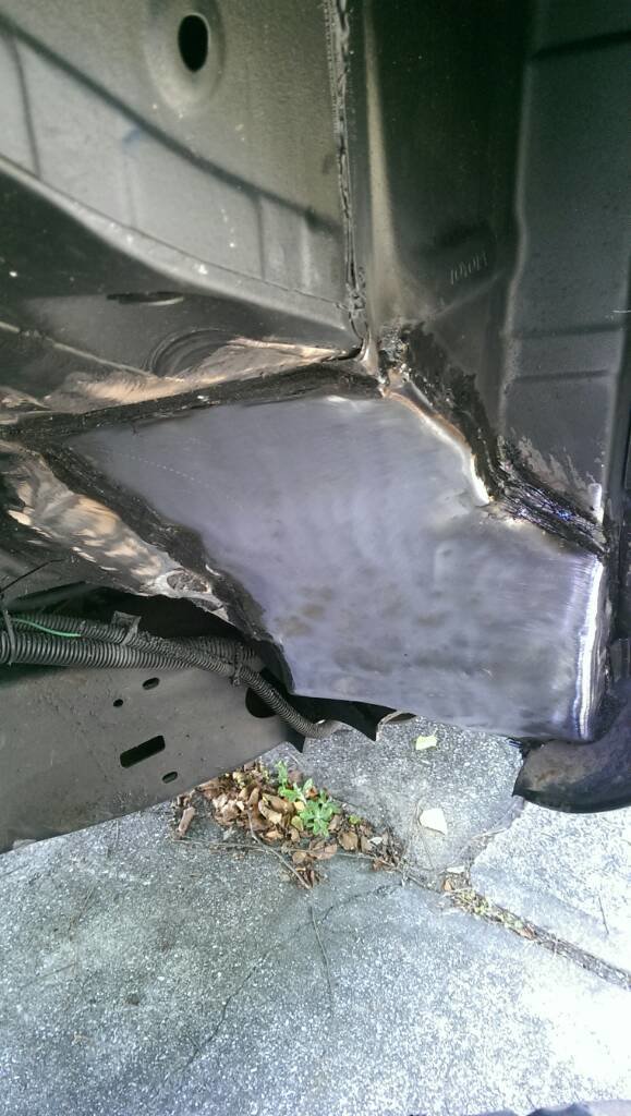

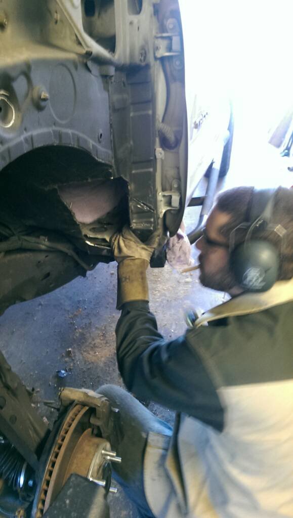

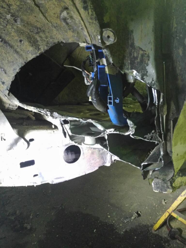

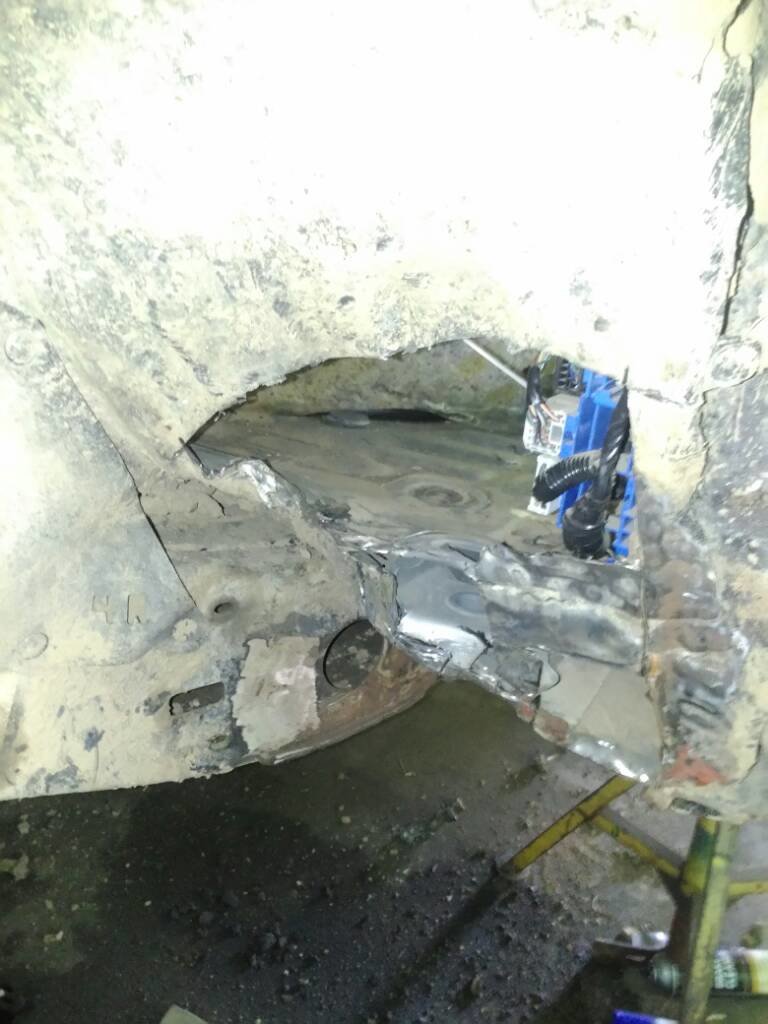

    No I'm talking about this

    You said Eric at SOS did all that

    Eddy, but close enough. He's the guy in the first picture. He moved my cab mount and did the tub

    sorry my dyslexia kicked in. CMC and beating, even fender trimming not scared of, the tubbing little scared

    It's cool. I can't blame you, my ass puckered a little when I saw a 4 1/2 grinder come through my floor board. I'm glad it got done though

    I did mine with a die grinder... it took a lot longer but I felt like it didn't throw as many sparks as a 4.5" grinder. Also easier to maneuver in there

    The grinding sparks didn't bother me. We used some we towels to keep them under control. The paint they used on the inside of the cab is flammable as Hell though. It's like welding on napalm so be careful.
