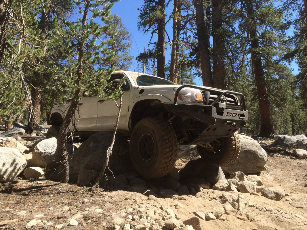

    2nd gens can handle 37s easy. Just drive accordingly and be smart. I didn’t break a single part on 37s. Rubicon, dusy, loads of local wheeling.
    Also it looks fucking cool

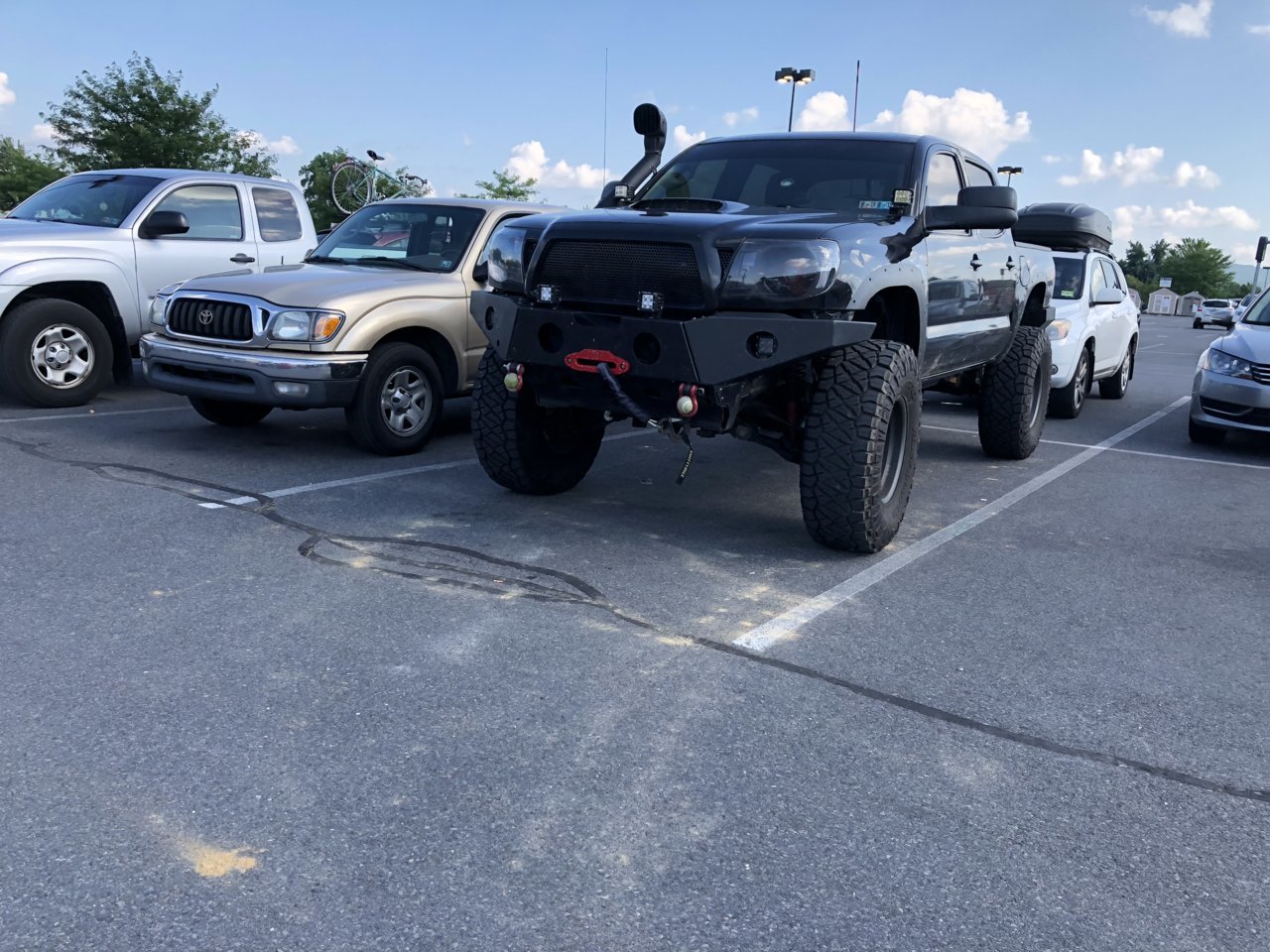

    I tried to just cut the cab mount back as far as possible and noticed it started to droop. I ended up doing the cab mount relocate.

    Bc 37’s, that’s why.

    Needs moar slider... ;)
