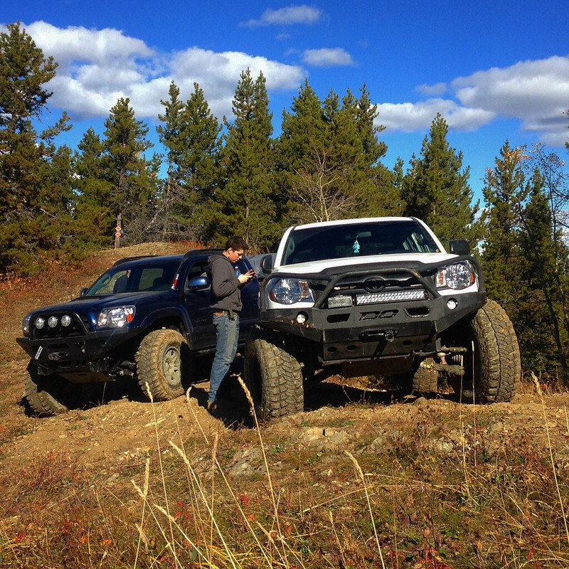

    Spoonman
    Spoonman [OP] Granite Guru
    Sep 11, 2011
    #63328
    9,810
    Jamie
    Alberta

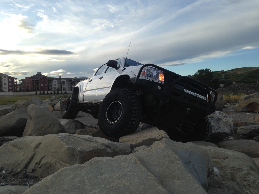

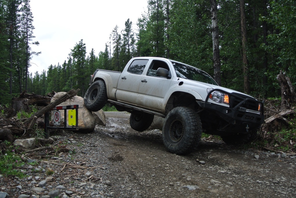

    37s on 2” lift here. Just gotta cut cut
    Since everyone posting pics
    Flexin on everythang
    I could keep going.

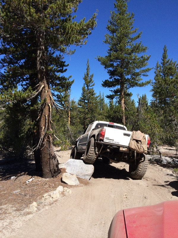

    '15 Magnetic Grey 4X4 TRD Off Road
    Icon Extended Travel, SPC control Arms, OME Dakars, B110's
    Awesome set up. What a lot of people dont realize is that lift height doesnt determine how big of a tire you can fit on the truck if your actually wheeling the thing. Its mainly how much youre willing to cut. The suspension still has to go up and down

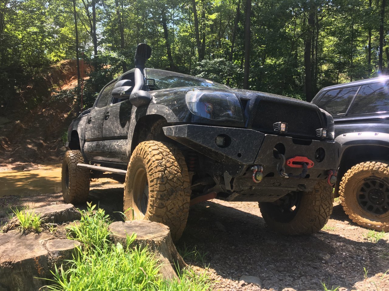

    Looks like you used to have an Airflow snorkel, did you go away with it?
  8. Aug 10, 2018 at 8:17 PM
    #308
    la0d0g
    Jan 25, 2011
    #49903
    19,887
    running for the hills
    For crawling not hauling
    And less bumper :D
    Where you been?
