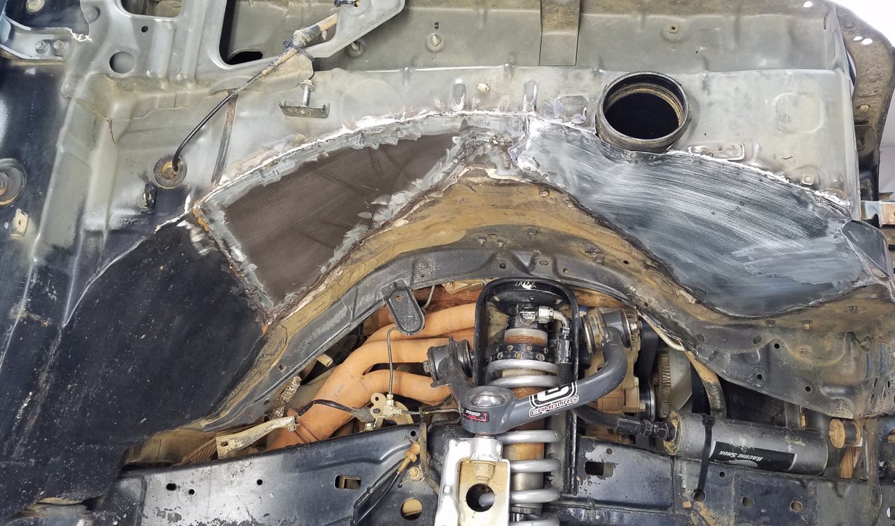

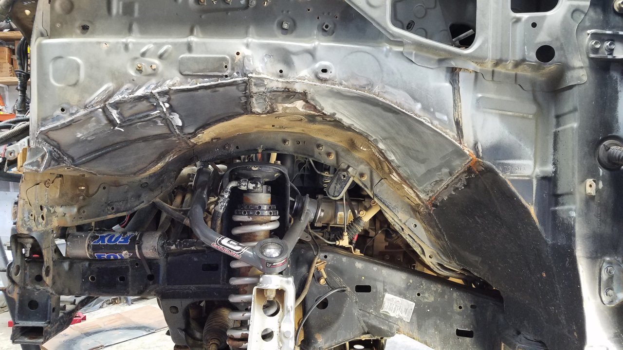

    The alignment has to do with the caster angle. The factory cams push the tire forward to get positive caster. Aftermarket uca push the tire back to get positive caster. Best to max out caster in that scenario. Another option (what I've done) is to get aftermarket lca. They are not cheap but definitely help with pushing the tire forward. On to the trimming... I've already trimmed my flares and fender for 35s and had to do only a little bit more for 37s. I can send pics if you want them. I relocated my body mounts and tubbed the firewall. As a reference, there is a bolt at the bottom of the fender. That's where I've seen most people cut back to. You can see it in this picture. 20180720_225838.jpg

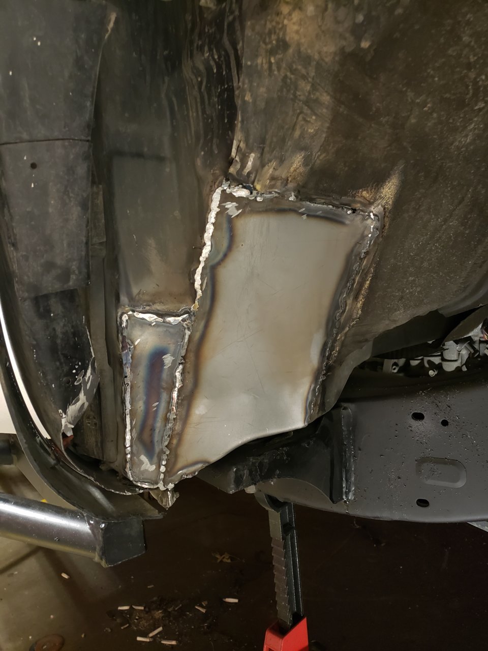

    I pulled my coilovers and compressed the suspension all the way then cut 1" past where the tire touched so I ended up cutting 2.5" out of the fender well and fire wall then plated it back in with sheet metal. I dont feel I needed to cut that much but i shouldn't rub any. Haha

    Clean work!
