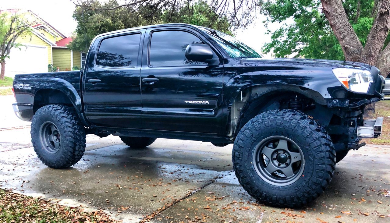

    15 TRDOR DCSB 4X4 6MT
    2" lift. 37s SCS F5s

    Oh fuck yeah bud
    Looks like you need to tub a little!

    Oh yea. It‘s just barely streetable right now. No way I could wheel it.
    Gotta relocate the cab mount and beat the fire wall. Gonna try to not tub if I can. Probably will end up doing it tho.

    Honestly man. Tubbing is easier than everyone says. Do it nice. I’ve done it both ways. Hammering for clearance and tubbing for clearance. By far, just tub it. It’s not really that bad, comes out looking professional, and isn’t hack. Unless....you just need a little clearance. If you just need a little, it’s cool to hammer it. But if you need to hammer a LOT, just tub it.

    Yea, once I get the cab mount relocated I'll check to see how much clearance I have. If it only needs a bit I'll beat it but if its a lot then I'll tub. Not afraid to do it, just don't want to do it. I'm lazy. lol

    Ok this pic does it for me the RAZR MT is what I am going with!!!!!:thumbsup:

    They’re quite meaty. And surprisingly not too noisy. Although I’ve only got a quick run up to wallyworld on em today. I’ll find out in the morning how they are on the highway.

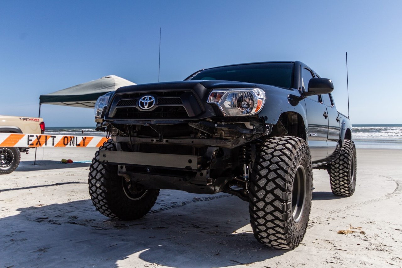

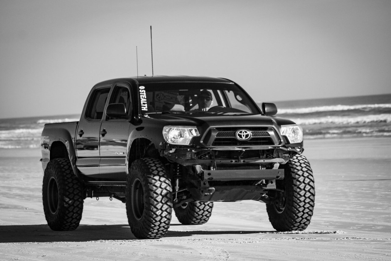

    This thread needs moar pics

    RZR M/Ts are on my short list looks like you've just gotten them on. How do you like them so far? Also is their sizing pretty true to life?

    Loving them so far. Haven't wheeled them yet tho. They measure out to 36.8 ish, so pretty close to a true 37"
