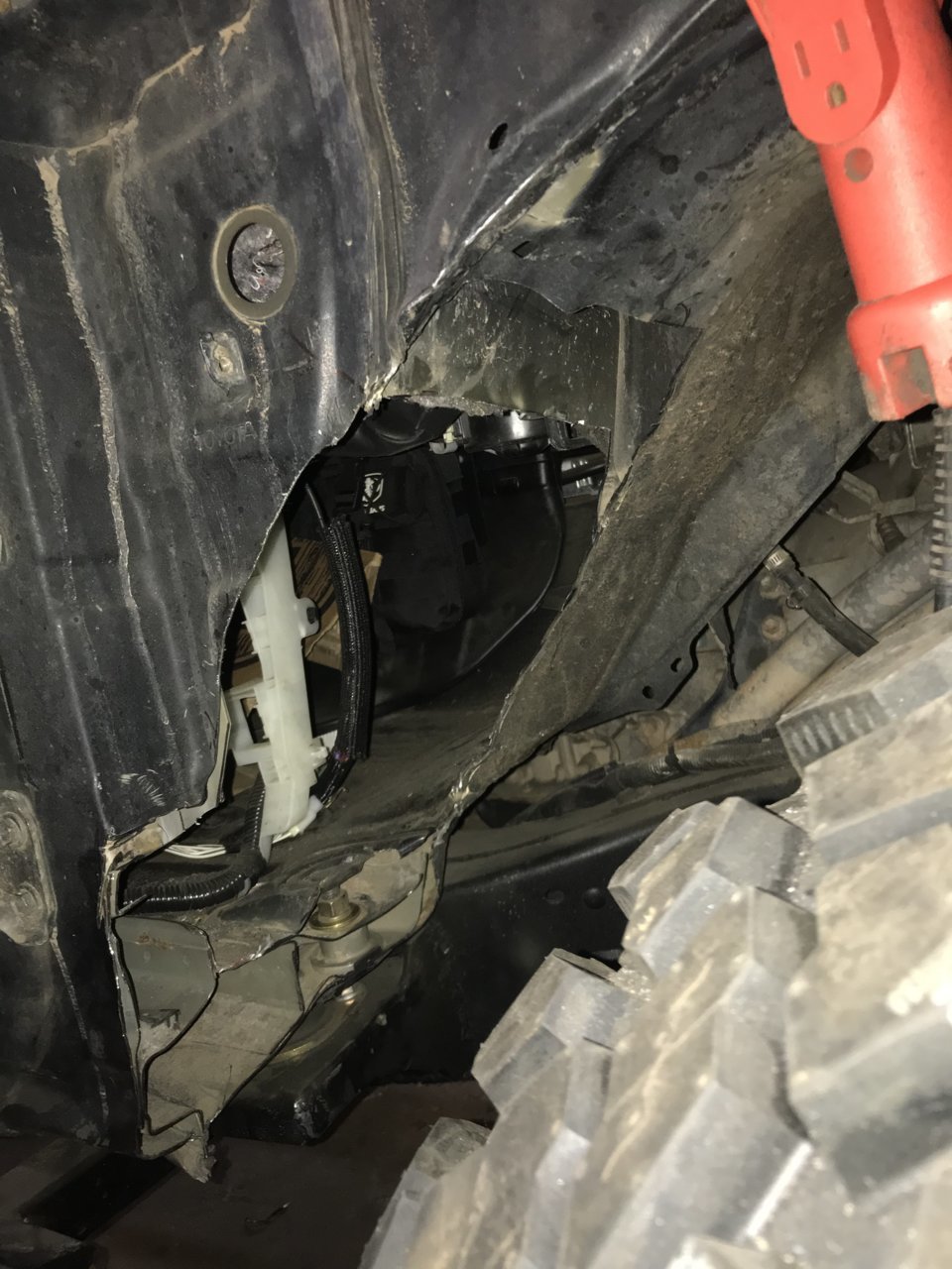

    I had lt so I didn’t have to. But the best way to do it is to cut cut cut, out your tire on, with the coilovernout and cycle it completely. See what tube, cut it, donthay until you clear fully and leave yourself some extra room for bushing flex and hard impacts. Then seal it all up

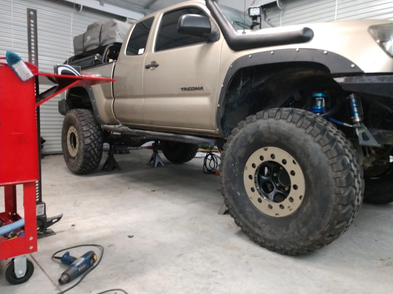

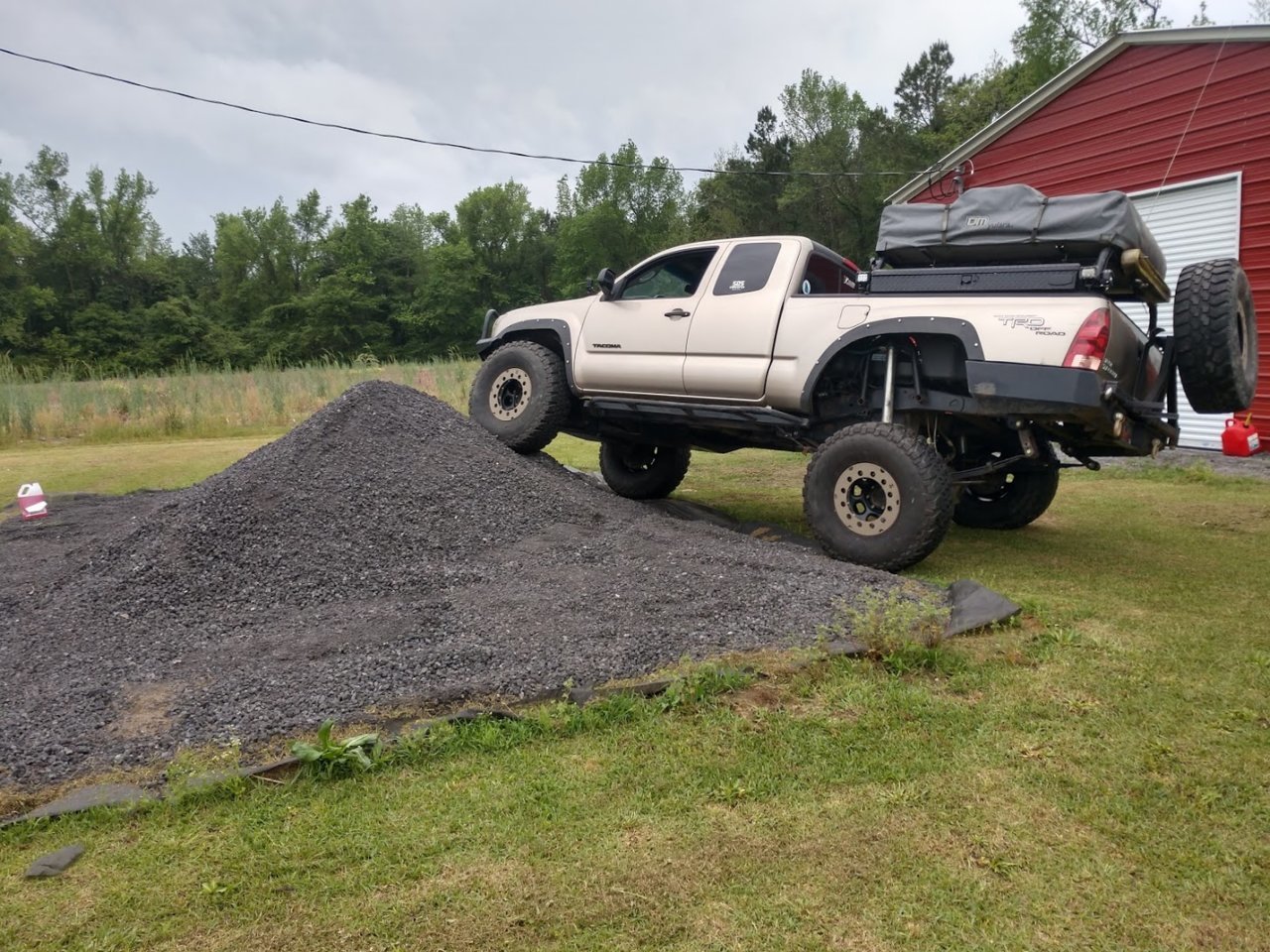

    Put new wheels on the truck. Went from a 3.5" BS to 3". Got me off the frame but now I'm gonna have to tub a little more. At lock and compression I'm hitting the firewall. Kinda expected that though.

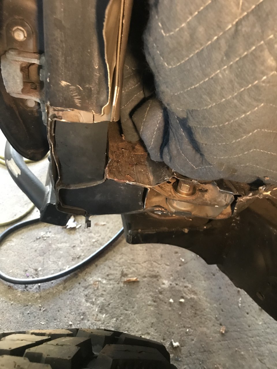

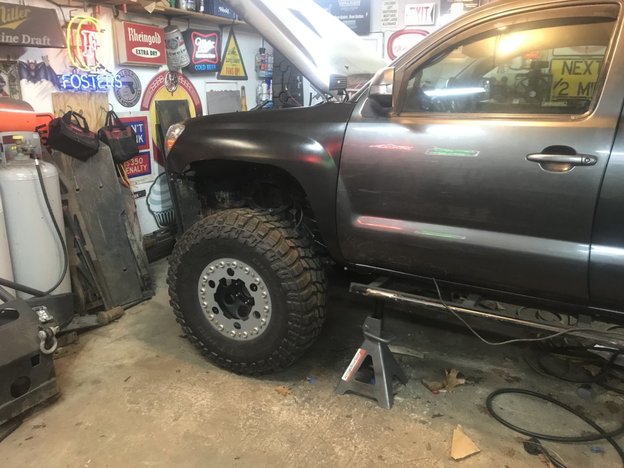

    I’m fairly new to welding. I’ve only done a few small projects, an off road trailer, and my flatbed.
    I was able to weld the sheet metal no problem. Forming the panels on the other hand? I simply did not have the knowledge or patience to do it. My buddy (he’s banned so I won’t bother to tag him) formed and fitted the panels, then I finished welding them in later.
    It’s good to have a second person around. That factory seam sealer is quite flammable...

    Whats the backspacing on your wheels? What size spacer?

    4” BS. 3/4” spacer. 17” Jegs brand steelies with TMI weld on beadlocks.
    They JUST clear the calipers up front.

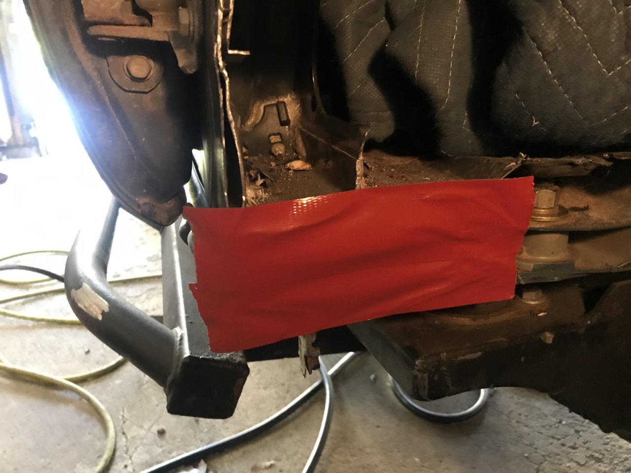

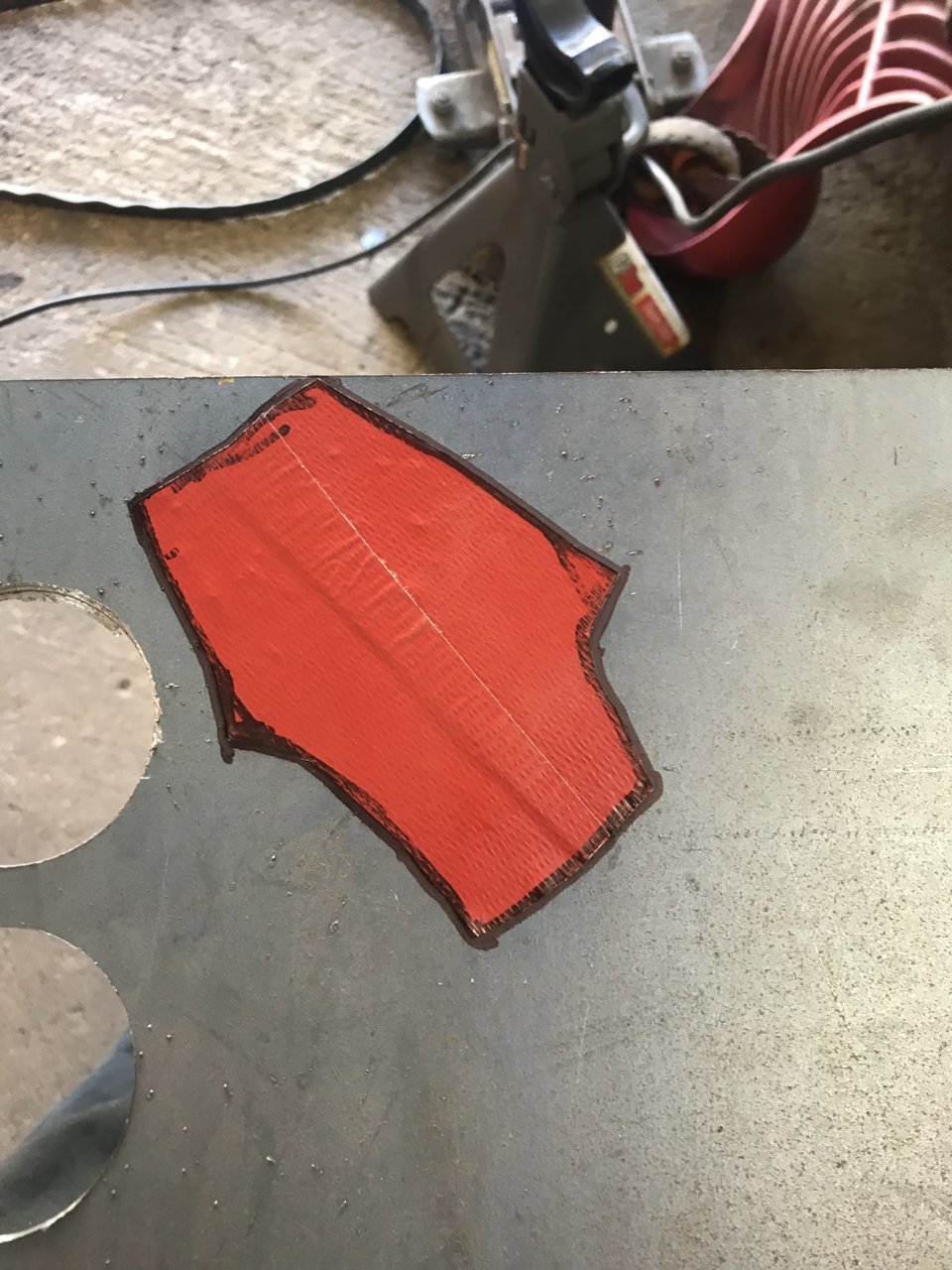

    It’s probably already been covered, but another thing to consider.
    Mine had to be cut so far back by the body mount, that it got into the vertical structure of the cab.
    I cut out patch panels for that part from 1/8” plate. I used neat trick that @Blackout14 told me about. I put duct tape over the holes, traced them with a sharpie, cut them out with scissors, stuck them to the 1/8” plate, traced them onto the plate, then cut them out with the plasma.
    The 20 gauge is welded right to the 1/8” plate patches at the bottom.

    And another, another thing, five lug fenders fit our trucks if anyone doesn’t already know. They don’t have fender flare holes.
    I ditched the snorkel and did a cowl intake. I bought the five lug fenders on Rock Auto for like $40 each.
