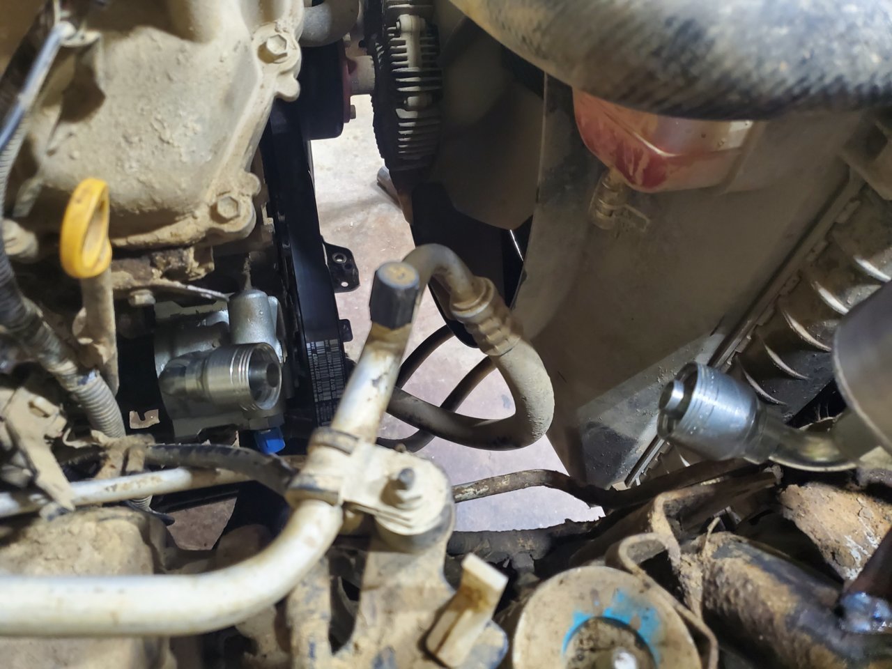

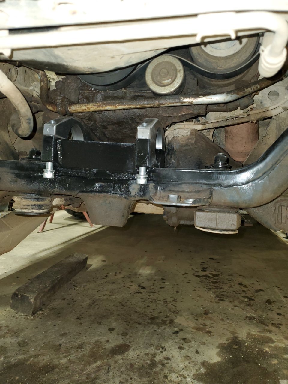

    But as for progress on the hydro swap the mount is finished and welded in, pump is mounted, the reservoir is mounted, and tonight I mount the orbital valve.
    Dont worry about the dirty engine. That was from the rack dying and pouring at 4 or 5 quarts of ps fluid on my way home from the last offroad trip Haha. It will get cleaned up.
