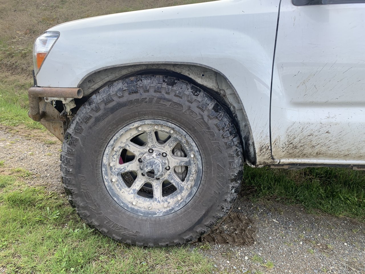

    uptravel is my biggest worry, this is my current setup. I’m hoping that the 1” body lift will get the rear section of the wheel well out of the way a little bit.

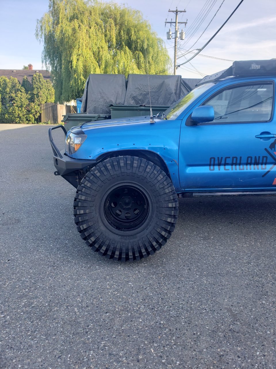

    Here's the best I can do... customer's tire came in today as he wrecked one, so I took this picture:20200527_184941.jpg

    What happened to his trep? I sliced one on the bead Sunday and it was the first trip out on them.

    How'd you do that my buddies treps have taken an absolute bashing and barely any nicks or anything they are pretty damn tough tires

    The road he was on gave out, and he flopped his jeep about 10 feet down off the side of the road. Recovery took 3 days and 4 winches. Blew two tires off the beads, and wrecked one. They were pretty worn anyway, so one will be the spare and the spare is still new
