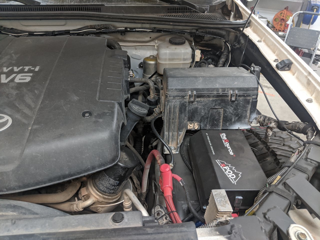

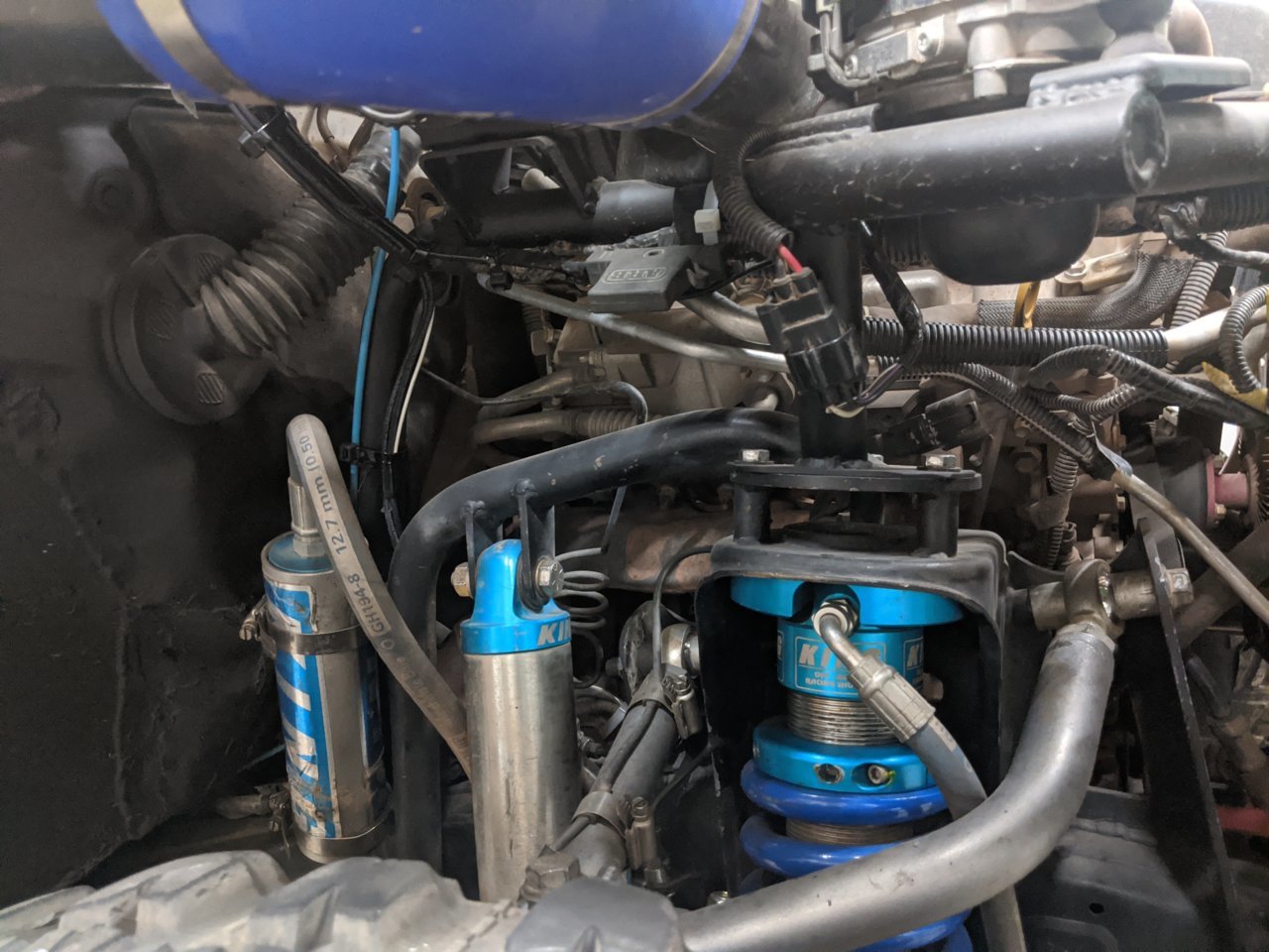

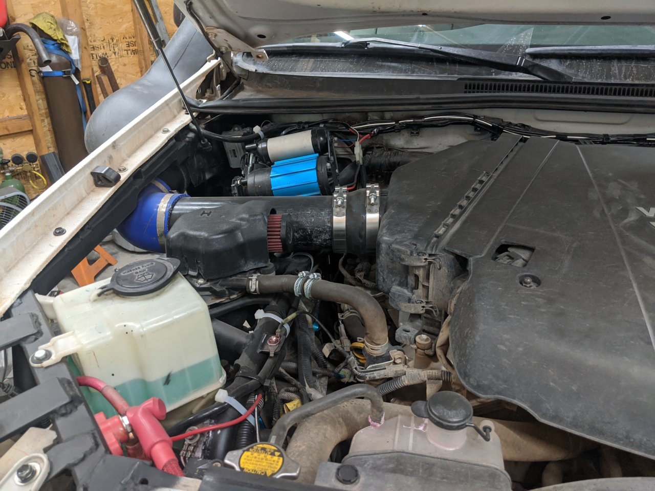

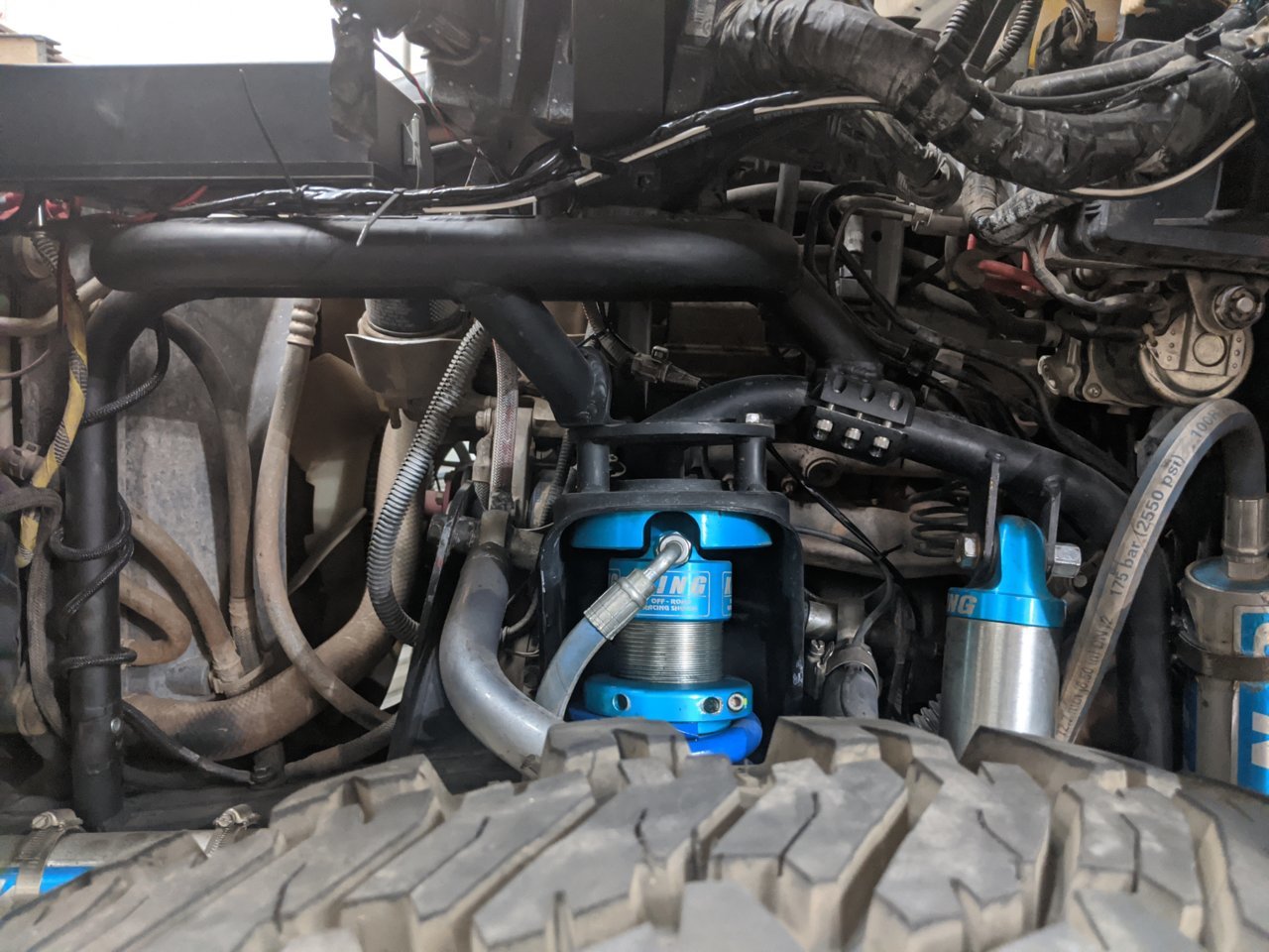

    Still have to:
    Clean up and shorten wiring
    Make some sort of splash guards to help protect components and wiring
    Try to make all the body panels that aren't damaged aligned as good as possible
    Make a bracket to support the AC tubing
    ... Probably none of which will get done before the next trail I run:frusty:
    IMG_20200622_191626.jpg IMG_20200622_191610.jpg IMG_20200622_191604.jpg IMG_20200622_191601.jpg

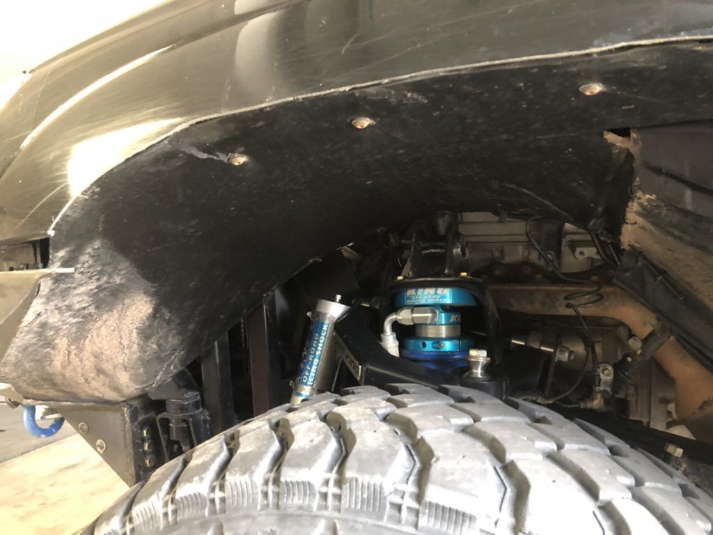

    I ran 1/4” round stock from the firewall to the rad support to mount 1/8” abs to, it’s been holding up great. I would use abs a little thinner if I was to do it again, maybe 3/32”. kinda hard to see, but the abs is zipped to the round stock.

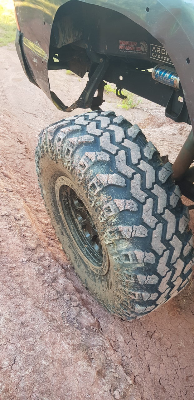

    20200528_173358.jpg Yup no fender liners .....got to invest in a snorkel....chop, chop, & more chopping...I'm going to try out the 37 swamper sx's gen2 300 bones at 4wp...because my 2 front tires got all chowed up fkn irok radials
