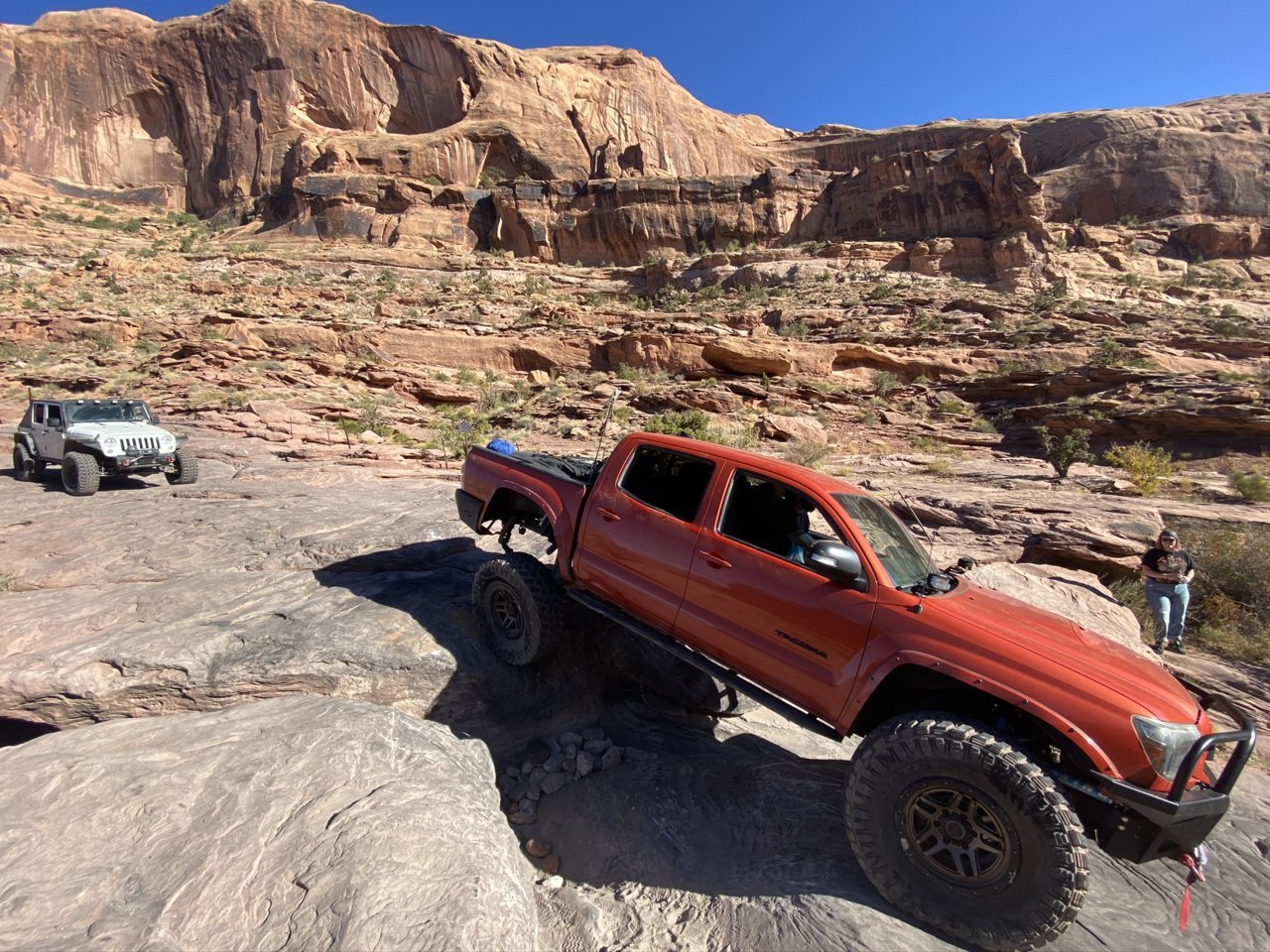

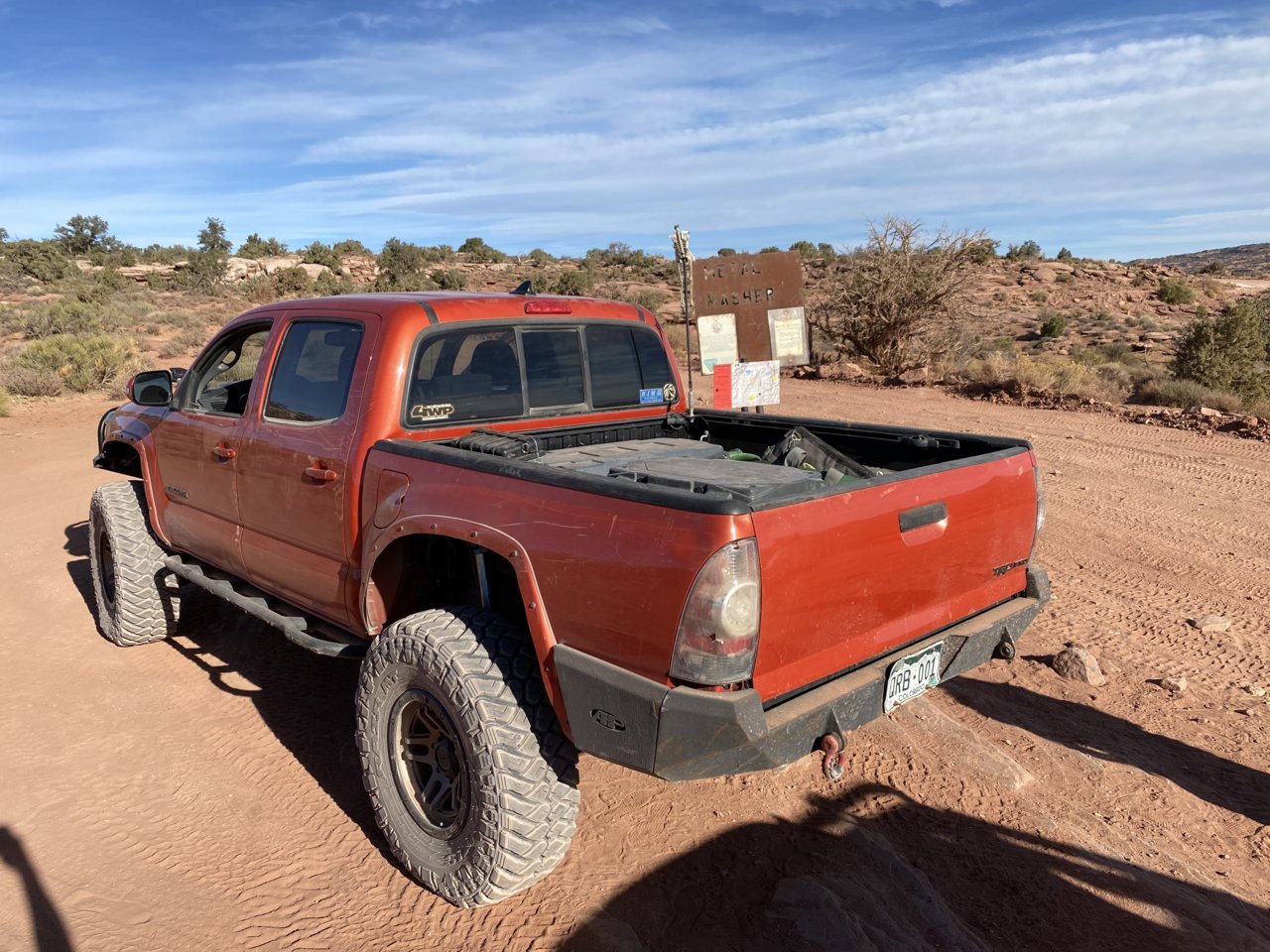

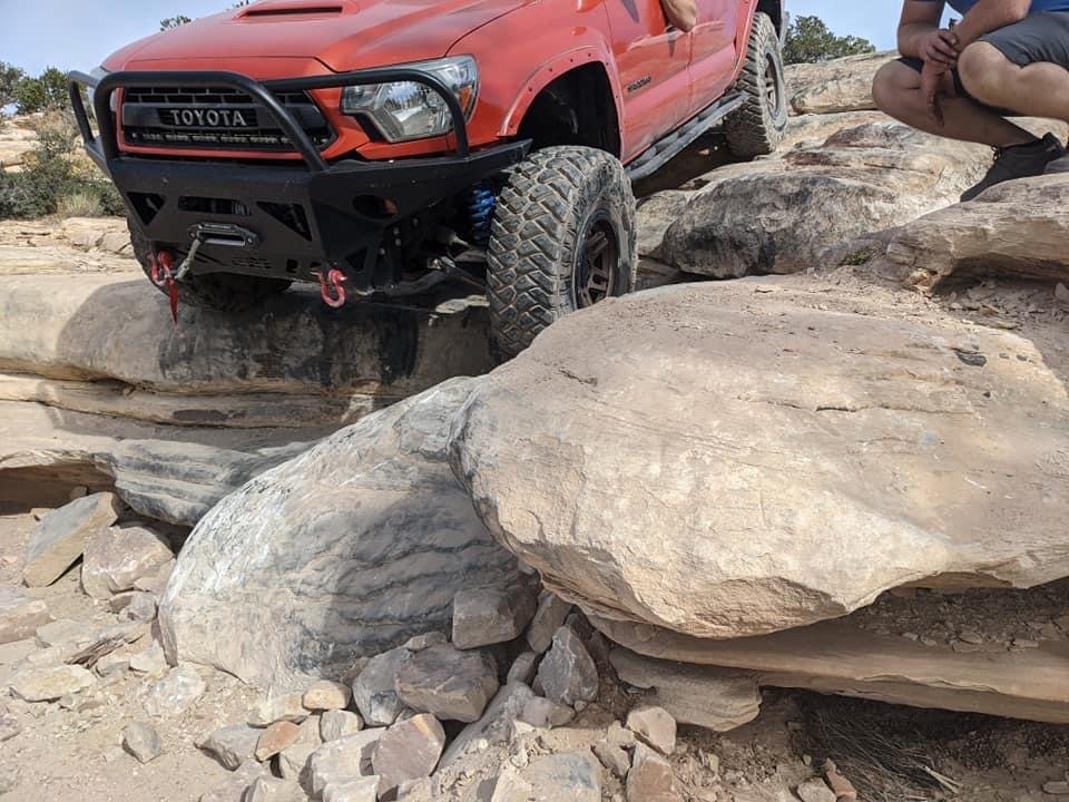

    17x8.5 0 offset
    +3.5 long travel
    1.25” spacers in back

    Very nice, love how it’s not super wide like some other +3.5 trucks

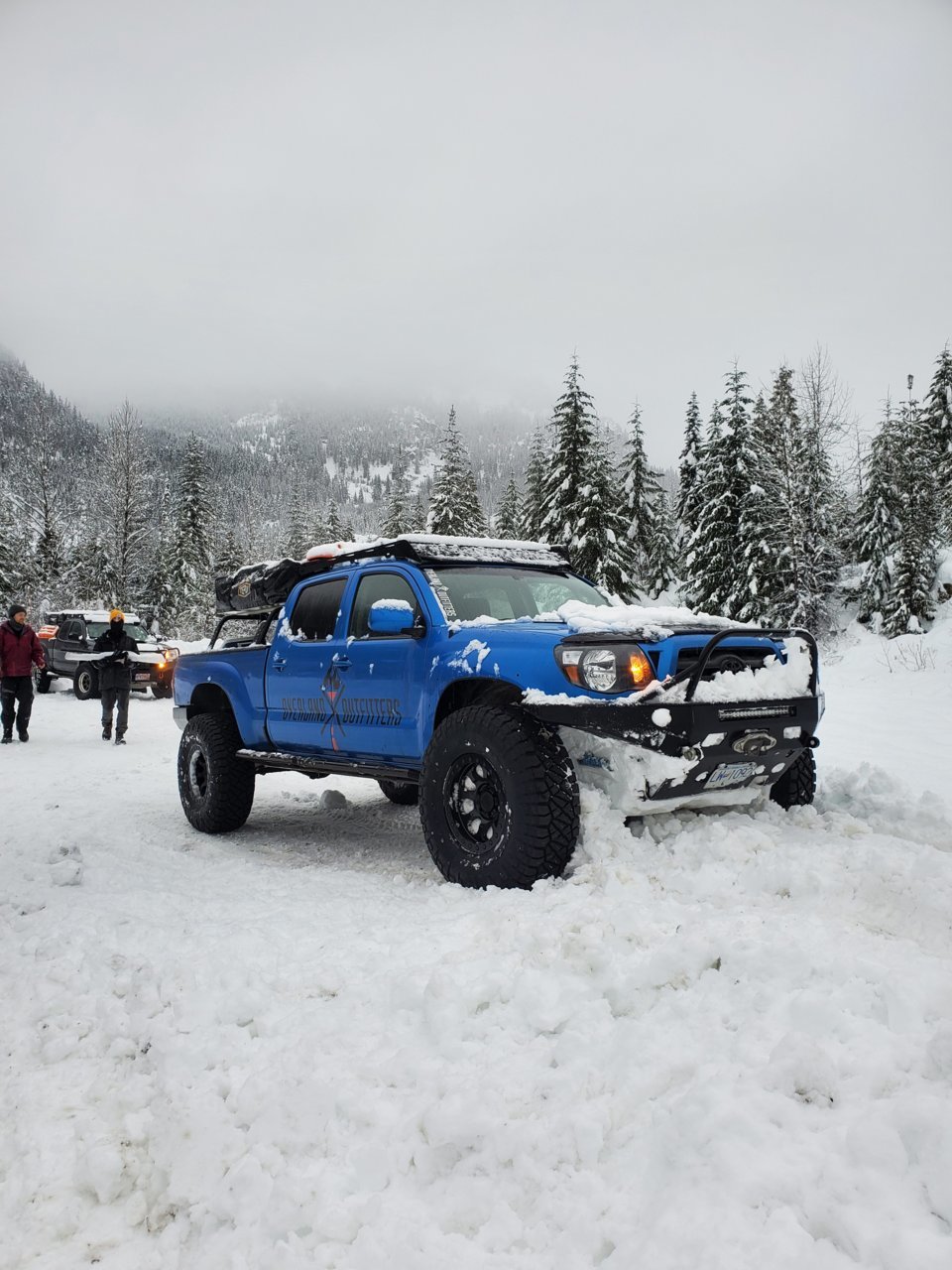

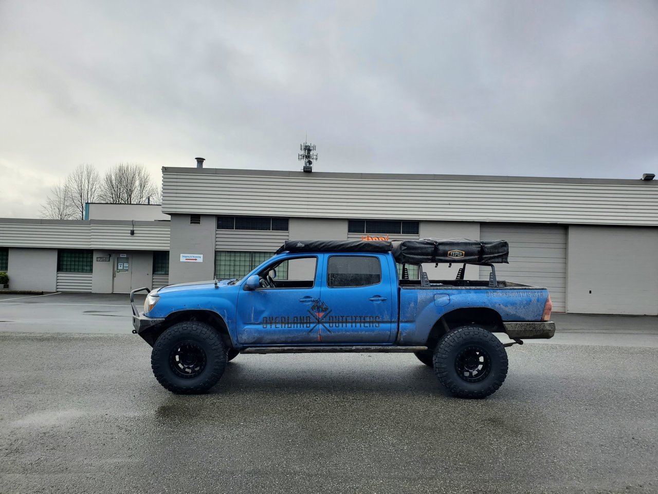

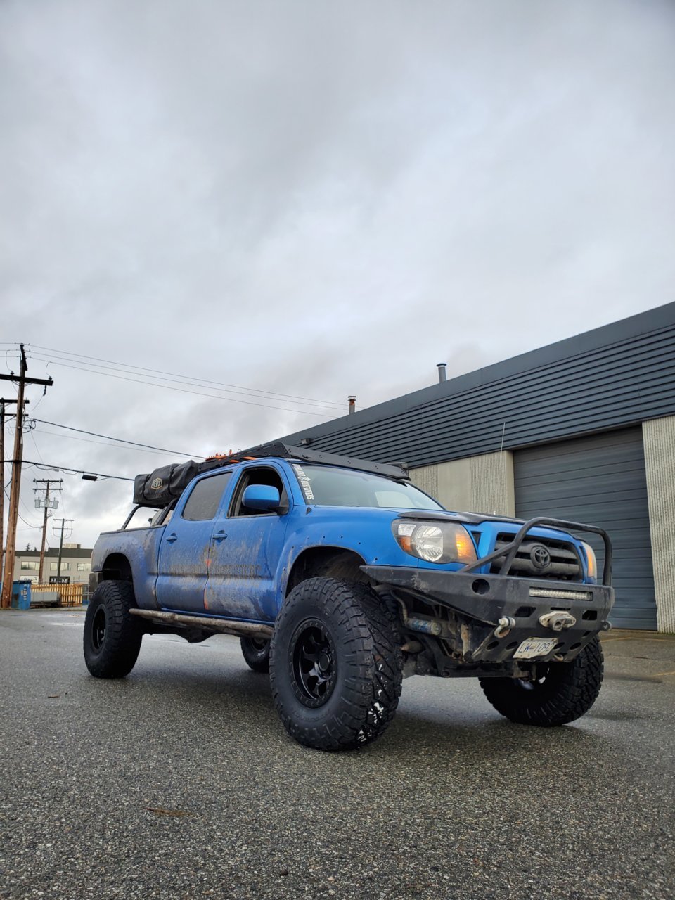

    Finally joined the 37 club yesterday!

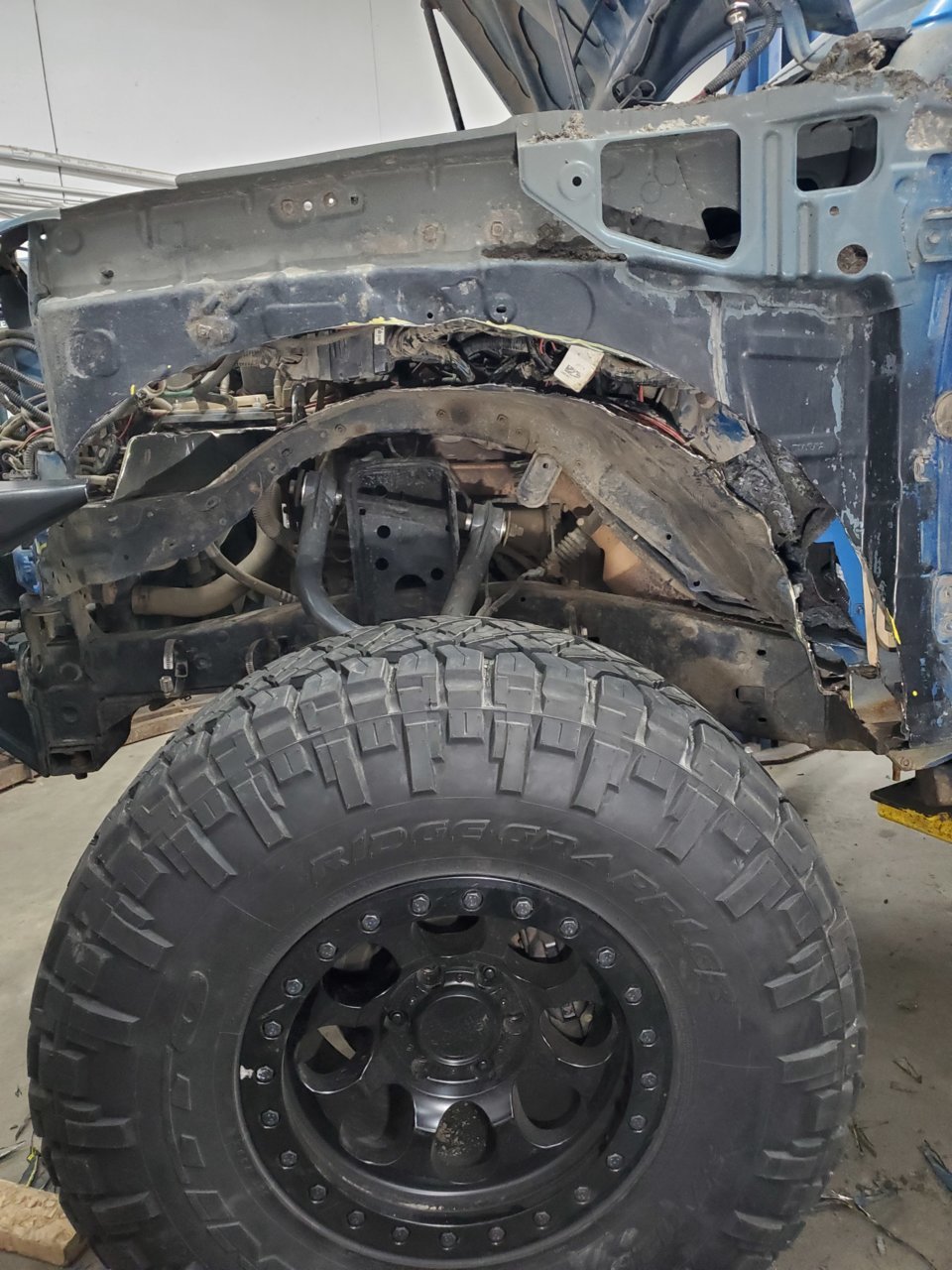

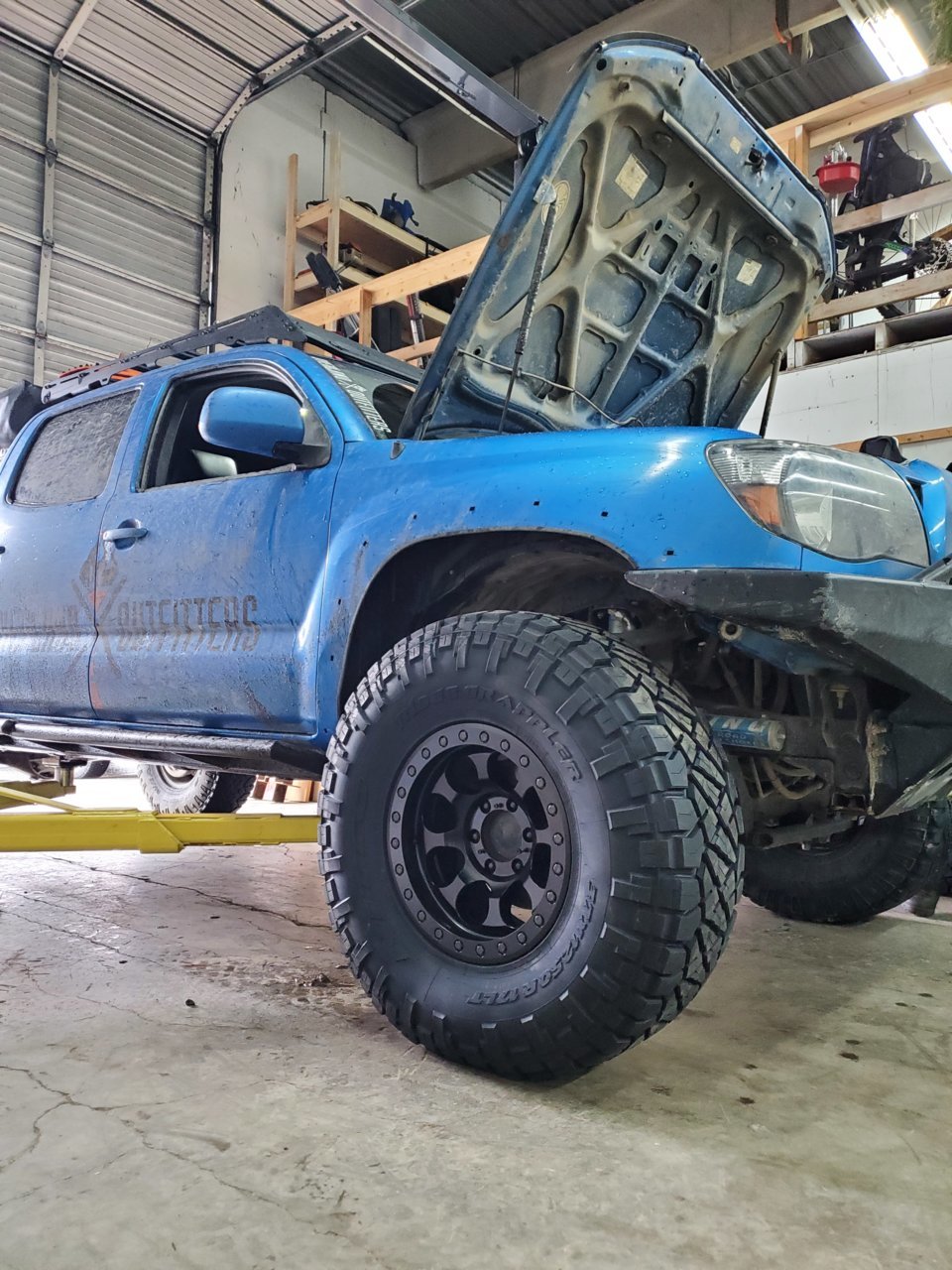

    @EatSleepTacos I started tubbing this evening. Here's how much cutting is required to fit 37s with the JD relocation and +2.25 kit.
    That's full stuff lock to lock. Will have to do something about the front bumper at some point, but I hate working with aluminum

    Holy fuck, that’s a whole lotta cutting lol
    Going to be fun plating they back up.
    Edit: what bumps are you running?

    Just running super bumps, but I took them out and am just going as far as possible

    That sounds like what @desertjunkie760 did before he realized his bumps were set incorrectly. Ended up putting the shock in there to see where it really bottoms out and realized he didn’t have to cut as much. You’re committed now though lol

    The proper way to tub is what @WormSquirts is doing. Remove the coilovers and bumps. Then cut about 1/2" above the tire line. It's more work but it guarantees that you will never rub. Even during the most extreme situations you put your rig in. Plus, it's just a ton of fun to chop out that much metal. lol
