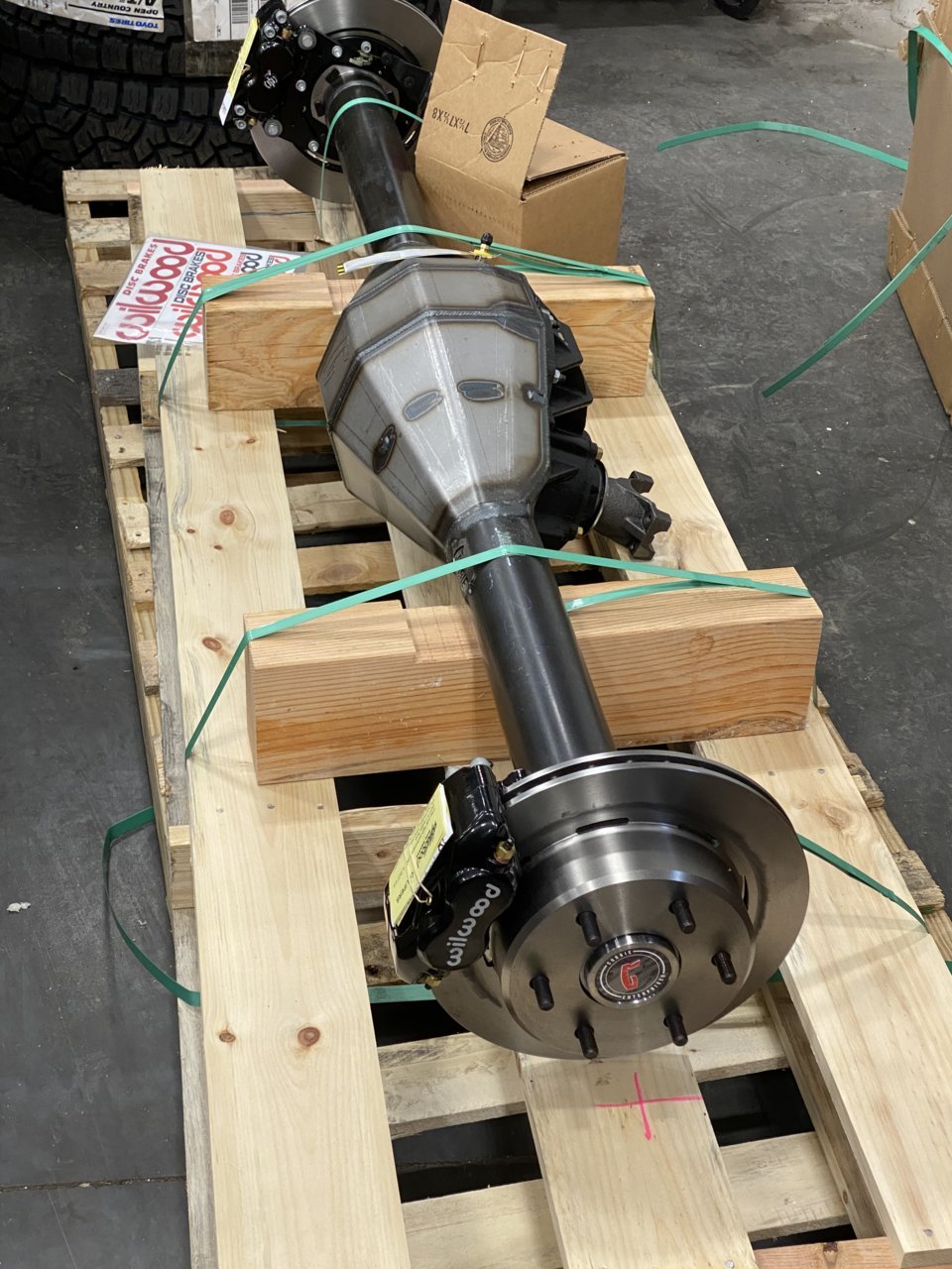

    No more blown up rear gears for me!
    Hawk373, whatstcp, Grumpy and 13 others like this.

    Just gussets... everywhere
    @FlyinRyan893 there you go!
    That's awesome. I'd much rather have that than to go get another 14 bolt or 60 honestly. You won't be breaking much of anything there. Specs?

    3.5” tubes, arb locker, 35 spline shafts, 5.29 gears, 70” wms to wms
    this is nice because it’s the same bolt pattern and I can get the same gear ratio as the front.

    That’s awesome. Who did you order through if you don’t mind me asking?

    Currie/4wp

    I've seen so many elocker rears blow its stupid how weak they are. The non elocker rears seem to be quite a bit stronger. (Not saying they are indestructible, but definitely better out of the two)

    8 vs 8.8 with same size pinion I would imagine the difference is minimal. I’m also a bad comparison because I’m really hard on my truck.
