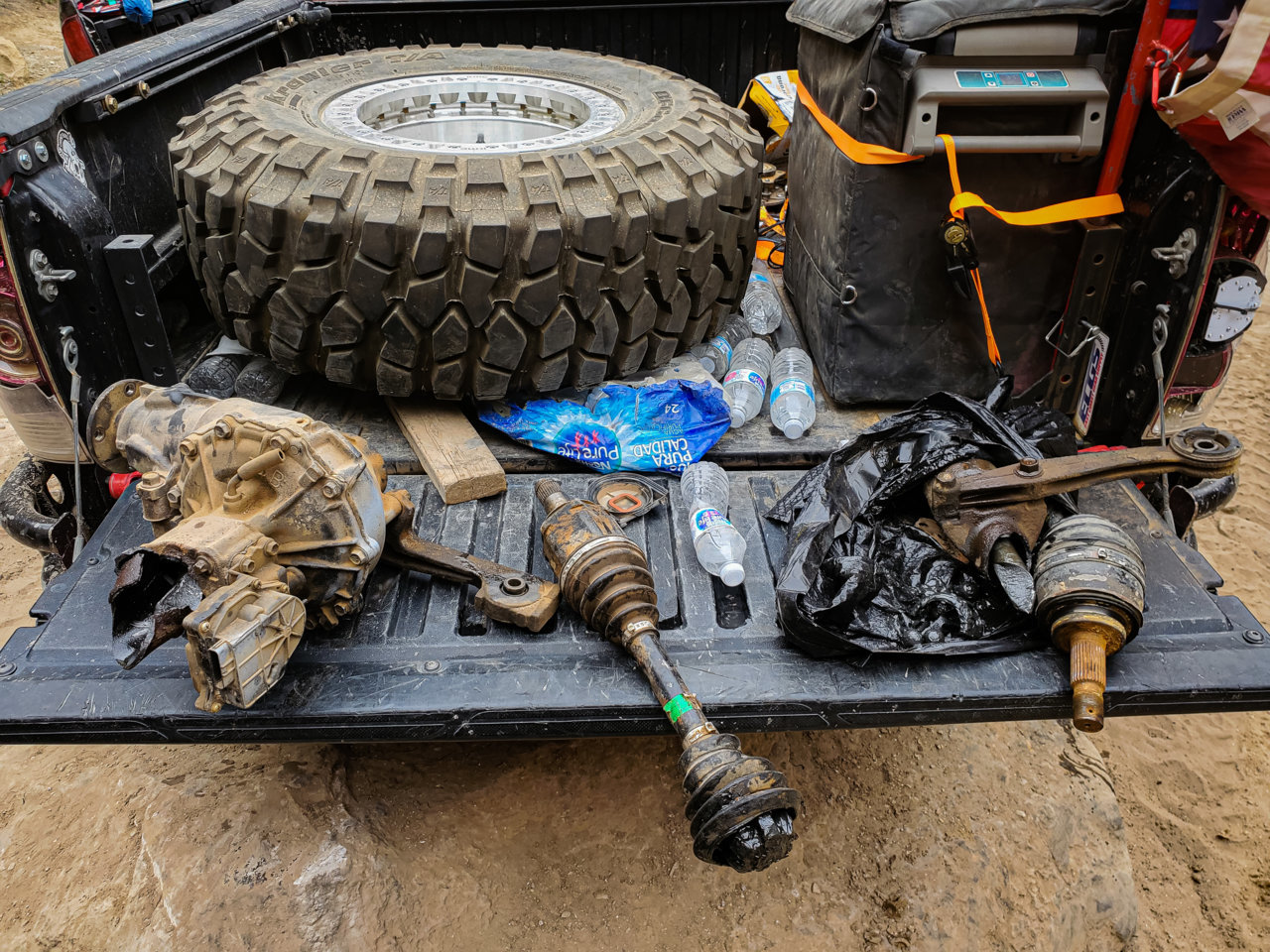

    So depending how you break you can drive on it to get to a better place to change. Depending how you broke lets say outer you can just cut the inner boot and yank the shaft out and just drive normally the inner stub will stay in the housing and the outer keeps the wheel bearing together. Worse case scenario you winch or recover yourself slowly if it's flopping around from an inner coming completely apart and you don't want to destroy other stuff. Slowly get pulled or winched to a place that you can change it.
    I'll help ya with the tools
    Off the top of my I head I can think of:
    -pick tool to remove cotter pin a pair of pliers works I suggest side cutters and they should be in your tool bag anyways
    -hammer and chisel to remove axle bolt cap you can use a flat head screw driver and hammer both of which you should carry
    -breaker bar and 35?mm socket for axle nut 1/2" ratchet and socket you can use your hi-lift jack handle as an extension
    -sometimes control arm must be loosened to make room for removal shove jack handle to pry down on control arm a buddy can do that for ya
    -gear oil to fill level however much drains out during swap pull axle out and be ready with the next to slam it in you won't loose enough to worry about
    -fingers crossed seal does not tear causing leak ripping the seal installing an axle is highly unlikely as long as you just pay attention
    You'll want to carry a pry bar too sometimes you gotta hit the axle from the backside using a prybar and hammer. Some carry a rope and make a makeshift slide hammer using that, I can never get that to work
    I've changed many axles on the trail in the rain in the mud in the cold in the swealtering heat and humidity of the SE summers. I've also completely removed the rear diff and ring gear to get home after destroying teeth. It doesn't take a lot of tools to completely dismantle these trucks just a lot of will power and problem solving to do it in the field. Having good buddies to help you also is a plus.

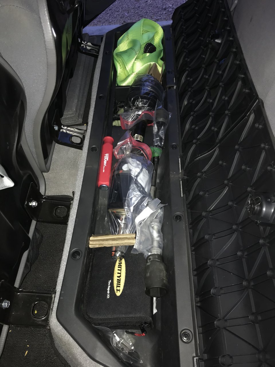

    Removing an axle is pretty dang easy - if you are wanting to run 37’s and wheel - you’d better get familiar with changing out axles & tie rods at the very least. It’s not difficult or complicated but you should keep all the tools necessary in the truck at all times IMO. I Have every tool needed to do pretty much anything in my truck at all times. Most big items under the back seat storage area and the rest are in a heavy duty husky backpack I keep in the back seat. I’m a minimalist and even I keep these items in there 24/7

    Axle, tie rods, pry bar, tire repair kit, 35mm socket, box of cotter pins, box of hose clamps etc etc. not pictured is my husky backpack with all major tools needed to wrench on our trucks which isn’t much.
