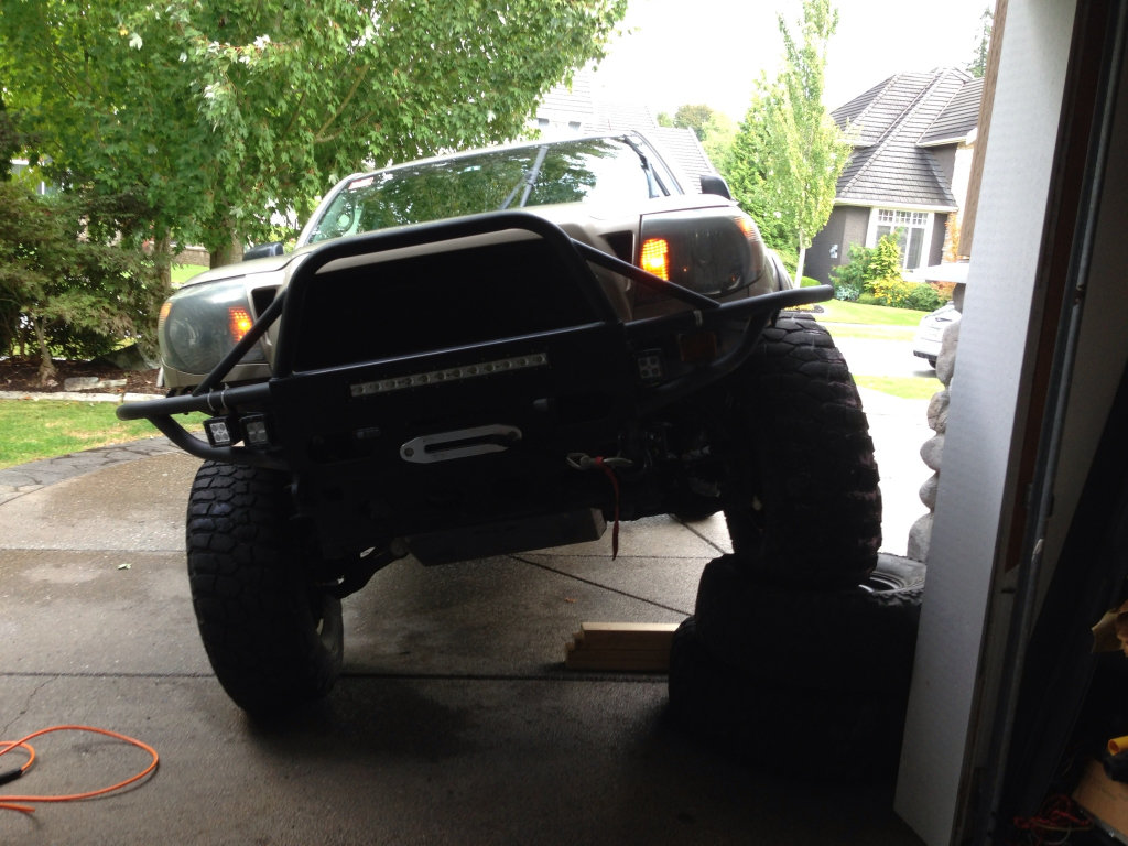

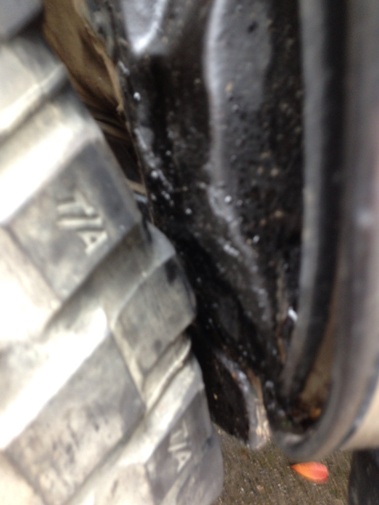

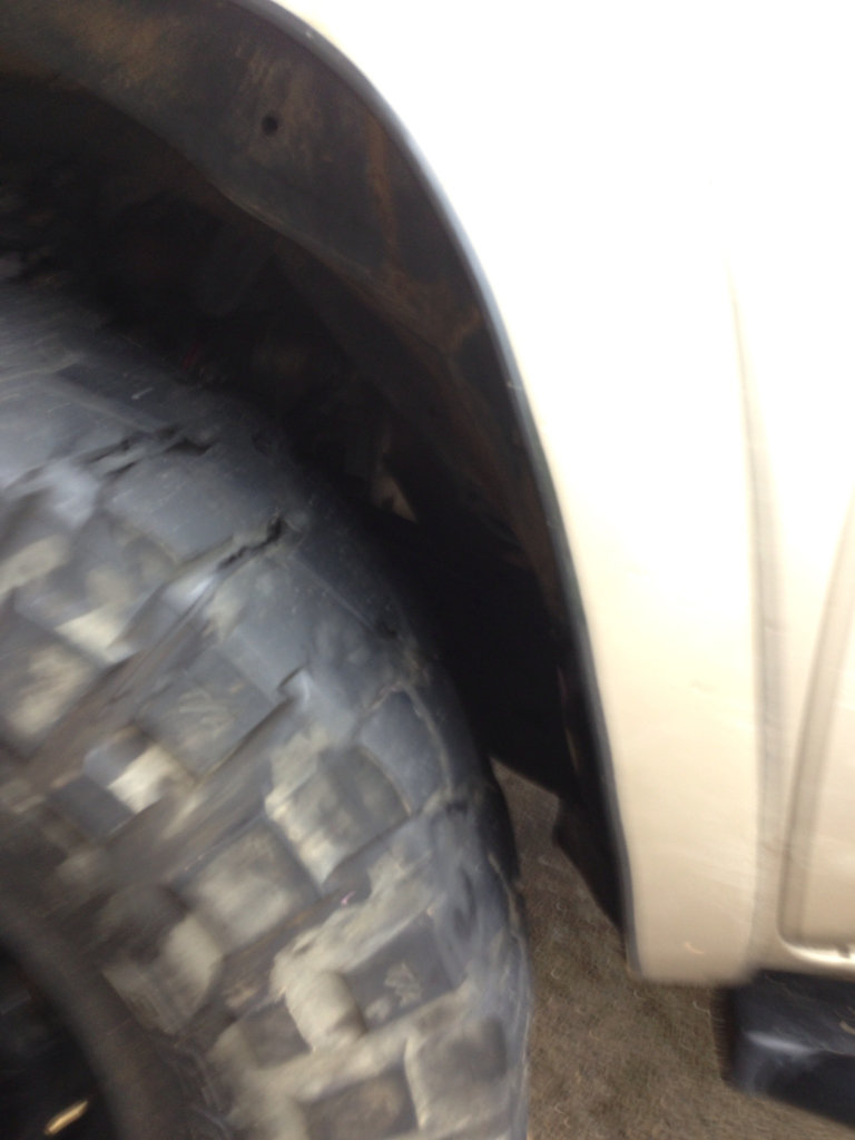

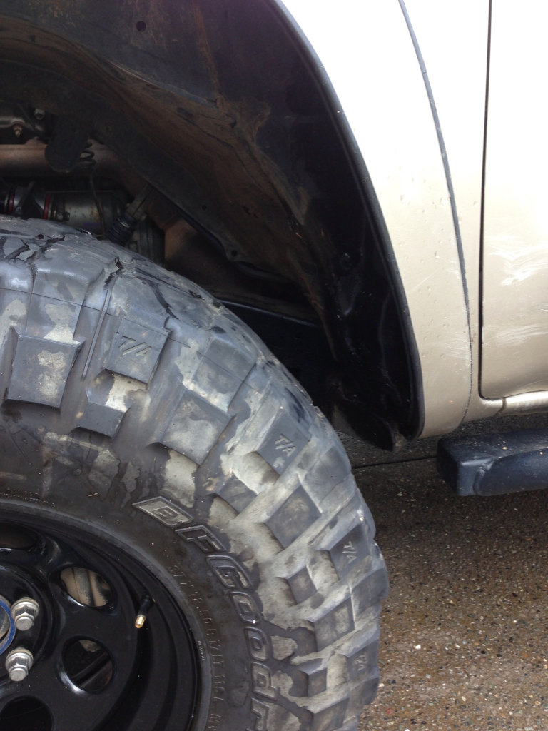

    So they fit, rub pretty bad close to full lock. Need to hack the firewall back.
    This was with 4.25 bs rims and 1.25 spacers still on. The tire clears the UCA and frame. I'd like to run H1 Beadlocks, those are 3.5 bs so will be close.
    I'm also going to try it with spacers off when get time.

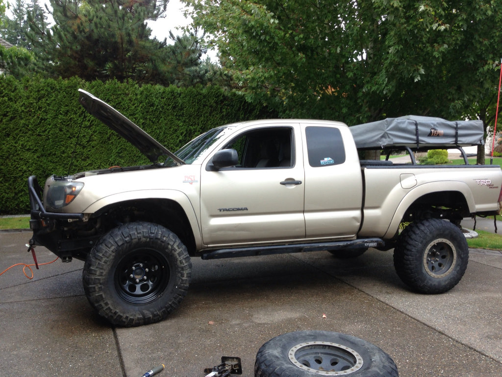

    Tried some flex
    96c5ccfc71c92a5c8a5e78cbceb0a7d8_zps7b44_eb4d88ad3f4654e614b4f7f28433be43cde81924.jpg
    Not bad, close to full compression
